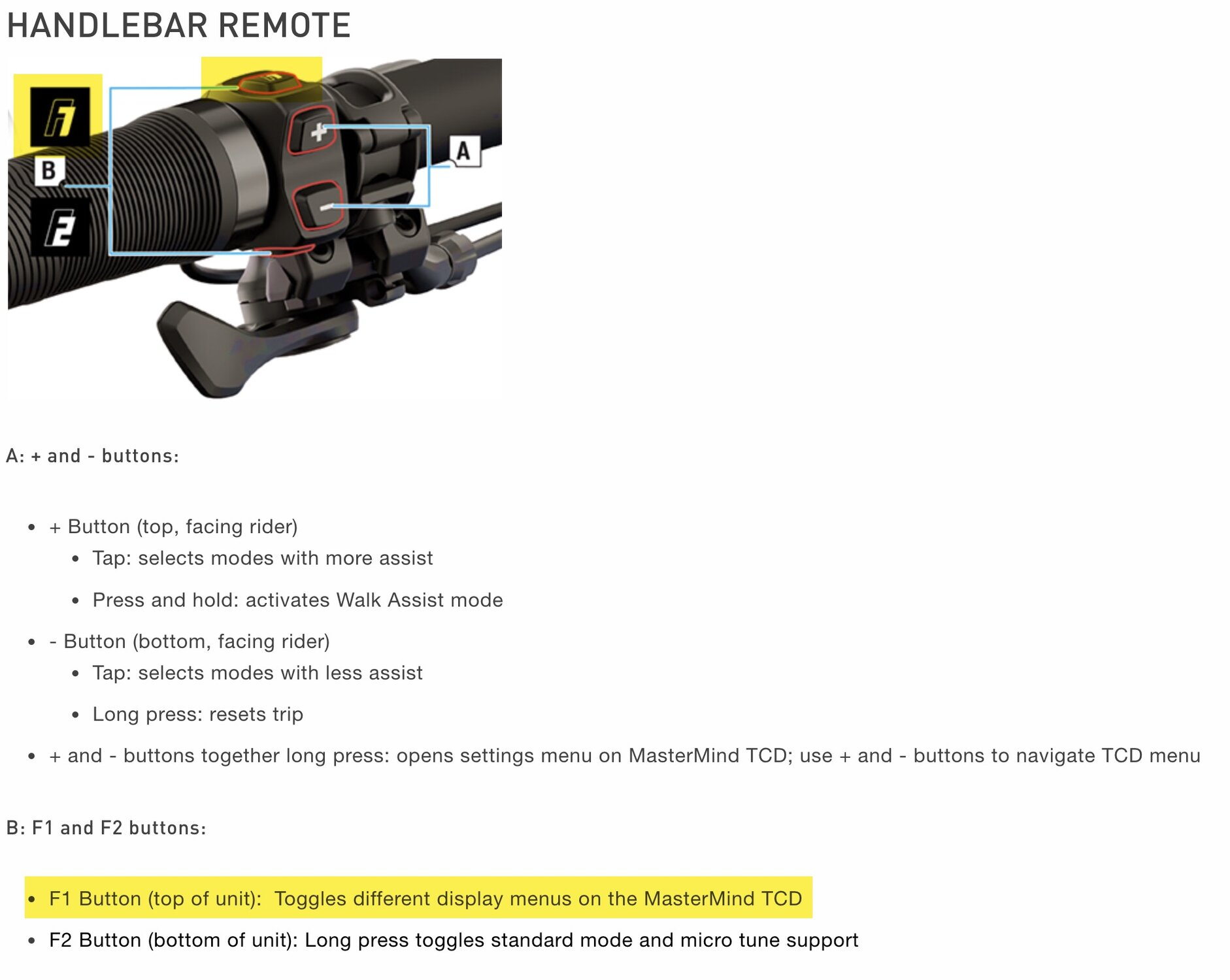

I had this issue yesterday (before I had my firmware updated today), not sure as to why it is happening.
I'm asking if anyone has experienced a similar loss of use of the remote functions and if so, what the resolution was.
All functions work with the exception of highlighted item (F1 Button)

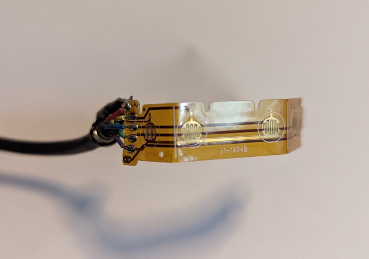

The video does not have much of anything in common with the handlebar switch other than they are both switches. The S216800019 handlebar switch is a simple contact switch with the button bottom making the contact across the traces depending on which set of wires need to be shorted together. They use this part on several models and not all of the models make use of the F1 button. I purchased and broke one apart planning to use the wires on my Creo with my left Di2 shifter as shown in a Creo thread. Someone later posted the p/n of the basic cable commodity for about $10. If is has quit working it is either a software issue, the plug under the MTCU or somehow sweat or chemicals made it past the rubber seal of the top button. The F1 button does not have a function on a Creo but the remote will otherwise work. The picture is the inside of the switch.
Just for reference this is the switch assembly:
