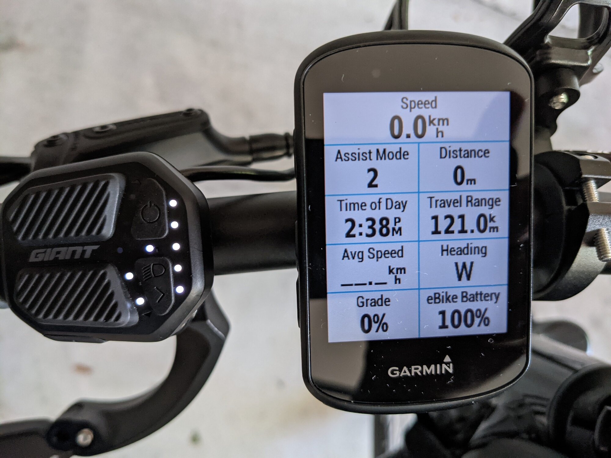

My brother playing with E-Bike Edge Multifield on his 530:
He felt miserable as he had no display on his Trance E+ after he broke the EVO display. Fortunately, the bike has the RideControl ONE remote, so Jacek took the plunge and bought the Edge 530. Now, he has access to the wealth of information that Giant couldn't provide themselves...
