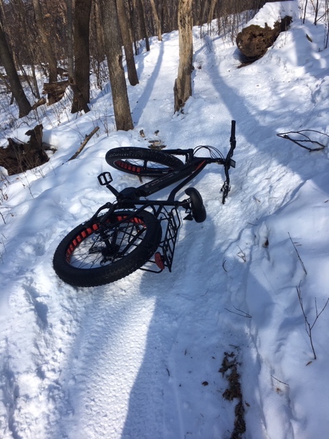

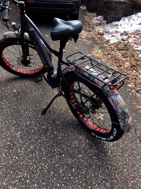

ruffruff
You don't want a single speed fat tire. Riding a single speed fattie in 6" of snow is like riding in wet cement!
I ride all winter but on trails. I'm very happy with my BikTrix Juggernaut. It comes with full fenders.
I'm thinking as a street/salt bike I'd go with a cheaper model and if it's rusted out in 3-4 years get another. You will probably come out even.

View attachment 53259View attachment 53260
Cool fenders!!
