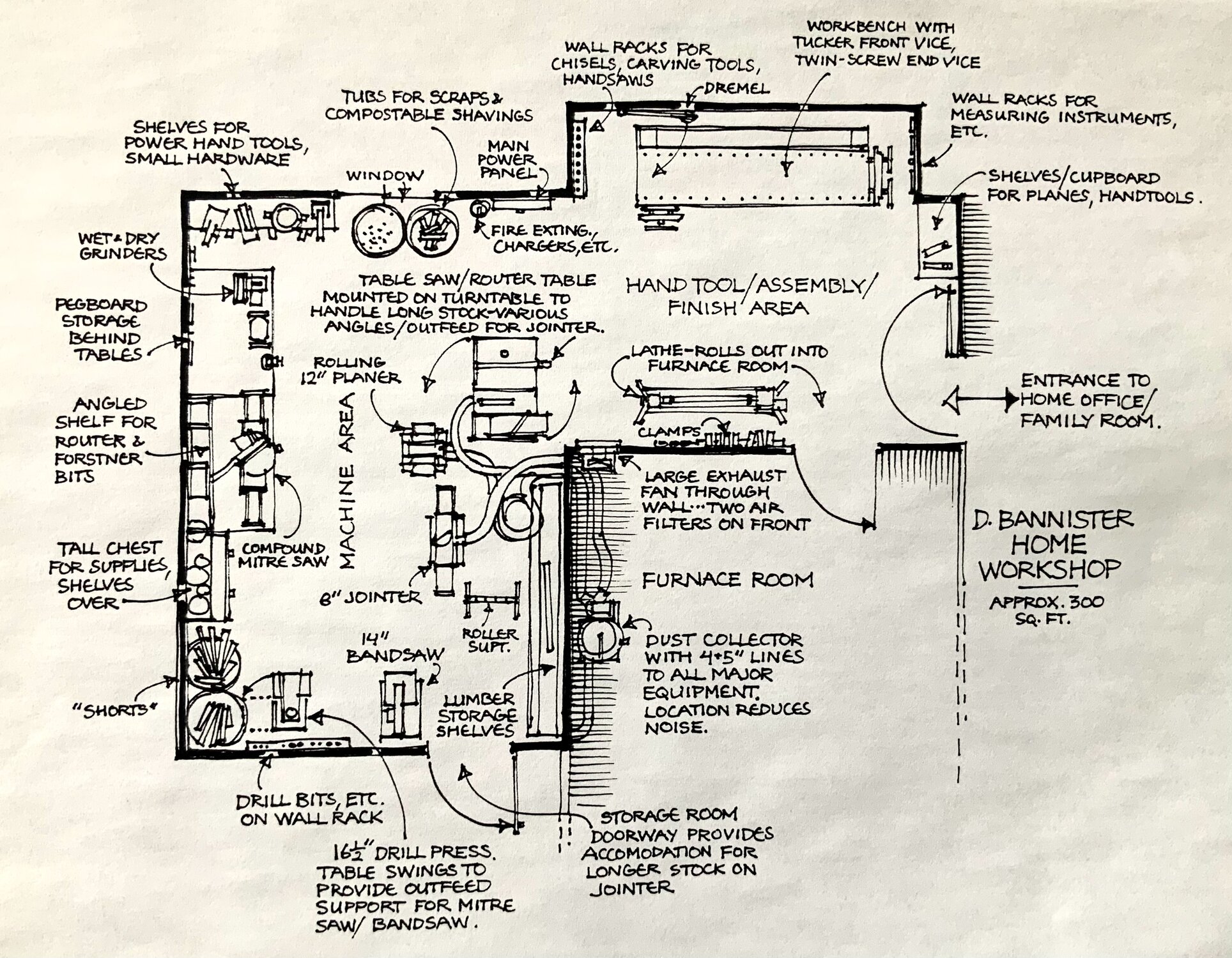

I have a wood workshop set up in my basement (Sketch attached). Although I do have an outside window in it, the dust collection is internal. Each machine is connected to a central dust collection unit (both it and the 8” jointer require 220 volt power supply). An air cleaner fan is also pretty much essential, such as the self-contained units described/shown here. In my case, I bought a barn-style ventilation fan and installed it through a wall, with a double furnace filter on the intake side. Both these units do a great job of controlling dust.
By my workbench, I have an air suction hose that can be attached to tools like sanders, router, biscuit joiner, etc. There is also a floor intake that I can sweep shavings, etc into.
I have a full range of hand power tools, most of which I have had for over 20 years. More recently, I have added many cordless tools, as they are just so much more convenient to take outside as well. Stick with the same brand to save on batteries/chargers.

Nice workshop!
The exhaust fan in the furnace wall... I can't tell where it's supply air is coming from. The door?
Latitude
Nice workshop!
Thanks, yes the air comes through the door or in warmer weather, the window. I wanted to also keep the window free to be able to bring lumber in through it.
Very well done. It seems you spared no expense as necessary.
I'm a fan of creating a negative pressure and exhausting out but I understand why you did what you did and it seems to be working.
