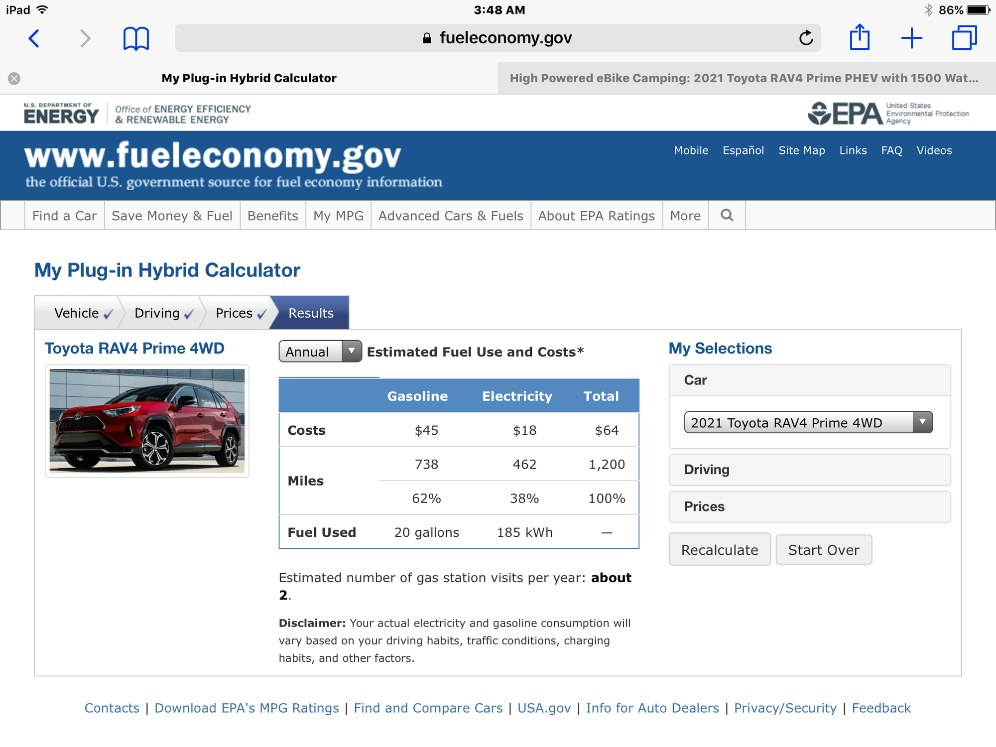

Toyota's RAV4 Prime will also have a lower maintenance cost than conventional crossovers. To begin with, Toyota includes the cost of maintenance and roadside assistance for two years. That sets Toyota apart from automakers like Tesla, Mitsubishi, Nissan, and GM. Although the RAV4 Prime does have a gasoline engine to supplement its electric motors, the engine does not use a costly timing belt that needs changing. Like the Prius, it was designed to have low operating costs. Torque News estimates that the total cost of maintenance for the first four years of ownership of the RAV4 Prime will be lower than every current competitor.
With an expected total range of well over 500 miles, the RAV4 Prime will be one of the longest-range green vehicles for sale in America. And that range will be easily expandable to nearly 1000 miles with a quick five-minute stop at any fuel station in America. When operated as a gasoline hybrid, the Toyota RAV4 Prime is about 35% more fuel-efficient than the leading conventionally-powered crossover its size. The RAV4 Prime is a green vehicle in every possible scenario.

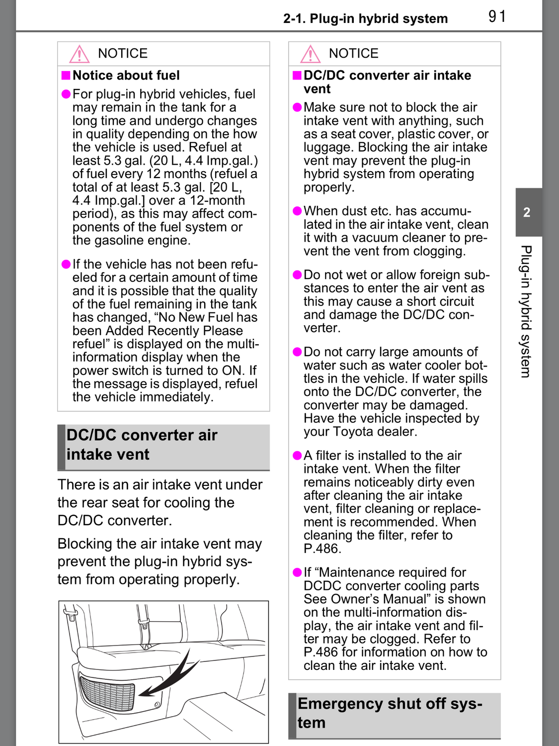

Specific limitations reduce battery charge level and the circumstances under which inverter use is practical and/or possible. Uncertainty level can be high, in certain circumstances. In any event, the battery is still heavily dependent upon the gas engine or a charging station for camping.
  • A folding bike is ideal for this car.
  • Proper tire pressure and efficient tires are just important for EV efficiency as for bikes. Your battery charge level will degrade. In other words, poor tires waste energy.
  • The rear seat cushions might be removed, but seat frame cannot. See page 91, or DC-to-DC air filter image below.
  • A water tank may not be installed inside the car. See page 91.

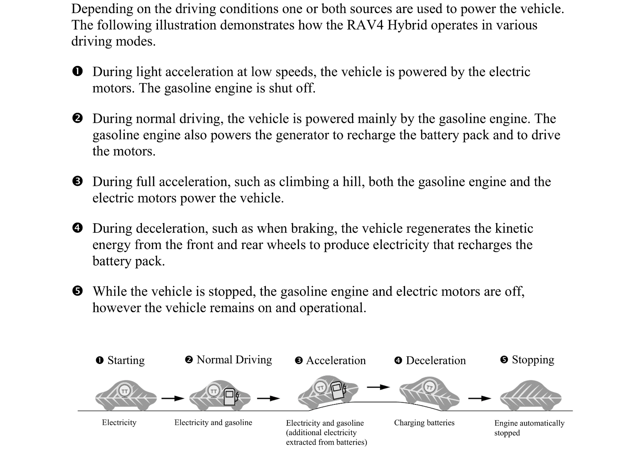

  • The car is intended to be driven in EV mode in the city as much as possible.
    • The car will automatically choose most efficient mode.
    • HIghway driving is more efficient with EV mode off, as EV mode adds unnecessary load.
Page 83
driving range (P.172) is being dis- played on the multi-information dis- play, EV driving (driving using only the electric motor) may be canceled and both gasoline engine and elec- tric motor are used depending on the situation (EV driving will be returned to automatically after EV driving becomes possible again).
EV driving may be canceled auto- matically in the following circum-
stances*1:
●When vehicle speed is more than approximately 84 mph (135 km/h).
●When power is needed temporar- ily, for example when the acceler- ator pedal is depressed firmly or
when accelerating suddenly.*2
●When the temperature of the hybrid system is high.
The vehicle has been left in the sun, driven on a hill, driven at high speeds, etc.
●When the temperature of the hybrid system is low.
●When the heater is switched on when the outside temperature is below about 14°F (-10°C).
●When the windshield defogger switch is pressed. (P.398)
●When the system determines that the gasoline engine needs to be started.
*1:The gasoline engine may also operate in circumstances other than those listed above, depend- ing on conditions.
*2:When driving in AUTO EV/HV mode. Even in EV mode, the gas- oline engine may start, depend- ing on the condition of the hybrid battery (traction battery).
■ If “Engine Started to Protect System EV driving unavailable” is displayed on the multi-infor- mation display
EV driving may be canceled in order
to protect the hybrid system, etc.
In this case, perform driving with the gasoline engine until EV driving will be returned to automatically.
■ Conditions in which the gaso- line engine may not stop
The gasoline engine starts and stops automatically. However, it may not stop automatically in the
following conditions*:
●During gasoline engine warm-up
●During hybrid battery (traction bat- tery) charging
●When the temperature of the hybrid battery (traction battery) is high or low
*: Depending on the circumstances, the gasoline engine may also not stop automatically in situations other than those above.
■ Sounds and vibrations specific to a hybrid vehicle
There may be no engine sound or vibration even though the vehicle is able to move with the “READY” indi- cator is illuminated. For safety, apply the parking brake and make sure to shift the shift lever to P when parked.
The following sounds or vibrations may occur when the hybrid system is operating and are not a malfunc- tion.
●Motor sounds may be heard from the engine compartment.
●Sounds may be heard from the hybrid battery (traction battery) when the hybrid system starts or stops.
●Relay operating sounds such as a snap or soft clank will be emitted from the hybrid battery (traction battery), behind the rear seats, when the hybrid system is started or stopped.
power
Page 84
■ If the vehicle is not used for a long time
●The 12-volt battery may dis- charge. In this event, charge the 12-volt battery. (P.539)
In order to prevent the hybrid bat- tery (traction battery) from becom- ing extremely low in charge, charge the hybrid battery (traction battery) from external power source or start the hybrid system at least once every 2 or 3 months, and turn the power switch off after the gasoline engine has stopped automatically. (If the gasoline engine does not start up even after approximately 10 seconds have passed since the “READY” indicator came on, the power
Page 94.
HV mode while on the free- way and change to EV mode or AUTO EV/HV mode after leaving the freeway. (P.78)

Make sure to check the tire infla- tion pressure frequently. If there is improper tire inflation pres- sure in the tires, the EV driving range will become shorter, and fuel consumption when in HV mode will increase.
Also, as snow tires can cause large amounts of friction, their use on dry roads can lead to increased fuel and electricity consumption.
Luggage
Carrying heavy luggage will lead to poor fuel economy. Avoid car- rying unnecessary luggage. Installing a large roof rack will also cause poor fuel economy.
Since the gasoline engine starts up and cuts out automatically, warming up is not necessary.
Checking tire inflation pressure
Warming up before driv- ing
Air conditioning
 Turn the “A/C” switch off when it is not needed. Doing so can help reduce excessive electricity and fuel consump- tion.
In summer: When the ambient tem- perature is high, use the recircu- lated air mode. Doing so will help to reduce the burden on the air condi- tioning system and reduce electric- ity and fuel consumption as well.
In winter: Avoid excessive and unnecessary use of the heater. Usage of the heated steering wheel (if equipped) (P.407) and seat heaters (P.408) are effective.
Using the Remote Air Condi- tioning System (P.405) while the AC charging cable is connected to the vehicle can reduce electricity consump- tion immediately after starting off by operating air condition- ing mainly using electricity from an external power source.
When setting the charging schedule, setting the charging mode to “Departure” and “Cli- mate Prep” to on can reduce electricity consumption imme- diately after starting off by operating air conditioning
Luggage
Page 96.
Use the air conditioning system appropriately, and also utilize the heated steer- ing wheel (if equipped) and seat heaters
In EV mode, the vehicle is cooled and heated by electrical energy. (Except in extremely cold temperatures of approxi- mately 14°F (-10°C) or less.)
Preventing excessive cooling or heating of the vehicle will reduce power consumption and improve electrical efficiency.
Page 97.
When eco air conditioning mode is used, the air conditioning con- trol is switched automatically to a lower setting. (P.397)
The heated steering wheel (if equipped) and seat heaters are efficient heating device that directly warm the body using less electric power.
When used together with the air conditioning system, a low tem- perature setting can be used to improve electrical and fuel effi- ciency.
■ Check the tire pressure
If the tire pressure is lower than the specified value, it will worsen the electrical and fuel efficiency.
A pressure level 7 psi (50 kPa, 0.5
kgf/cm2 or bar) lower than the spec- ified value will cause a worsening of several percentage points.
■ When driving on highways, use the EV/HV mode selec- tion switch to drive in HV mode
The power consumption will increase significantly if the vehi- cle is driven in EV mode on highways.
■ Do not load unnecessary objects in the vehicle
Driving with objects weighing 220 lb. (100 kg) in the vehicle will worsen the electrical and fuel efficiency by approximately 3%.
Air resistance also greatly affects electrical and fuel effi- ciency. Remove any exterior accessories such as a roof lug- gage carrier when they are not being used.
The running resistance of snow tires is high and they will worsen electrical and fuel efficiency. Replace them with standard tires as soon as they are no lon- ger needed.
■ Know your vehicle’s electri- cal and fuel efficiency
If you know your vehicle’s daily electrical and fuel efficiency, you will understand the benefits of Eco drive.
Use the Power Consump- tion/Fuel Economy, ECO Accel- erator Guidance/“Eco Score” and other data displayed on the multi-information display.
Airbags may prevent seat removal.
img_0974-png.60665
BikeMike
Components Powered by the HV Battery Pack
  • Front Electric Motor
  • Rear Electric Motor
  • Power Cables
  • A/C Compressor
  • Electric Generator
  • Inverter/Converter
  • DC-DC Converter for 12 V Auxiliary Battery
Hybrid Component Locations & Descriptions
Component
12 V Auxiliary Battery 
Avoid ignition in ACC position.
When the power switch is on ACC or on IG, the auxiliary battery supplies power to the electrical equipment and ECUs.
Hybrid Vehicle (HV) Battery Pack
•Supplies electrical power to the
  1. electric generator (MG1),
  2. front electric motor (MG2) and
  3. rear electric motor (MGR) and the
  4. A/C compressor in accordance with the driving conditions of the vehicle.
•Charged by the
  1. electric generator (MG1) and
  2. electric motor (MG2) in accordance with the State Of Charge (SOC) of the HV battery and the driving conditions of the vehicle.
•Has a nominal (approximate) voltage of DC 244.8 V (actual voltage will vary depending on various conditions such as temperature, charge or discharge).
Power Cables
Connects the HV battery to the
  1. Inverter/Converter,
  2. the Inverter/Converter to electric generator (MG1),
  3. front electric motor (MG2) and rear electric motor (MGR), and the
  4. Inverter/Converter to the A/C Compressor.
Inverter/ Converter 
DC-DC Converter  for 12 V Auxiliary Battery
Reduces the HV battery voltage from DC 244.8 V to approximately DC 14 V in order to supply electricity to
  1. body electrical components, as well as
  2. to recharge the auxiliary battery.
Motor Generator ECU
Controls the boost converter and inverter in accordance with signals received from the
  1. hybrid vehicle control ECU,
  2. operating electric generator (MG1),
  3. front electric motor (MG2) or
  4. rear electric motor (MGR) as either a generator or motor.
Boost Converter
Boosts the voltage of the HV battery from DC 244.8 V to a maximum of DC 650 V and vice versa (reduces from DC 650 V to DC 244.8 V).
Inverter
Converts high-voltage DC (HV battery) into AC
  1. (electric generator (MG1),
  3. rear electric motor (MGR))
  4. and vice versa (converts AC into DC).
Gasoline Engine 
Is a high-expansion ratio Atkinson cycle engine which is compatible with the hybrid system and which generates drive force for driving and energy for electricity generation.
Front Electric Motor
•Driven by electrical power from the
  1. electric generator (MG1) and/or the
  2. HV battery, and
  3. generates motive force for the front wheels.
•Generates electricity to recharge the HV battery (regenerative braking) during braking or when the accelerator pedal is not depressed.
Rear Electric Motor
  2. HV battery, it
  3. generates motive force for the rear wheels.
Electric Generator
•Driven by the engine and generates high-voltage electricity in order to operate the
  1. front electric motor (MG2) and
  2. rear electric motor (MGR) and/or to
  3. charge the HV battery. Also, the
  4. electric generator (MG1) functions as a starter to start the engine.
•Operated to allow the gear ratio of the power split planetary gear unit to optimally suit the driving conditions of the vehicle.
A/C Compressor (with inverter)
  1. Driven at a speed calculated by the air conditioning amplifier assembly,
  2. receives drive requests from the hybrid vehicle control ECU and
  3. takes in, compresses and discharges refrigerant.
Fuel Tank and Fuel Line
The fuel tank provides gasoline via a fuel line to the engine. The fuel line is routed along the left side under the floor pan.
*Numbers in the component column apply to the illustrations on the following page. 6

BikeMike
The RAV4 Prime XSE starts at $42,545, plus an extra $3,765 if you want the Premium package. Keep in mind the Prime will be eligible for a $7,500 federal tax credit and any applicable state credits, which should lighten some of the load.
We may enough information to begin reasoning about the behavior of the RAV4 Prime system. The minimal information to reason about behavior is listed below. The estimated cost for the XSE trim model and Premium package is estimated over $46,000.
  1. Ambient temperature -
    1. climate control, electrical heating and cooling will consume HV battery energy
    2. Will buy heated seats to reduce need to use battery energy to heat interior air
  2. Effective range -
    1. combined gas and battery range is approximately
      1. 600 miles
    2. +2 Scenario, 80% battery charge
      1. ? Miles
  3. Charge time -
    1. 2.5 hours with 6.6kW charger
    2. Will buy premium package to upgrade from 3.3kW charger
  4. Highway mpg -
    1. 36
    2. Will not extend car cargo capacity by adding roof rack or pulling trailer to optimize mpg
    3. Drive mode - battery recharge, not combined HV/EV
  5. Highway Battery consumption -
    94 kW-hrs/100 miles
    1. Need to differentiate by driving modes
      1. Battery Charge
      2. HV/EV
  6. Battery Capacity -
    1. 18kWh
  7. Tank Size - 14.5 gallons
  8. Engine horsepower
    1. Total - 302
    2. 2.5L 176-hp
    3. 179-hp (front)
    4. 53-hp (rear) electric motor
I find a scale from -3 to +3 is a convenient for reasoning. The goal is to arrive with a battery charge of a +2 or +3 scenario.
  • -3 - 5% gas and battery
  • -2
  • -1
  • 0 - 50% gas and battery
  • +1 - 66% gas and battery
  • +2 - 80% gas and battery
  • +3 - 95% gas and battery
Gas refill time is insignificant. The main concern is arriving at a camp site with 80% full tank.
My understanding is the car cannot be occupied while being recharged. Waiting outside the car for 2.5 hours is unacceptable in extreme temperatures. Therefore, I probably want to recharge the battery whenever it reaches 80%, which will take about 30 minutes. Therefore, the effective highway range is highly dependent upon the MPG in battery charge driving mode.
The Mitsubishi Outlander has a 30 minute fast charge, but I believe the battery is 11 or 12kWh. 110 VAC power supply mode cannot be controlled, as the gas engine automatically starts when HV charge level is low.
For example, how much longer would the 1,200 mile, 18 hour trip from Denver to Portland, OR actually take? Would sleeping in the car make for fastest time? Or, would recharging at a hotel with a plugin station be faster?
The same calculation for Outlander is closer to what I hoped for, given ten stops to recharge or every two hours. I am not sure how accurate the software simulation is. According to this estimate, i arrive with roughly the same amount of kWh of battery. I spend much less time waiting for the an Outlander to charge, due to fast charging. Also, i can always ensure a +2 or +3 full battery with fast charging.
In my area, Outlander PHEVs are discounted by about 15%.
