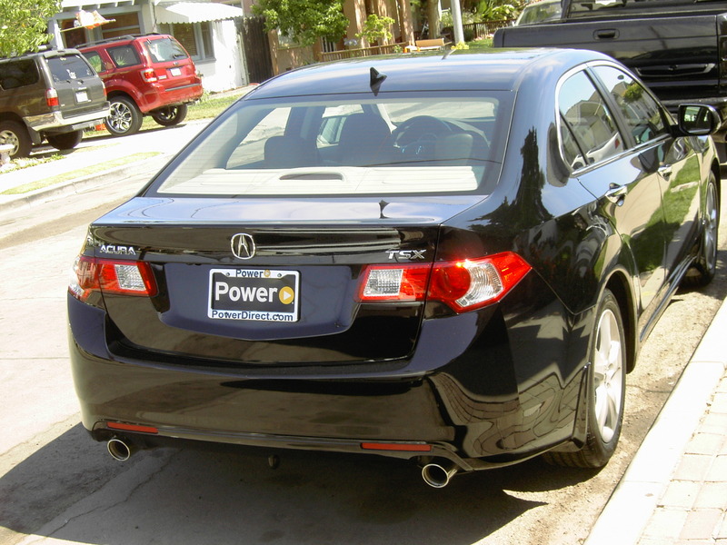

Hi Everyone,
Well I tried the method of putting the ebike into the trunk, and while it worked for one trip, it definitely isn't practical... having said that, I'm in the market for a hitch. Here is my dilemma:
Trunk-mount racks are much cheaper; however, a 55lb bike seems like an awful lot to put onto the trunk.
Hitch-mount racks seem much more solid, but in another thread, George brought up the issue that my car has certain weight limits for the hitch. I have an Acura TSX (pictured below).
Can anyone school me on the different types of hitches that are possible to install on my car, and what weight capacity they will have?
thank you

Hi Everyone,
thank youView attachment 4189

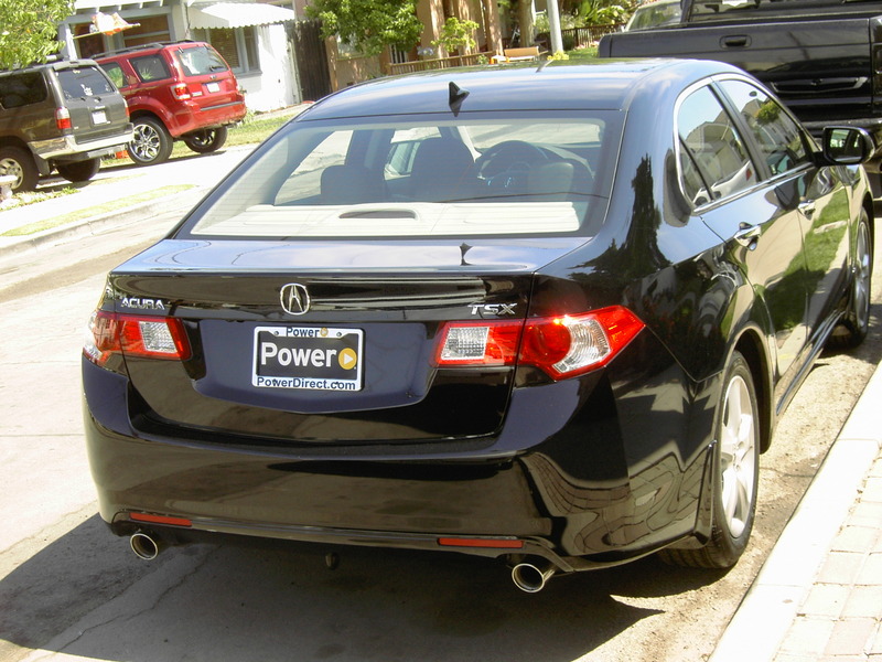

http://www.etrailer.com/vm/Acura/TSX/hitch

Thanks Grench. I found this from my Acura owner's manual:
Total Trailer Weight:
The maximum allowable weight of the
trailer and everything in or on it
must not exceed 1,000 lbs (450 kg).
Tongue Load:
The weight that the tongue of a fully-loaded trailer
puts on the hitch should be approximately 10% of the total
trailer weight.
From this, my understanding is that I am limited to 100lbs total weight on the tongue of my hitch. That would seem to greatly limit my options for a hitch-mounted rack, no?
