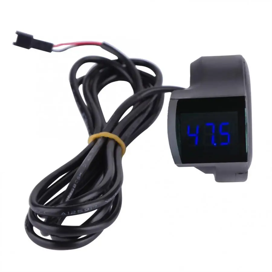

AguassissiM
This is what I have added to one of my rides to get a clear picture of the battery status:
Digital Multimeter DC 6.5-100V 20A Voltage Amperage Power Energy Meter DC Volt Amp Tester Gauge Monitor LCD Digital Display with Blue Backlight Measuring Volts Current with Built-in Shunt

toddbailey
hopefully the 2.2 digital volt meter will be accurate enough so i can use it as a monitoring device so once the batteries hit a 11.0 volt output (or in my case 44.0) I know it's time to recharge. yes I know 10(40 volts) is the absolute minimum but why push your luck.
