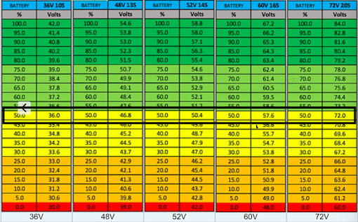

Thank you, Bruce. I checked my battery today after my 10 mile ride (when I got home from a less hilly ride than the other day). The voltmeter read 48.9 volts. However, I do not know what percentage that is (for long term storage, e.g.). But the power on the flat was still okay. Maybe someone could tell me what percentage that is, or what voltage I should store the 48v battery at. Thanks.

Bruce Arnold
I downloaded this chart so I could refer to it when needed. I don't know how many times I've checked it to refresh my memory. I bet you'll find it useful too.
