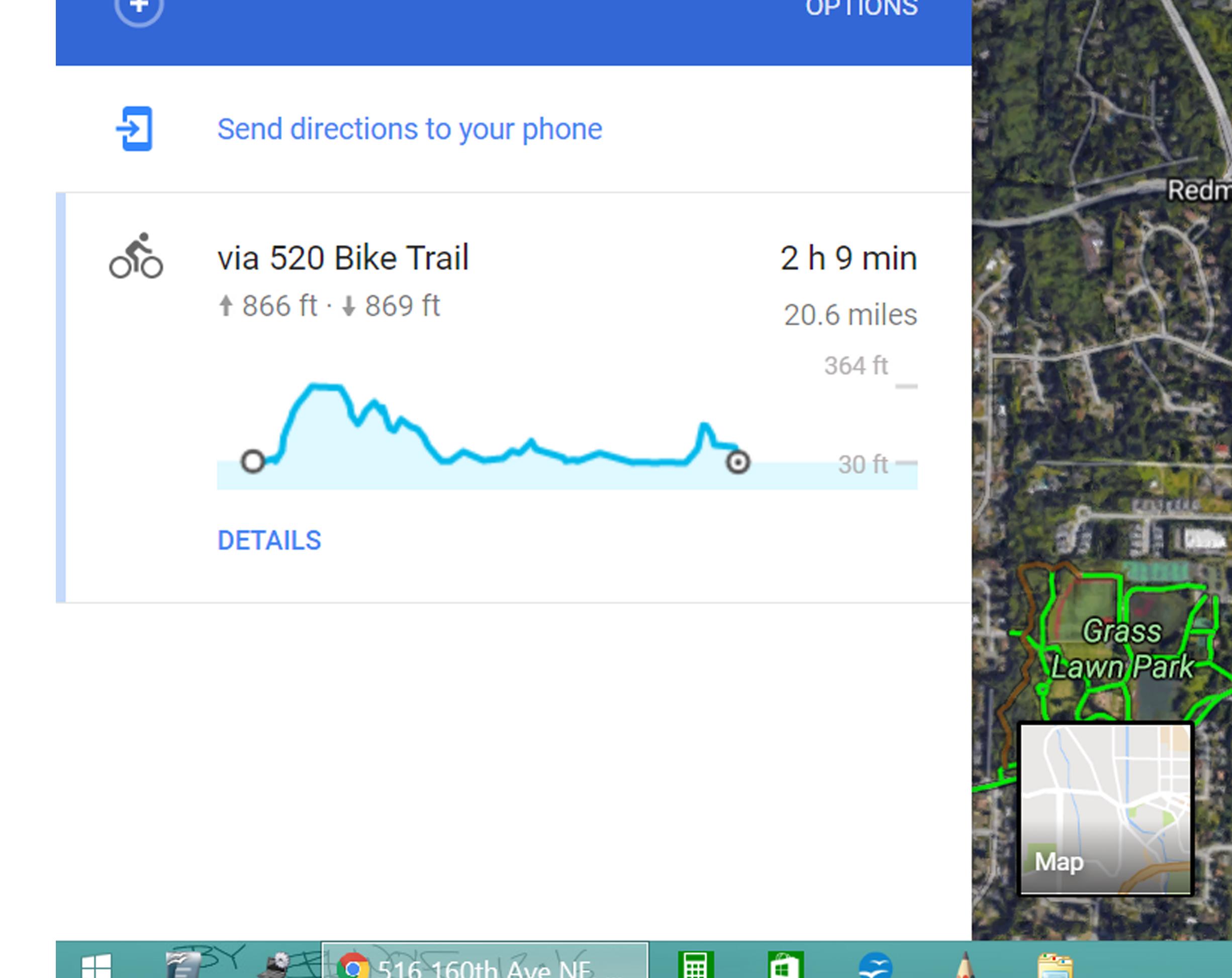

Radwagon- Flat, full throttle no pedal, about 20 miles.
With hills (see pic)- Assist level 2 max 30 miles. Assist level 3 max 19 miles.
I have a 20 mile commute. Last summer I rode with assist 2 for about 6 months and had a full bar left.
Now I use assist 3 and have to change to my spare battery at about 18 miles depending on head wind and atmospheric temperature.
It seems to lose a mile or two depending on temp.
Assist level 3 makes some of the hills manageable.

How long does it typically take you to ride that 20 miles? I'm assuming that slope is from Google Maps and that it assumes a slower average speed that you achieve on the Wagon. Or is that assumption wrong? I suspect you've told us that info in a different thread, but I've forgotten. Sorry.
Barkme Wolf
Today I did the trip in 1:30- Not counting my mid-ride coffee break and last battery switch (at about 18 miles in assist 3). No wind or rain today so it was optimal. I made sure to stay on track today to get you a good average. Most of the time I stop to pet dogs, watch eagles, pick up chunks of metal from the roadway, berate dangerous drivers and anything else that catches my attention.
I also use my throttle more than most people claim to. If I need just a bit of go, in a case where I might turn the crank once or twice just to keep up speed or maintain balance, I will tap the throttle. I also speed into turns which is often more effective to do with the throttle rather than cranking it out. Because of this is is also difficult to measure my power usage. I would likely get a mile or two more with my throttle off. The headlight also seems to drain a bit. I tend to have as many lights on as possible, day or night.
FWIW, I'm in the same area, and my real world average speed is typically between 14 and 15 mph.
Thanks. So your trip was about 1.45 times faster than the Google Maps Bike directions (average speed of around 13.73 mph vs. Google Maps directions, which assume average speed of 9.5 mph).
Just trying to understand how an electric bike might affect travel times vis a vis the the projected bike travel times in the Google Maps directions (which tend to assume an average speed under 10 mph).
For example, a transit trip from Seattle's Beacon Hill Station to Neumos in the Capitol Hill neighborhood is estimated at 23 minutes during the middle of the afternoon. Google bike directions estimate 19 minutes (average speed of 8.25 mph). So if we assume that the electric bike trip would be 1.45 times faster than the Google directions, then we're looking at an estimated travel time of 13 minutes, which is the same travel time estimate as making this trip in a car.
Beacon Hill Station to the Hotel Albatross on Market Street in Ballard is 53 minutes in the middle of the day. Biking directions also estimate 53 minutes. So if we assume that electric bike would be 1.45 times faster than Google bike estimate, we get 36.6 minutes. Car estimate is 24 minutes. So car is definitely the fastest option, at least this time of day, but the electric bike cuts bike travel time down to the point where it's much more competitive with the car and significantly faster than taking transit. Moreover, I suspect the travel time for the bike isn't affected by traffic in the same way that the car trip is. So at rush hour, the car and electric bike times may well be about the same. I know from experience that it's usually going to take more than 30 minutes to get from Beacon Hill to Ballard once the traffic thickens up.
Anyway, mostly just thinking out loud here. I suspect you folks have already thought most of this stuff through.
