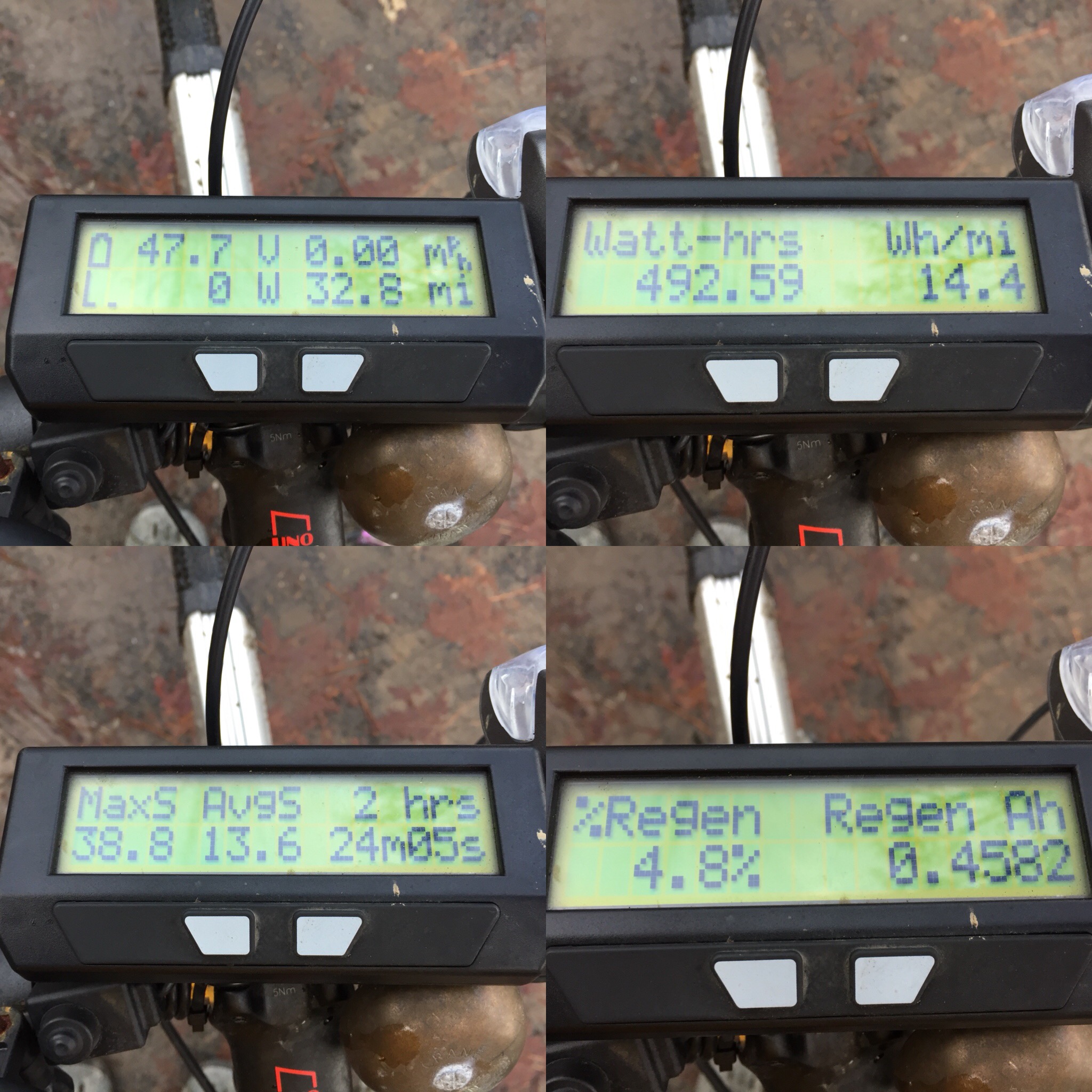

Here is an example of a ride I took recently with 3000+ elevation gain/loss
I don’t use regen to aid in mileage, although it does add an incremental amount. What it is good for is as a drag brake I have a front hub motor and I use it all the time on downhills, coming to a stop and whenever I require light braking.
There is no way from my experience with regen on a bicycle that it will perform as advertised on that bike or any other like it. Unless of course as pointed out you are willing to pedal around all day with it on and go nowhere fast negating the whole reason for riding an e bike.
