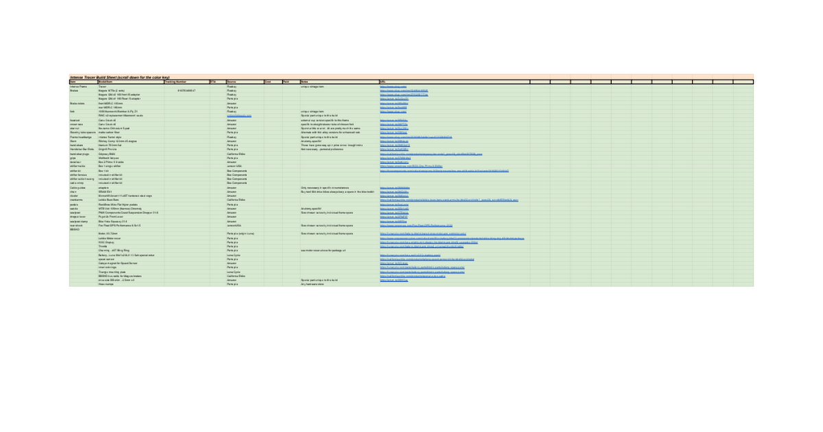

Project management is a part of that series I am working on. Here is the build sheet for the project bike in the series. Since that bike is pretty much a generic e-mtb, the parts list is very close to universal. Given what you said here, maybe I'll add a column for the url to each part I chose. Its something I did in my early build sheets. Not something I need anymore but I can see the first time builder getting some benefit from it.
