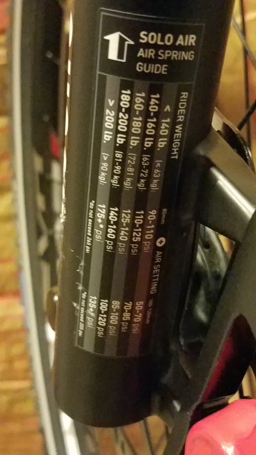

Most air suspensions have a psi range. The range is determined by the travel the fork is capable of. Then you can adjust within that range for your load and terrain. My RockShox has a discrete label on the trailing side of one fork leg.
Bikes in general can be frustrating with the lack of instructions and documentation.
I don't own the same bike. Here's the label on my fork:

Thanks J.R. ! That gets me pointed in the right direction!
