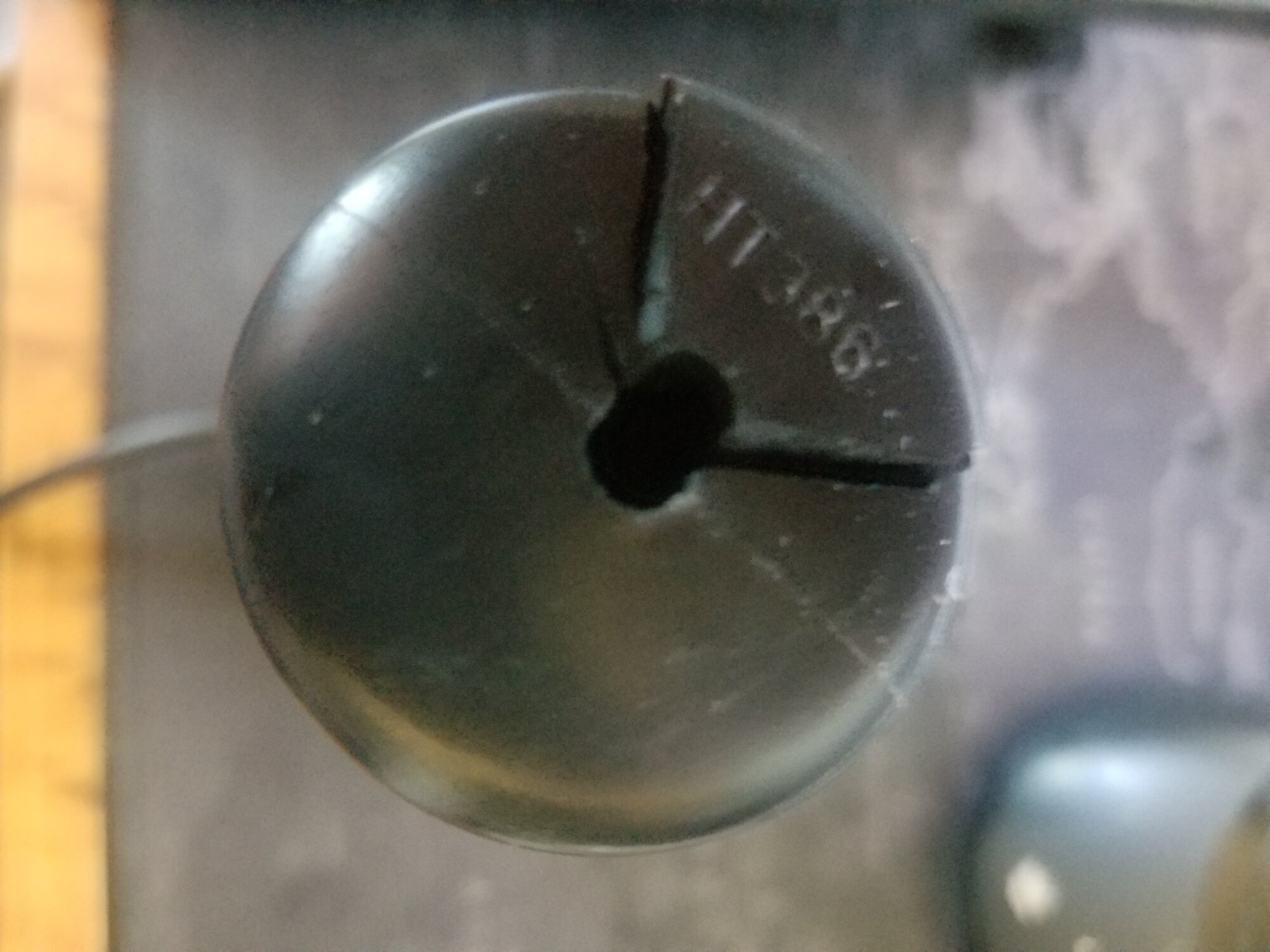

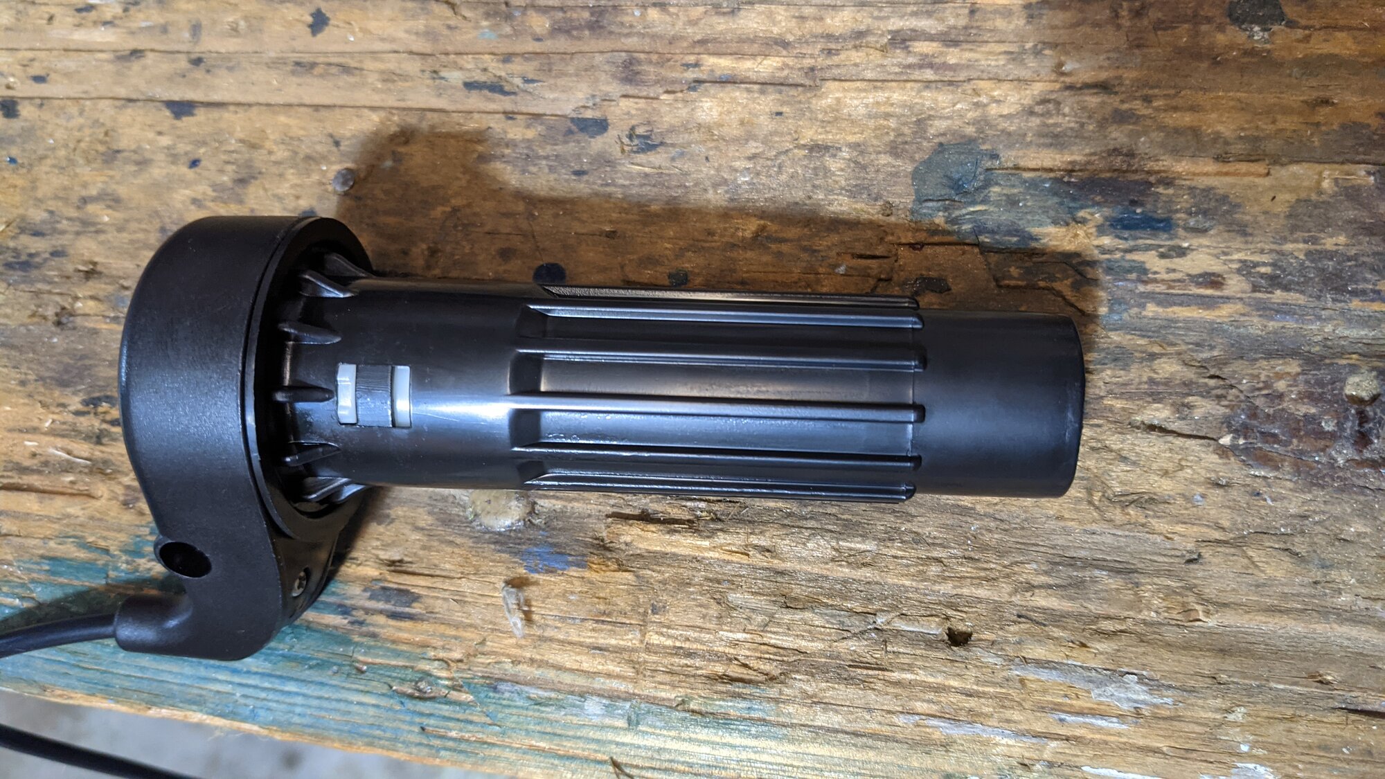

But when I cut the grip off the throttle I purchased, it looked like this:
The very end of this is even slightly bigger than 28.5 mm, so it's not like I could push the throttle grip over that section and then just get stuck at the fluted parts.
The way this is designed, you can't even dremel off the fins to make a 28.5 mm length all the way down, unless you destroy the retainer clips that attach the hall sensor internals to the throttle tube. I tried this anyway and it was a pain to do as these are pretty fragile. So I basically junked a brand new throttle trying to figure this out.
What's more, this particular throttle is just over 4" long, so too short for motocross grips. There are longer ebike-specific throttles available around this price, but I'm probably not going to eat more $ just trying them all. Seems safer to assume that all of these cheap twist throttles are designed as above and won't accept a standard motocross grip. Regular bike grips would never work in the first place because of the diameter of the throttle tube.
Genuinely don't understand why they need to be made this way. If you're after a full-grip twist throttle for your ebike that will accept standard motocross grips, you're stuck with the Magura or the Domino, which are 3-4x more expensive than the ones we see all the time. You can also get a traditional, cable-actuated throttle and run it into an adapter, like this https://www.aliexpress.com/item/32954909008.html?spm=a2g0s.8937460.0.0.fca92e0e8hLciI
But nothing out there that I have found is plug & play at the $20-ish price point unless you like the pretty crappy grips that come with them. If you want simple, replaceable motocross grips on your ebike it's a bit more work and expense.

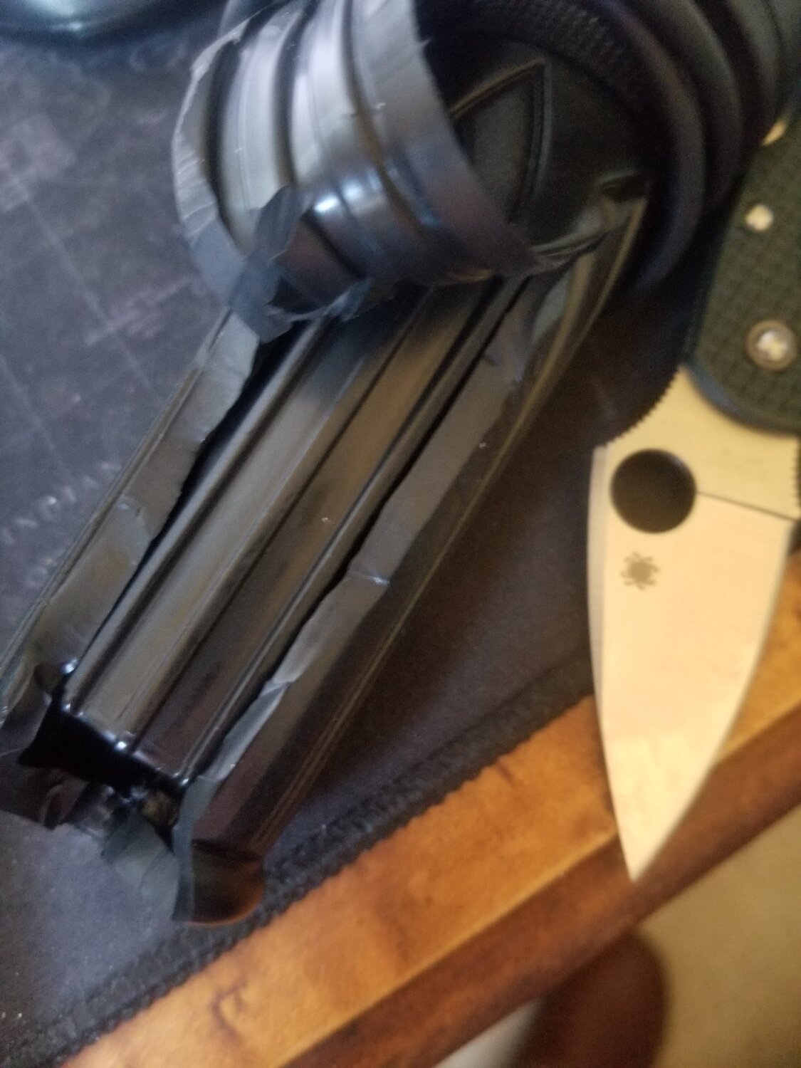

I bought two lefties to cut the plastic off one, and see what's under there.
So 'chop chop' lets answer this question right now.
Under that plastic grip, there's a full length (plastic) tube w/ plastic end bearing, so start the cut you needed a safe spot where the tube will not be damaged by your cutting tool. Here's what I did 20220619_120806[1].jpg.
I'm using a Spderco 'Dragonfly' with a ZDP 189 blade (I've sharpened to perfection and keep stropped). A scalpel, it goes through the rubber like butter. The rubber peels back revealing the ridged inner plastic tube 20220619_122233[1].jpg. Quite sturdy.
There's some HD glue on one side20220619_124523[1].jpg but not the other 20220619_124531[1].jpg.
A heat gun might be a bad idea on plastic. I used a pair of vice grips to grip and peel the rubber off, then trimmed most of it fused between the ridges (I want some of that glue. It's awesome! It'd keep my exes mouth shut. I must talk to these folks).

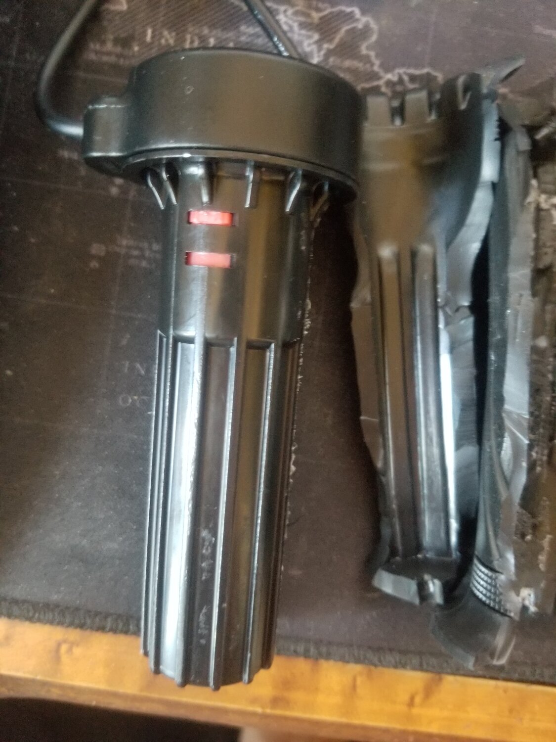

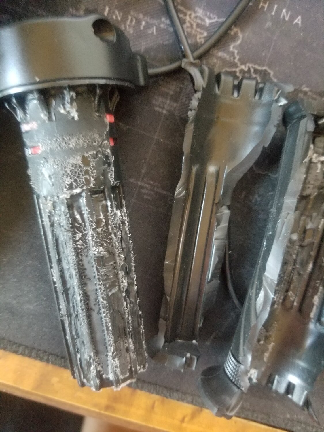

Cover removed, I think we're on to something!
To no avail, I researched this topic everywhere, concluding 'only destructive testing will provide an answer'.
Yes, we can easily remove the hard rubber grip without ruining the throttle.
My micrometer says roughly 28mm (1-1/10" w/ crud) OD, thus any 1-1/8" (standard throttle side) grips should fit perfectly (Har, har, har).
Domino makes 22.1mm ID throttle and 25.4mm grips. Maybe it's time to modify the grip?
Or, you see those red tabs in the last two photos? Those depress inward and - I believe - release the entire tube housing, but if that's what you wanted why not start with a half grip twist type and a carbon tube? Well yeah. That bearing, and ...
... My impressions: Maintain the bearing on the end 'cuz any wobble will cause (read 'failure') trouble.
This thing's pretty sturdy. If the pots are the quality of the Wuxing's, I put 1500miles on the one - still working fine - I'm removing.
Cost about $1.00/ 100miles use (NO, I don't work for Consumer Reports) and still great.
The wiring's a couple steps above OEM stuff.
I can't see why a quality grip can't be modded to fit.
To me, it's worth grinding down the stop-ring on a Valued G-whatever, a little filing work. They're virtually the same on even the cheapest types.
