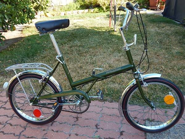

PedalUma
I like the bikeshare idea but it has some downsides. They would both need to join so the fees would double. A bike may not always be where and when you need it. For me I would get an inexpensive folder from Craigslist and pop a discrete small motor in the bottom bracket and have a light removable battery on the seat tube. Use new brake pads with twice the surface area. The folders as mentioned adjust for different sizes of riders. Fold the bike and have it locked in a bag. There are bike lockers and bike rooms on UCSF that require registration, log in and sticker tags. Sell one road bike to make room.
Here is one on the Bay Area Craigslist I spotted as an example. Oh, motor and battery add ten pounds.

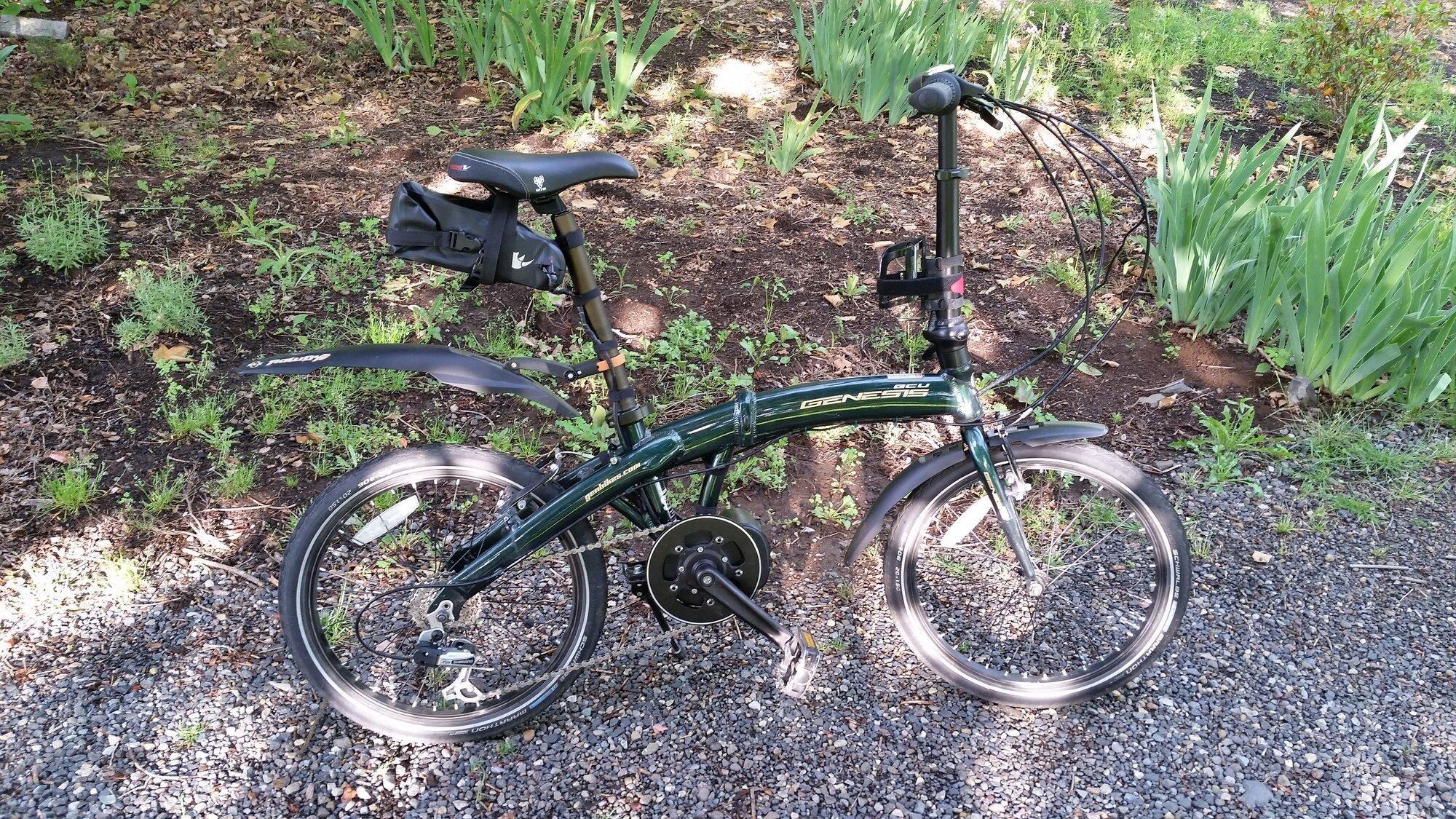

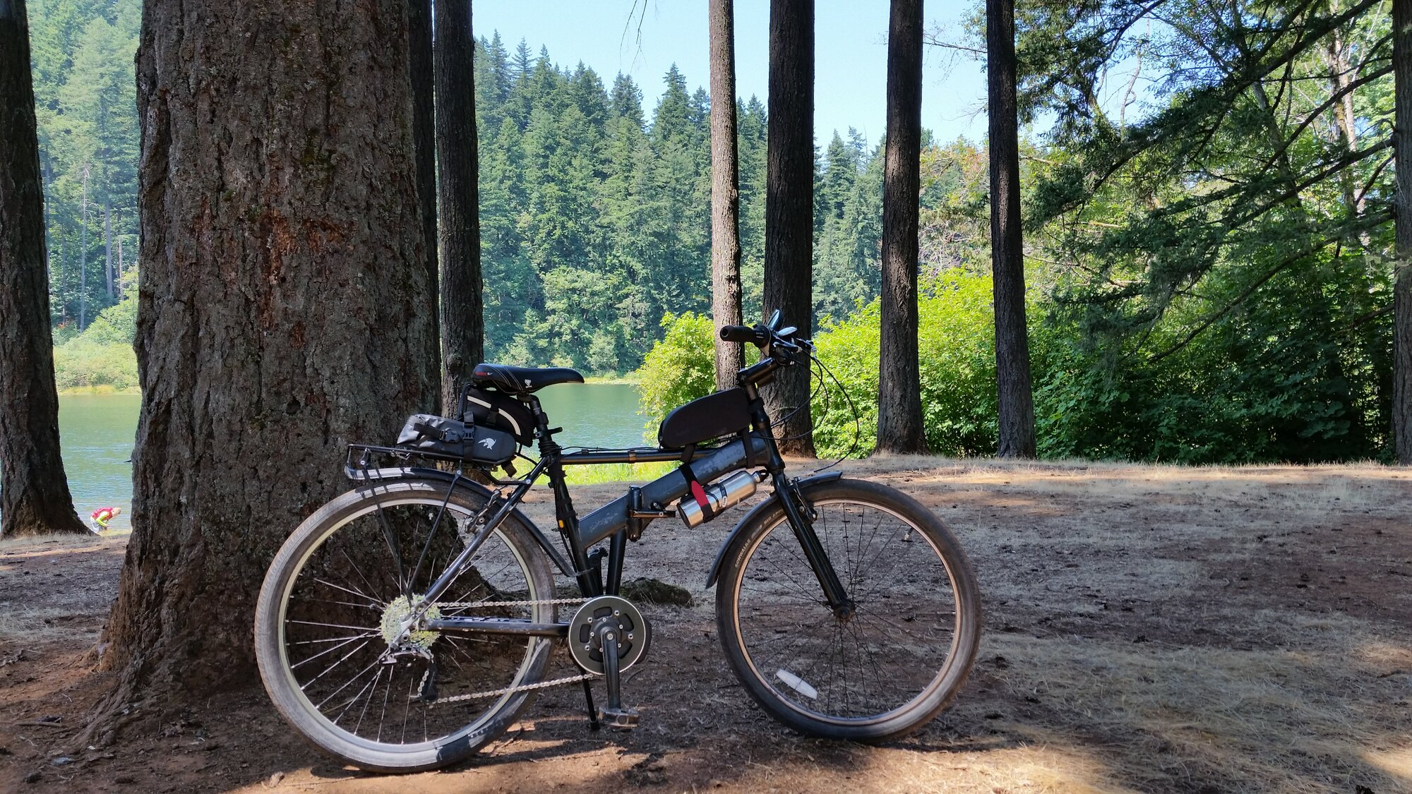

I have been floating my 36v 500w TSDZ2 mid drive on different bikes lately, just because.
Here it is on a $200 Walmart folding bike that I've had for years sitting on a shelf in a shed.
To all the department store bike haters I can say this has been a very solid and functional bike that I've ridden many hundreds of miles, mostly after work, often in the dark on a rural path accompanied by coyotes and deer. And rode it around Crater Lake - had to carry it across some snow to continue the ride.
20" wheels work well with the Tongsheng with the two lowest levels of assist providing very good assist and the two highest levels will climb just about anything. One recent ride on a steep paved path it took some effort to keep the front wheel on the ground, otherwise I was doing wheelies whenever I pedaled hard.
The 10ah battery weighs 5 pounds including the seat post bag and I've taken it as far as ~50 miles with 3500 ft elevation gain on a single charge with 40% resting residual charge (35v).
Bike prior to conversion ~27# with the motor/battery a touch over 40 pounds on a hanging scale.
A couple days ago I removed it from the Walmart folder and put it on a Dahon Jack, it might stay there for a while.
