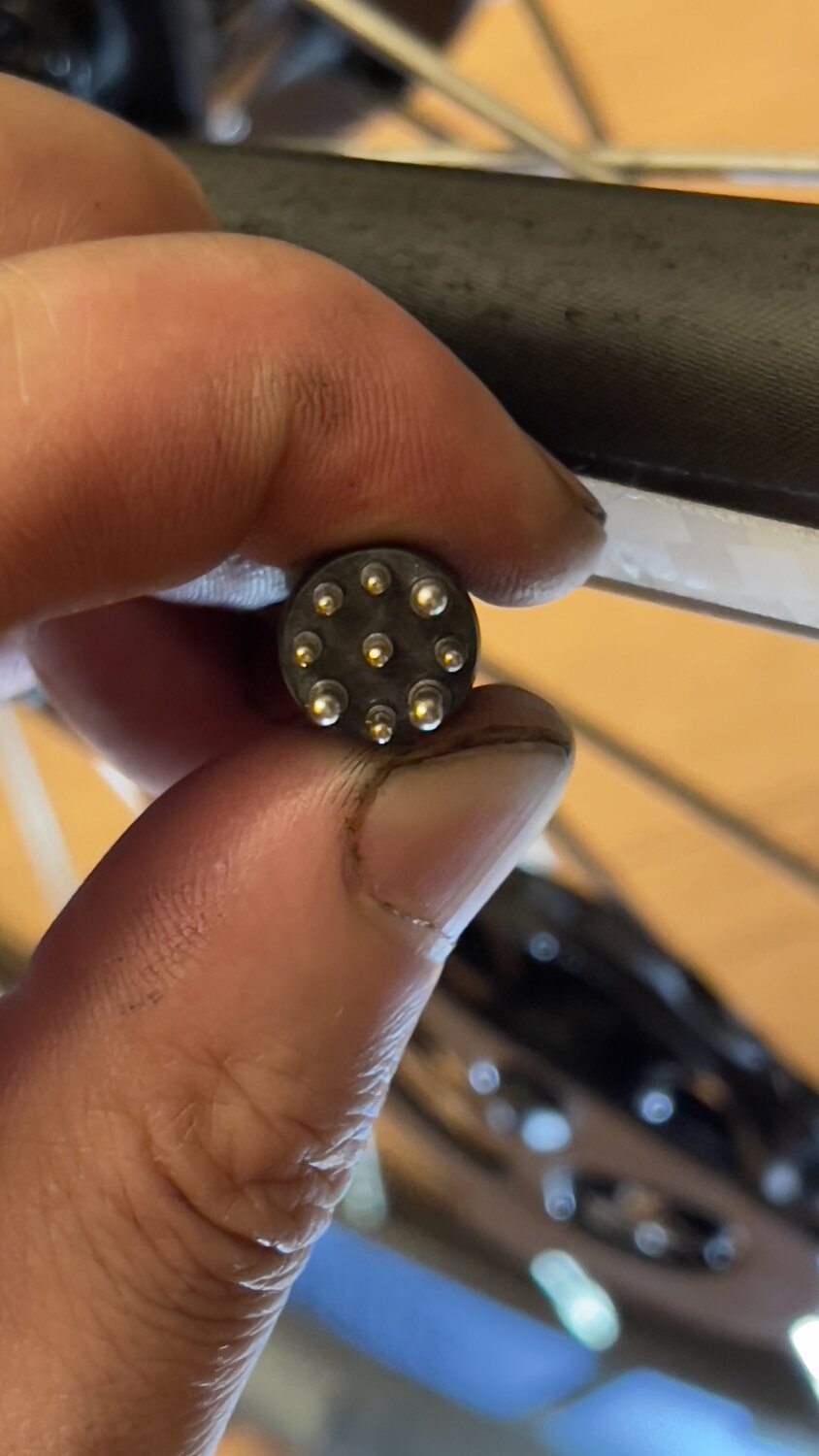

I was replacing my rear brake pads and disconnect the battery connector, as show in picture 1, and later connect it. But now when it intermittently powers off and even when it is on, there is no more display of the current speed, shown in picture 2.
Is it due to a improper connection of the connector or what is other cause?

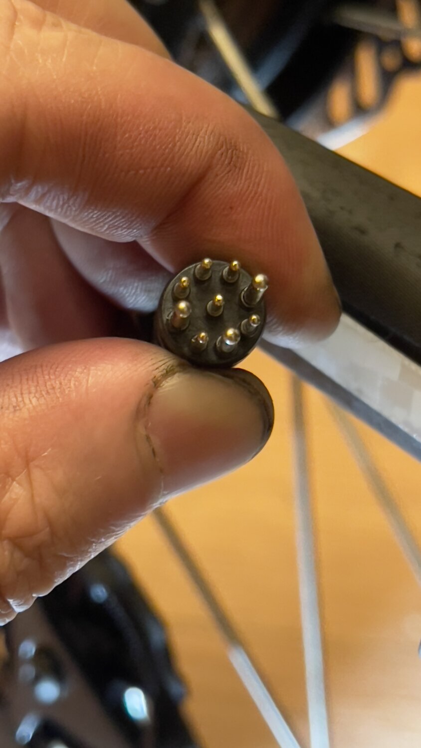

It has to be the connection. Take it off and check for broken or bent pins. If OK, reconnect and make sure it is well seated.
kirksea
Sorry...don't see anything obvious that's wrong
At the very start of the reconnection after the replacement of the pads, I did had a hard time connecting it, and twisted one of the pins and misplaced it. But I was able to correct that, and then there came this power off problem. Not sure if I damaged something.

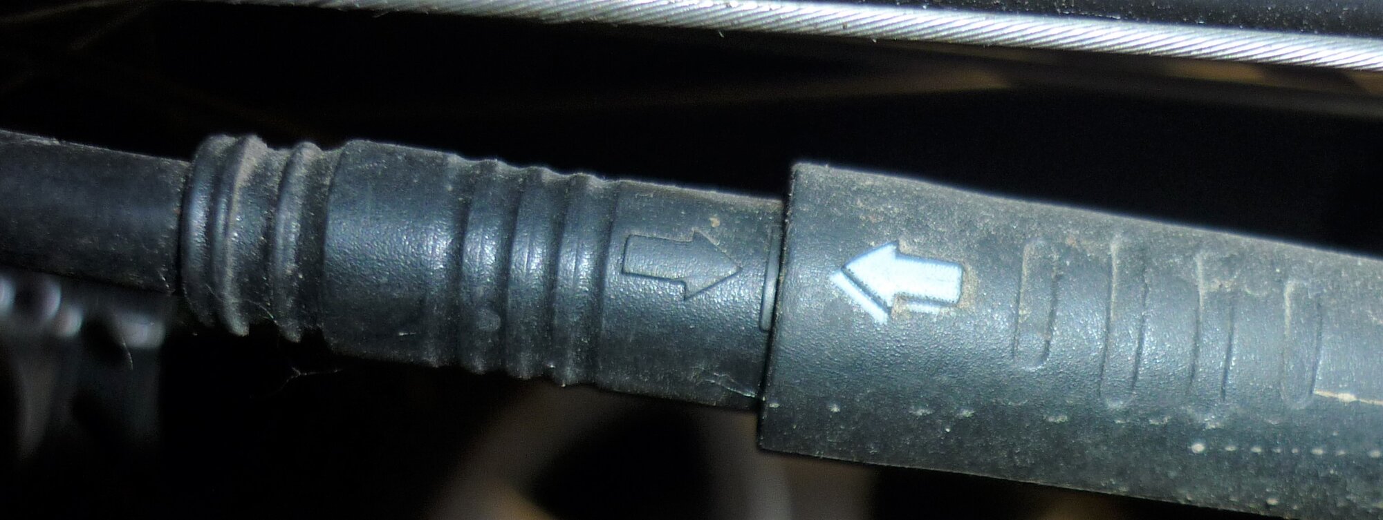

The internal connection to the pin might have been damaged contributing to this problem, but it seems to me from your first photo that the connectors may not be fully engaged. The left connector has an arrow pointing to the right with a line to the right. The right connector has an arrow pointing left. The connectors do not meet at the line. To me this implies that the connectors were not fully engaged. This could also contribute to the problem.

I don't know if you resolved this, but I have to agree with Sierratim that from your picture it doesn't look like you have the male and female connectors completely mated. As he said, they should come right up to that line to the right of the right pointing arrow to be properly seated. Here's a picture of mine:

No, I tried it today, no good.
I compared mine with yours, I see the difference. I will try it now and hope it works. Thanks a lot!

Thanks a lot. It works now. I wasn’t understanding what you referred this morning until Fred pointed it out. Thank you so much!

Thanks Fred, it worked now. I believe I was too careful to fully engage the two connector heads. Thanks a lot!

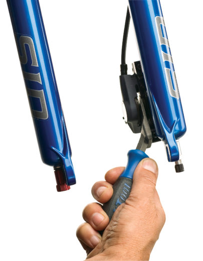

From https://www.parktool.com/product/hydraulic-brake-piston-press-pp-1-2
If you ride the Moscow with the mechanical disc brakes you can replace the pads without removing the wheel.
