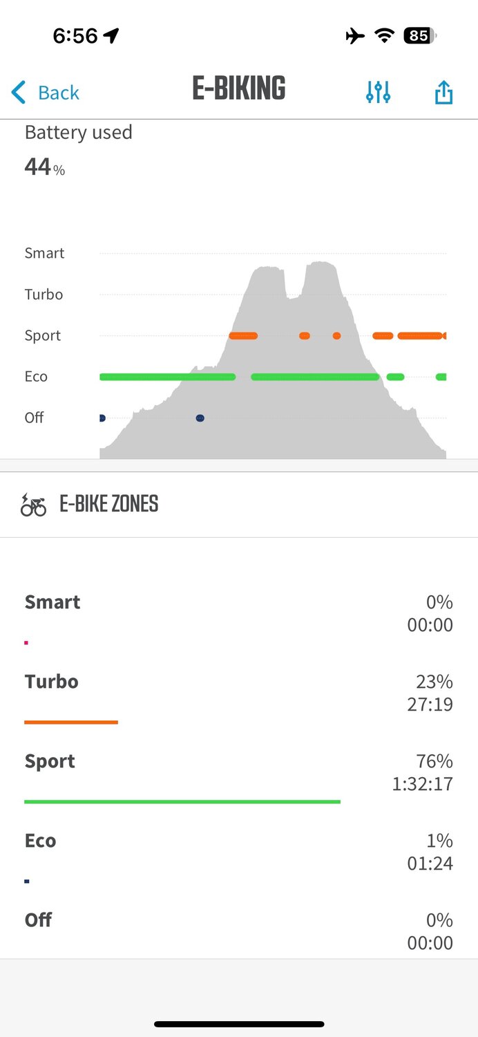

I get that from the Wahoo Element, though it’s not just an app.
kahn
northWET washington
That looks good. Is that via Ant+? Can the same info be displayed from a Garmin device (like 1030 plus)?
I don't think my Garmin 1030+ can show that level of detail but would be happy if someone showed me it could.

I definitely want to see that on my Wahoo. It is probably the History (Post Ride Analysis). YES IT IS THERE.
@kahn: Cannot say for Garmin but the detailed analysis for Wahoo Elemnt can be found in the ELEMNT Companion App under any recorded e-bike workout.
Yes, it is via Ant+.

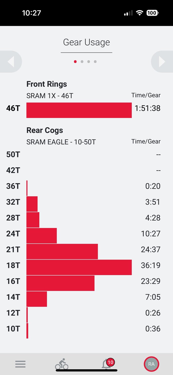

Another piece of info I like comes via Ant+, and is fed to the SRAM app by an upload from the Wahoo app. I’ve considered modifying my gearing based on this, but I’m a bit reluctant, as I do occasionally encounter a steep hill.

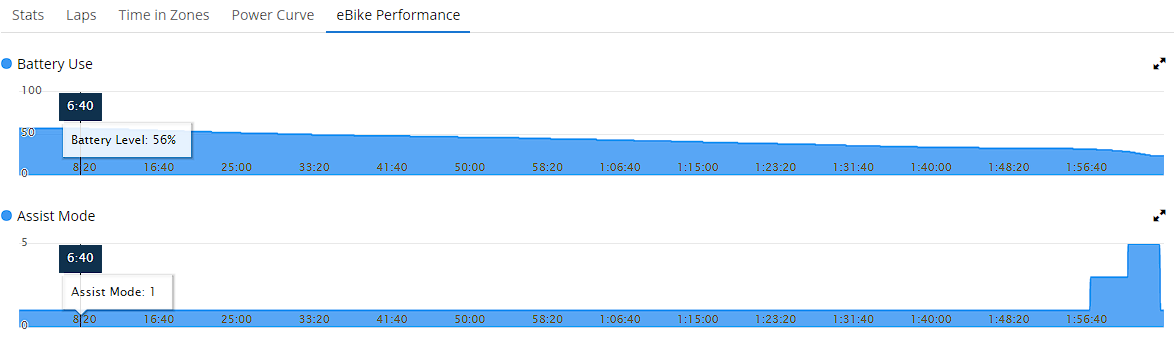

I use Garmin 1040 and the detail it puts to Garmin Connect is stunning. Here is an example of recent ride, showing I use Eco until the very end which is a climb
Thanks for your reply. I use Garmin Connect along with my 1030+, but I don't see those charts in the app on or the web version. Do you think it is a feature of the 1040 (vs the 1030+)? I note that the 1040 has some additional ebike data fields available that are not available for the 1030+. I do use ebike field - a garmin connect IQ app - which displays the information about level of support in real time on the device, but not afterwards on Garmin Connect.

I'm using a Garmin 1030+ and I see the same detail. I did not not know it was in Garmin Connect. I just went back a looked a double century ride from this summer.
That's promising that you see that same information using the 1030+. How exactly do you 'see' the same detail? Would you mind explaining so I can try too?
Allan47.7339
Open an activity in connect and there the tabs at the as shown in the post above assuming you've added the ebike as a sensor.
What's interesting (in true Garmin fashion), is that while I see that same information in Garmin Connect, it's under the main "Stats" tab -- there is no "eBike Performance" tab for me.
