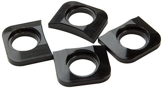

Shorter bolts or washers under the bolt head or spacers sold specifically as chainring spacers or chainring tabs like this

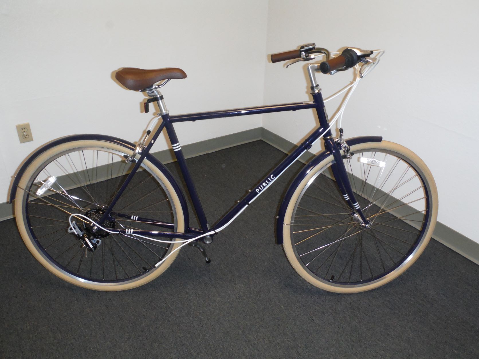

Yes the cable can go over the BB or you can run it over the top and down the seat stay. @EMXG is correct, run continuous housing. You get what you pay for with housings and cables. The better ones are so much better. I am doing it with white housing on a spanking new bike that came in today. It has never been ridden. It is a Public V7. A second conversion for the same family. The wife has had her bike for three years, now it is his turn.

That is Top Secret. I share a lot of clues of how to approach a problem, but cannot share all of my tuition. This is hard spent money. No one else has it. That is why people in this Bay Area bring bikes to me. I will show a photo when the new V7 is done. Improvise until you find a working solution. One with no wiggle, before it is locked down. Solid in the BB.
