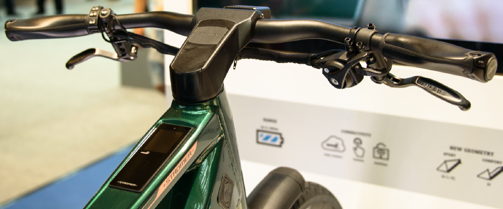

The Stromer OMNI display: Professionally integrated into the top tube:

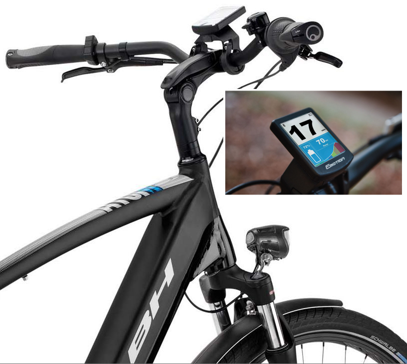

Typical solution on an ordinary e-bike: Chunky display mounted on the handlebar:

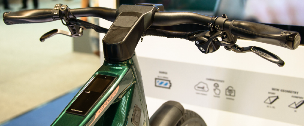

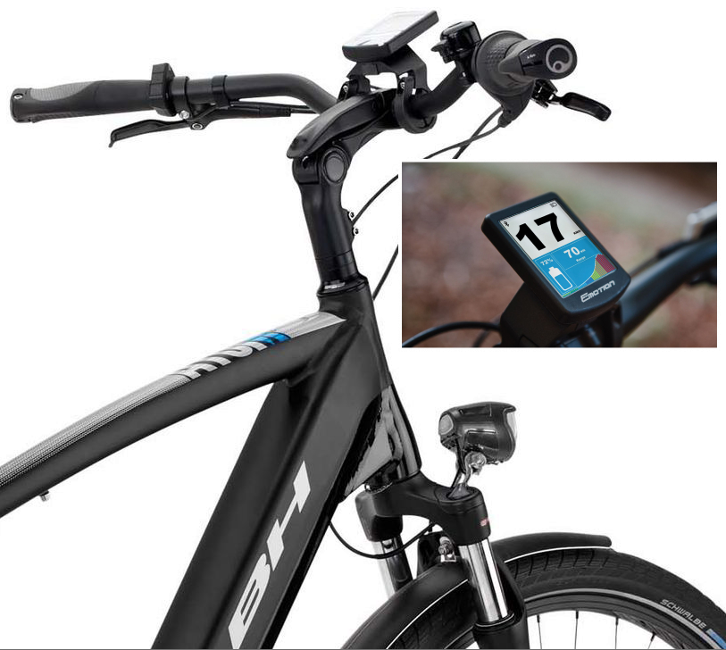

You lose the argument the instant you have to put one brand down to elevate another. An ebike brand will succeed from it's own record. Of the 2 bikes pictured, both brands having industry leading warranties, but will break outside of coverage. Which display will cost more to repair? Which could be replaced by the owner?
