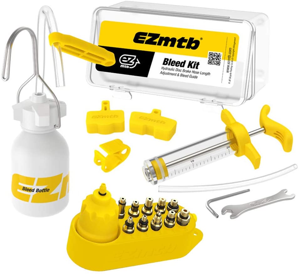

Something like this:
Do I need to tinker with the brake pistons etc. for this approach? And do I really need a bike stand to tilt the bike?
Yes, Exactly. You don't need a stand. You can just have the bike against a workbench or even a wall. The syringe technique really works to get the air out. As the guy in the vid says do it a few times. Some of them have an extension tube with a locking crimp. Get to the part where he does the half-pull.

Got it....seems a lot easier than a full bleed...which is do-able, but something I have absolutely no time for unfortunately. I will give this a shot before attempting a full bleed. Waiting for the Royal Blood oil to arrive in a couple of days.
