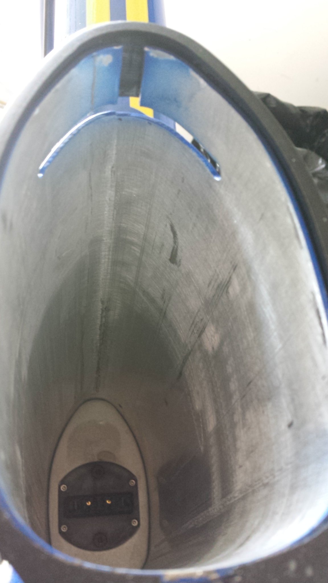

A few pics of the battery set up on this bike for anyone that is interested. The seat post is integrated into the battery, but can be removed when needed. There are two separate latches that are used to secure both the seat post and the battery when it's inside it's compartment (see close up below). So below you see the seat post with battery, a top/down shot of the battery compartment and where the battery connection is, an angle shot of the battery compartment, and a close up of the top of the battery and the latch that secures it. I did a quick seven miles on it this morning before a monsoon decided to drop on my city and the battery still showed fully charged when I got home (per handlebar mounted display). My longest trip has been just under 15 miles so far and that has only eaten up one bar of five. I'll continue updates.

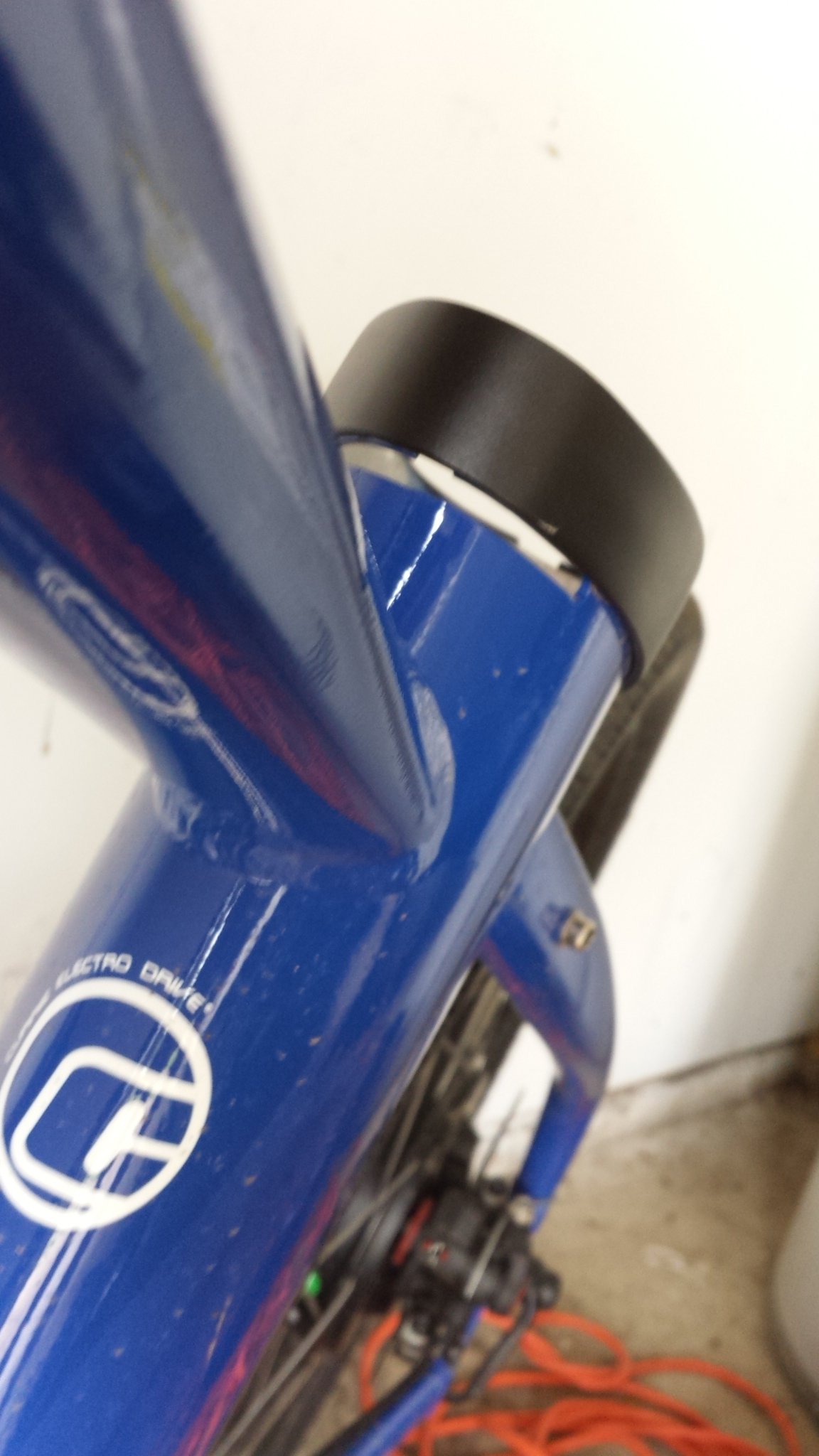

So I figured out where and how the water is getting into the battery compartment. I'm still trying to figure out exactly why this was designed the way that it was (I'm sure there is/was a reason for it), but it would seem to be a bad design. Notice the horizontal slit at the top of the battery compartment. Insofar as I can tell, the battery doesn't latch into this or anything, so I'm not really sure what it's there for. I figure I will tape it up for now until I can figure out something else or figure out what it's there for (ventilation??). See pics below.
