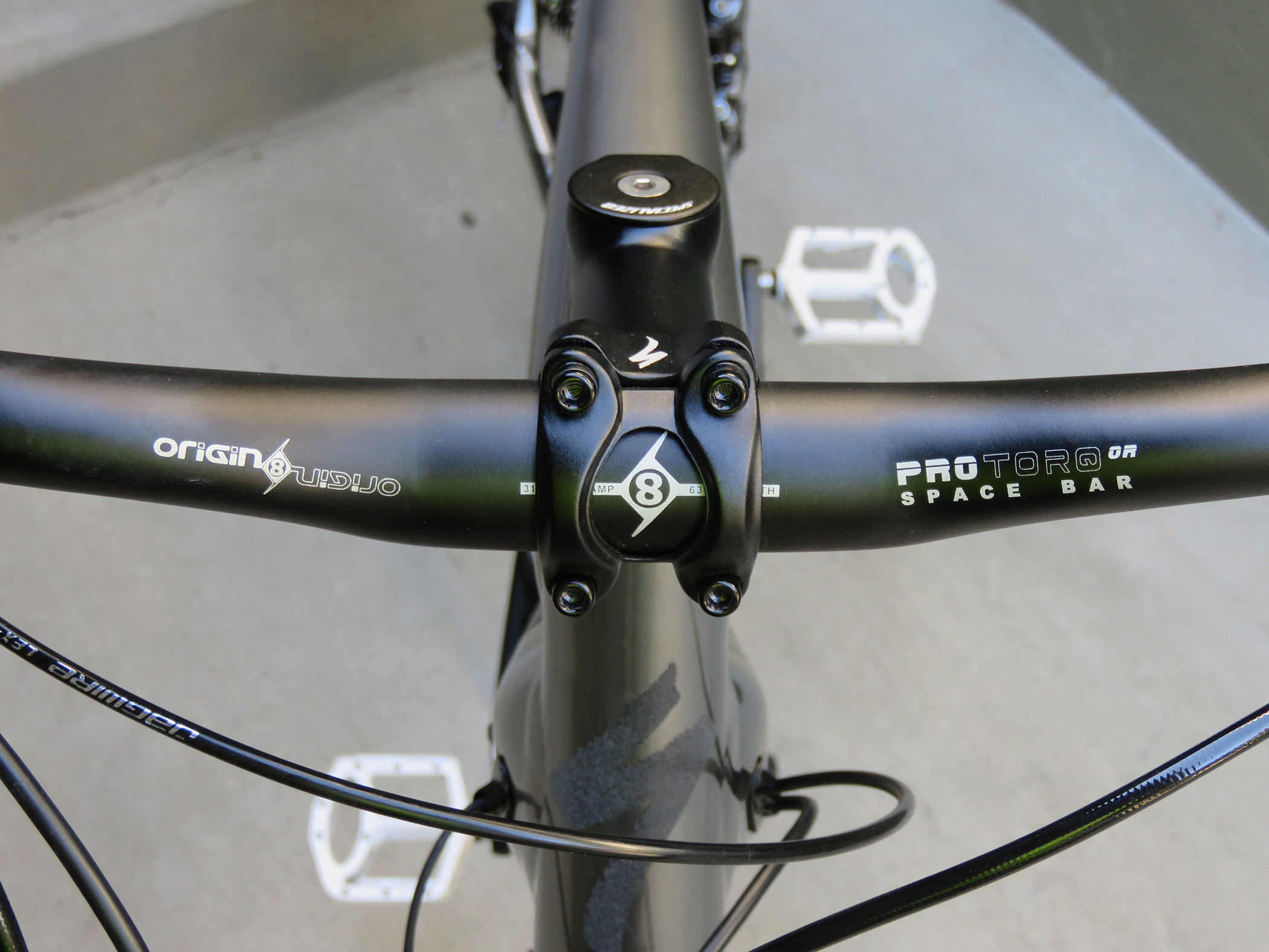

Ron Bez
Sounds like you are having a great time riding with your daughter Doug, that's great!
Here is something I said in an earlier post:
I have never liked straight bars, they are not comfortable for me. After a couple of thousand miles on my first e bike with them I ended up with tennis elbow from the unnatural hand position. The physical therapist figured out it was the straight handlebars. You want your hands and wrist at a neutral position, the 40 degree sweep bars give you a much more neutral hand position. It took almost a year to get the tennis elbow cleared up, very disruptive.
I also had the numbness all the time. That is completely gone now, along the the tennis elbow.....thank god.
The Ergon grips are great, make sure you get your desired circumference when you order them.
I think you are going to like the narrower tires given your background. The bike will handle quicker, I like it that way.
Origin 8 Space Bar 40 degree back sweep Much more natural arm and wrist position of me. Numbness gone completely.

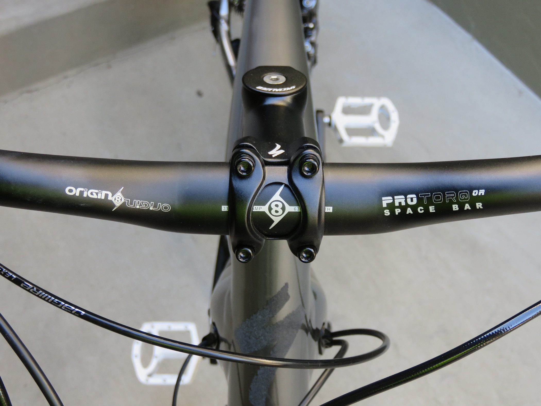

Ron, I hear you. I like straight bars as long as I have the extra bar ends to allow me to change hand positions. I like your bars. On my old road bike, I changed the vintage Cinelli drops over to Nitto moustache bars. See pic. below
