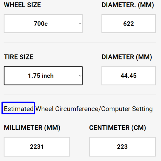

Why guess. Just use this to get the precise circumference of your tire.
"Estimated" is the keyword here:
This is how the calculator assesses the wheel circumference of my 47-622 Schwalbe Smart Sam tyres...
The point is, the exact profile of the tyre, and the exact height of knobs makes the wheel circumference different from the estimated value. I have found the actual wheel circumference of my Vado tyres at 4 bar inflation was 2216 mm (and that value has given a 100% match with the GPS on multiple long rides).
The same for my 37-622 Smart Sams on my Vado SL (2157 mm). The size of 37 mm is even not in the calculator!
