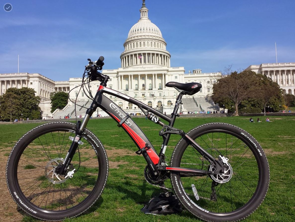

Hey Scott,
I lived in Orlando (working at UCF) for about 4 months in 2009 and loved the place. I believe its even more beautiful in Palm Coast. You get almost 10 months of great weather and I would love to see your Neo Jumper parked next to some harley's on the beach :)
DC is a excellent place, although my school work drains my energy, I take a short weekend ride to DC and just hang around the National Mall area. I park my bike like this and enjoy the view from the Capitol building.
Scott
Hey Scott,
