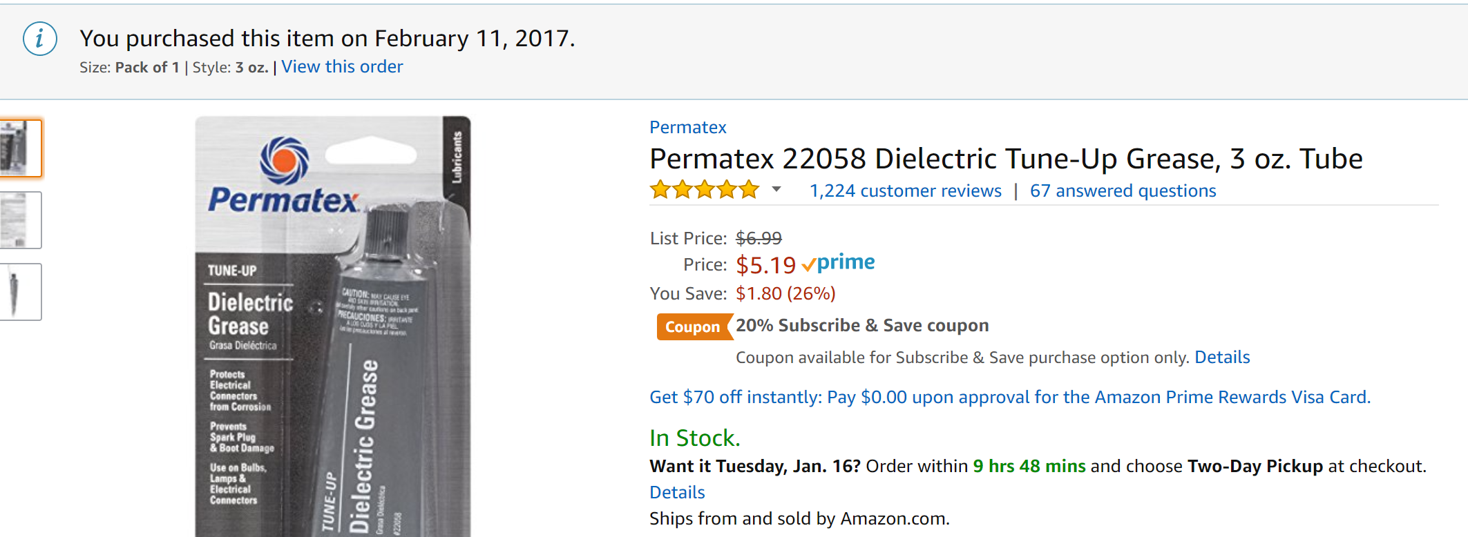

That's a bummer...sorry to hear of your troubles. Although it seems that yours may be a battery hardware issue, I'd like to recommend applying dielectric-grease to all the bike's electrical-contacts as a matter of general maintenance. I have been using it for nearly a year in some pretty messy damp environments, and have had ZERO issues.
Guidz
Again, many thanks. Just ordered up a tube! NE Electric Bike demonstrated immediate competence and followed exactly what was suggested here - either battery or display. Without any prompting from me, they asked me to ship BOTH back immediately for testing. They haven't received the package yet but, again, I'll be sure to report back. With the battery only charging a max of 4/5 despite leaving it plugged in all night off the bike, I can't help but think that a problem is going to be right there. In the meantime? Tube of dialectric grease is on the way. I appreciate the time in taking the screen-shot. It'll be here before the battery / console returns. :)
