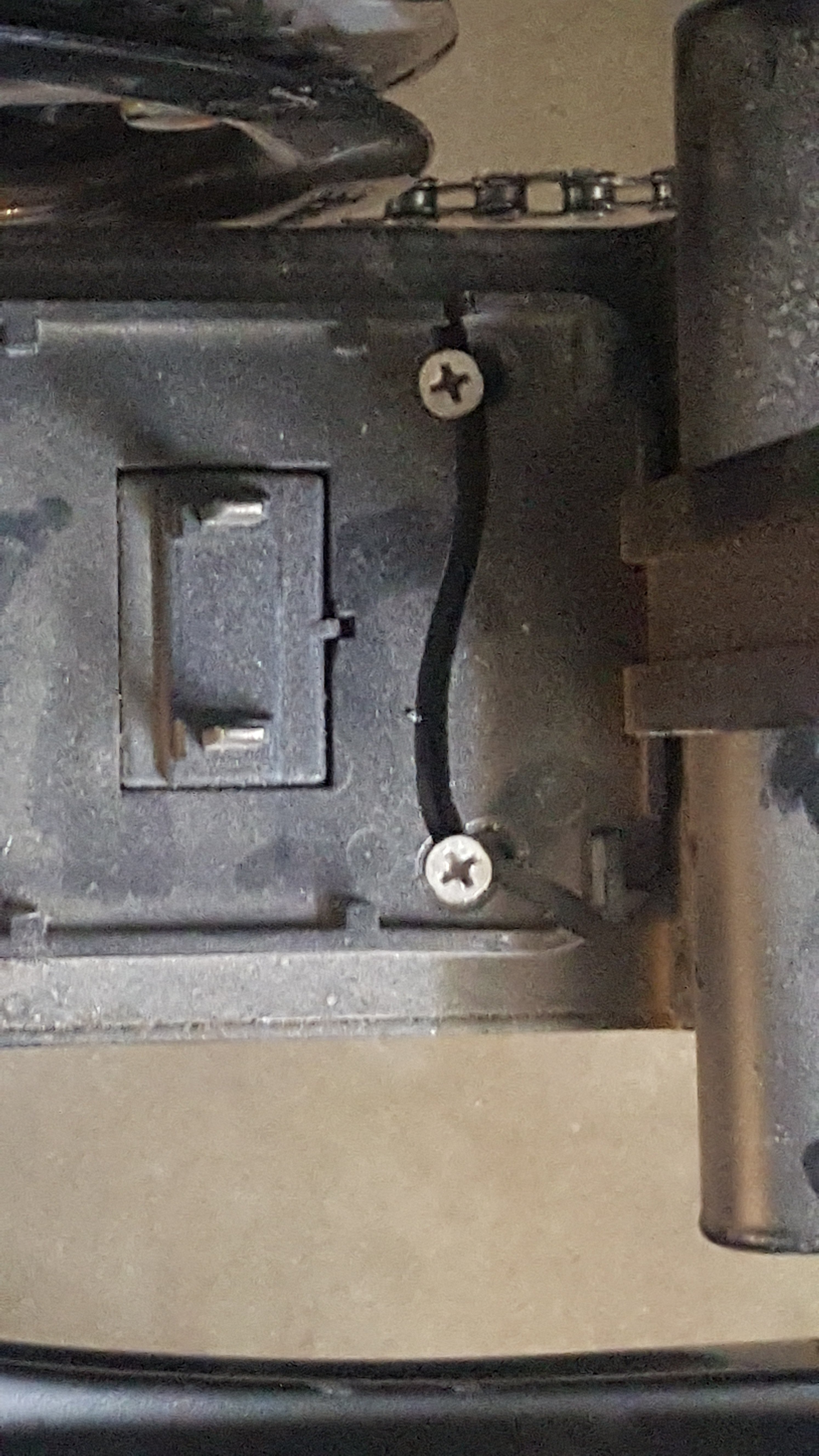

Reported a problem with my Radmini. I noticed that the top of the controller box had cracked when I removed the battery as I was getting ready to fold the bike to put it in the trunk of my car. I It holds together once the battery is back on the rail and connected to the contacts, but I can see it will eventually be a fatal problem.

Reported a problem with my Radmini. I noticed that the top of the controller box had cracked when I removed the battery as I was getting ready to fold the bike to put it in the trunk of my car. I It holds together once the battery is back on the rail and connected to the contacts, but I can see it will eventually be a fatal problem.View attachment 17565
Frame needs to be replace or welded,potential for catastrophic failure,controller box is a structural part of lower frame u must contact rad rover
