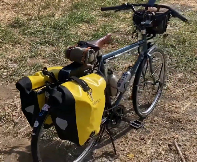

My Surly Long Haul Trucker and I have been happily aging together. But both of us are showing some wear. I'm 68 but my Surly would rather not say. I'm thinking an e bike is in my future to keep up with friends who are getting ebikes and give me some help on hills or windy days. I have a list of features I'm looking for: light weight as I want to be able to get it on the rack myself (yes, I know you can buy racks with ramps but it all seems unwieldy to me), mid mount motor, class 1 or 2 (Do they make these?), no more expensive than $4,000 though less is nice.
I keep coming back to the Kona Dew-e though my local bike shop says they won't have any til 2022, possibly spring. I tried the Kona Splice-e and liked that it was lighter than the other bikes she had me try (A gazelle and a class 3 giant). Both the Gazelle and the Giant felt heavy to me. I liked that the Kona was more bicycle like and I could ride it comfortably in the off mode, at least on the flats. I just don't think the mountain bike features of the Splice are for me.
My questions are: If you have a Dew-e, either the regular model or the dl, what is your experience with it? Can you suggest other bikes that might work for me? I do day rides usually topping out at 20 miles, though occasionally up to 40 or 45 miles. I also do some (rather rare) light touring (no camping gear and no days longer than 45 miles). I like rails to trails sometimes. I'm a pretty slow rider a nd that is generally fine with me but the hills are getting difficult.
