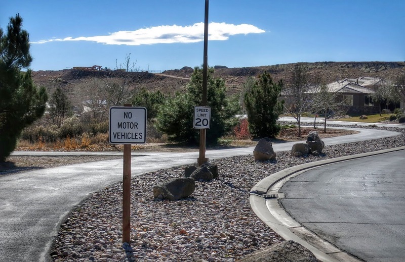

In Utah, a motor is a motor, and makes a motor vehicle, which requires at least a driver license. Here's how the bike paths are marked.
No Mo.jpe
