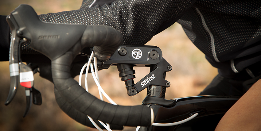

I even saw a lot of handlebar suspension stems. The StaFast looks like the top of the line model. Don't know if those can be added to the ST2 by itself or in combo with the front suspension forks: http://www.cyclingabout.com/suspension-stems-making-your-ride-smoother/
A Fox front suspension for about $700! for a bike that already retails at $6,999. Do the math! You can get a complete bike with full suspension for far less...

We have installed front suspension forks from Stromer with no issues. There are also stem related suspension options that may help. I wrote the review for the Sta-Fast and it was satisfactory for my purposes.
