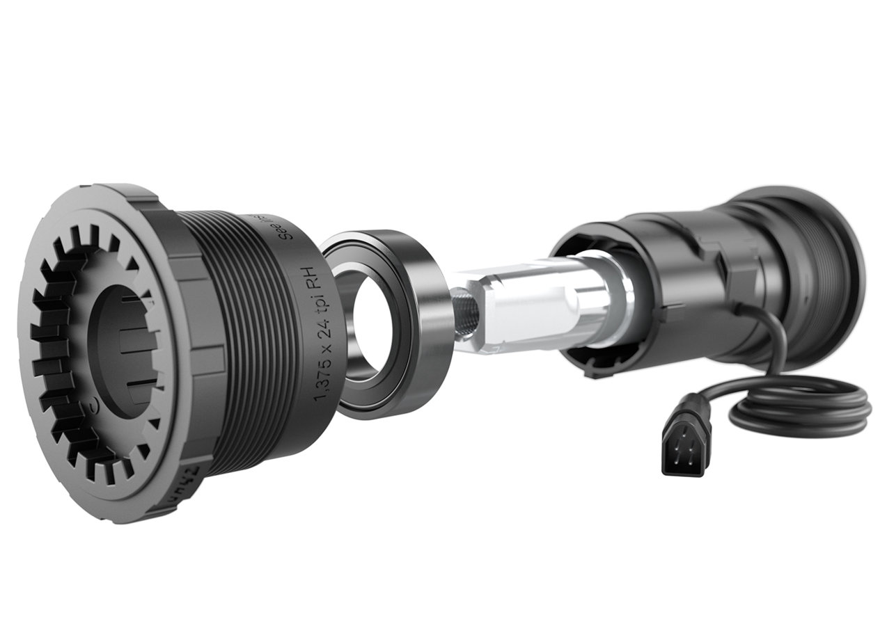

Any thoughts on the typical life of a torque sensing BB? My bike has a TDCM BB. I’ve put about 4,200 miles on this one, and my LBS technician showed me it was “worn out” when I took the bike in for troubleshooting / diagnosing a nearly constant clicky/squeaky sound and “clicks” I could feel through the pedals—as well as a unexpected trio of chain derailings in the last 3 weeks—-having never had one before. He showed me there was a lot of play and wiggle/slop in the BB, and that a worn bracket produces all of my symptoms typically.
So, I’m replacing it—but it seems like 11 months and 4,200 miles of paved surface, 99.8% rain-free riding wouldn’t or shouldn’t be enough time or use to wear this out? That’s just my gut reaction... but I have no prior experience with lifespan of a torque sensing BB...

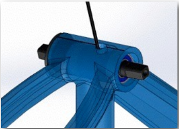

Of course, water could still get into the BB area -- since the TDCM BB has a wire emerging from it (through a pre-drilled hole in the bike frame) -- and while I generally avoid rain riding, I have been caught in perhaps half a dozen showers, and may have hit, once?, a puddle deep enough that the water could have reached up to that pre-drilled hole...

Setting aside water (let’s assume some likely VERY small amounts probably could have reached the BB over the 11 mos) — does that help answer the question of whether 11 mos/4200 miles would be “reasonable life” for this hardware?

Average cyclist cadence is 60rpm, assume 15mph average over 4,200, doesn't that work out to over a million revolutions? Most under load? Doesn't seem bad to me, but with my lack of confidence in my math who knows? Did the bearings fail, or was it the torque sensor? Bearings are cheap!

One of the downsides of BB torque sensor is that the rider needs to keep a close eye on the BB and eliminate any play in the shell.
Older Izip models had this torque sensor and the wiring would get severed routinely and recently, they switched to the Suntour system that is a bit more robust.
if I were you, every 4 months, I would check the BB and make sure there is no play in the BB shell and crank spindle.

Update: A new TDCM BB was installed Friday at my LBS --- I got in a 30 mile ride yesterday, and all the prior noises and "crunchy" sensations felt through the pedals are blissfully gone.
Overall pedaling seems smoother, as does the gear shifting, which would make sense if the BB was worn enough / had developed enough slop or play to start allowing some left-to-right wiggle through the spindle...
The folks at VEB (bike maker) said that yes, the bearings for this particular BB could be replaced -- though they've never had a customer need to do that. In my case here, that wouldn't have helped this time anyway, as the torque sensor wire was inadvertently severed during the LBS removal process. But if these same symptoms show up in say, another 12 months / 4 - 5k miles, I'll certainly try to remember bearing-replacement first, hopefully a little less pricey than the $149 BB.

Hi @Ravi Kempaiah -- yes, the BB has a wire that passes from the spindle/body through a small hole in the frame in order to connect with the wiring system of the bike. (Both the original BB's, and the new Thun have this, since the sensor must communicate to the controller to indicate when I'm pedaling and when I'm not.)
I guess my question is, in terms of trying to check/monitor this on my own once the new one is installed... at home as a non-professional bike mechanic ;) -- where do I start? What would I be looking for or checking, routinely? And what kind of tools would I need in order to confirm torque numbers?
I assume you mean to check on the tightness / torque applied to tightening the components of the BB assembly? ie, the tightness of the threaded rings that secure the assembly into the bike frame -- I know the old BB required a 2-pronged BB wrench to unscrew; I'm not sure the Thun has the same mounting hardware -- but either way, I don't know that I've seen a BB wrench with applied-torque-measuring built into the wrench...?

Each BB sensor may have slightly different mounting hardware but they all need to latch onto the bike frame very firmly without any jiggle whatsoever.
I don't have a lot of time on those bikes equipped with BB sensors but I am aware of them and I do find them a bit more finicky than dropout sensors.
If I were you, I would start with a detailed look into that BB area every 2 weeks and see if there is any sign of cable pull.
