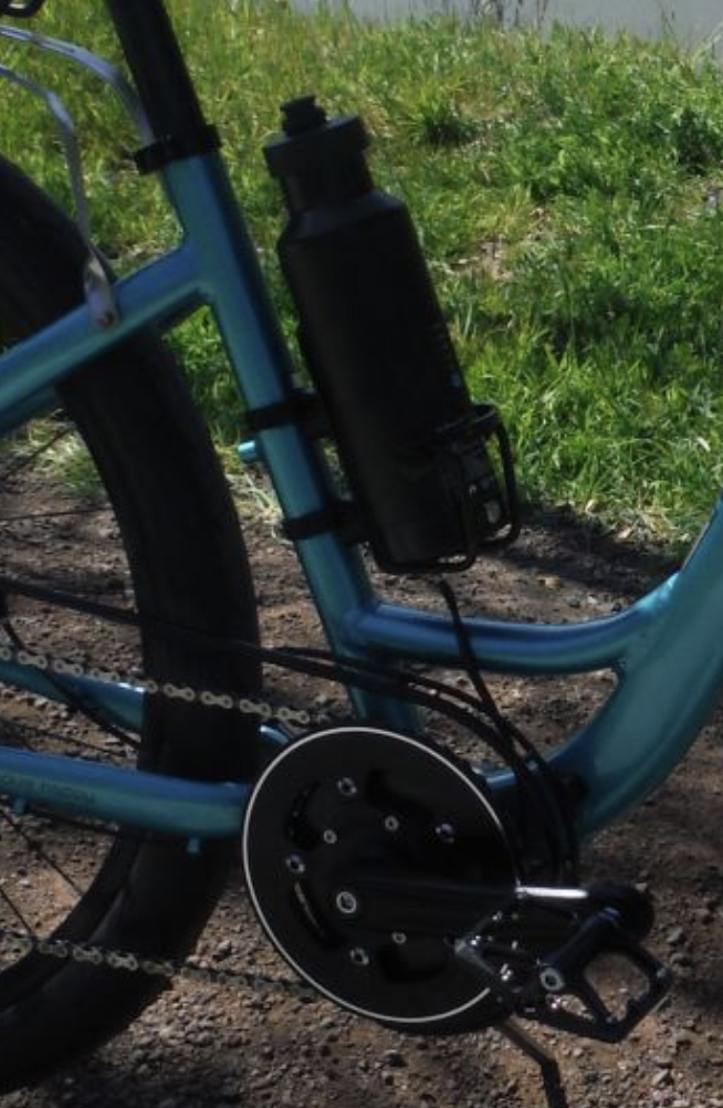

@McSkelley, I make them, exactly to my specifications and requirements. I am a world away in Northern California. But anyone, anywhere with creativity and initiative can do this to get a better bike than those offered at stores. I like the new eBike chains that are super strong for internally geared hubs more than belts. They last about as long and are more practical and far less costly. Here are two examples. One is a step through, the second has an IGH. This is exactly what superior electric bikes look like, not clunky and under 20Kg. And with the right to repair, so you are not stuck with a proprietary system that you do not really own, but you are beholden to. Freedom!

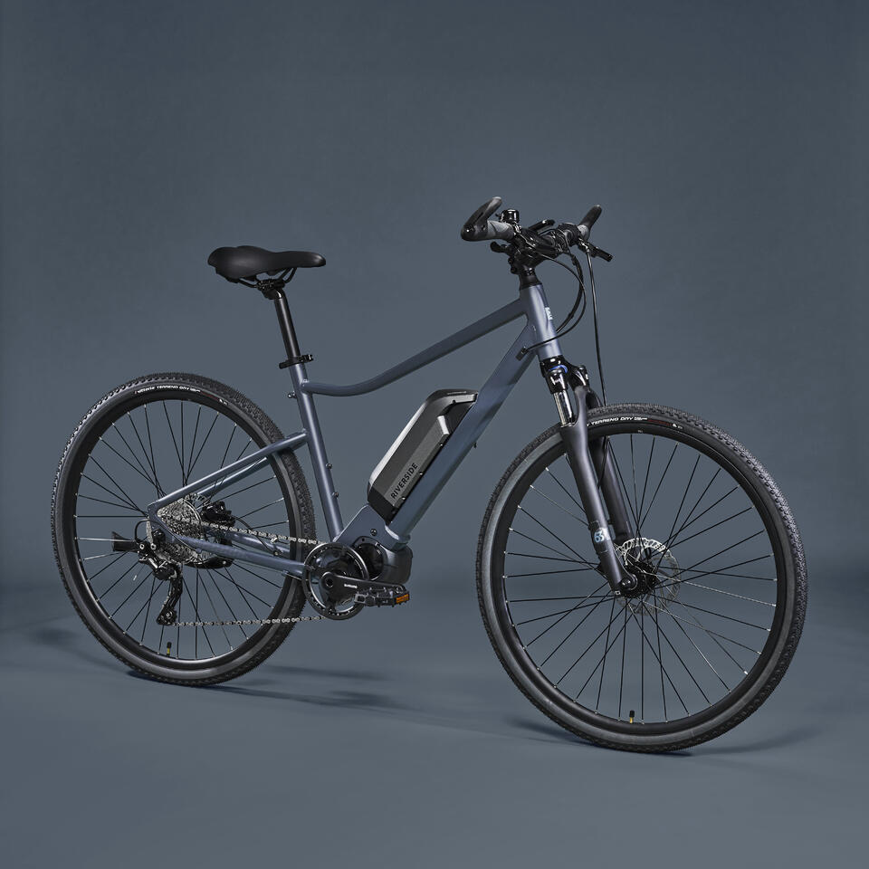

What about this mid drive (shimano E6100) Decathlon bike:
It's slightly over your budget (£2199) and slightly over your max weight (21.7kg). Has a lowered top tube.
