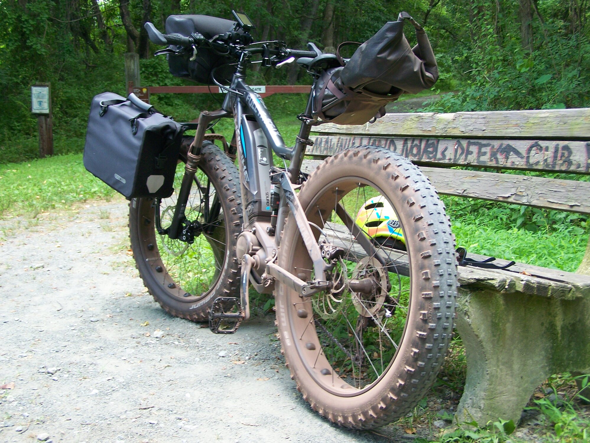

It's all too subjective with varying elevation, wind direction and temperature; but my long term ownership of the Yamaha PW powered Haibike Full FatSix has shown I can get close to 40 miles at an average speed of 13 mph on a fully charged 500wh battery. And I certainly can believe that a Yamaha motored mtb or commuter style bike frame and 2.4 wide tire can deliver the expected 53 miles that Yamaha predicts in that high power setting; based off what I achieve with the 26 x 4 inch wide fat bike tires. I do believe Yamaha beats Bosch and the other mid drives in the "fuel mileage" department.

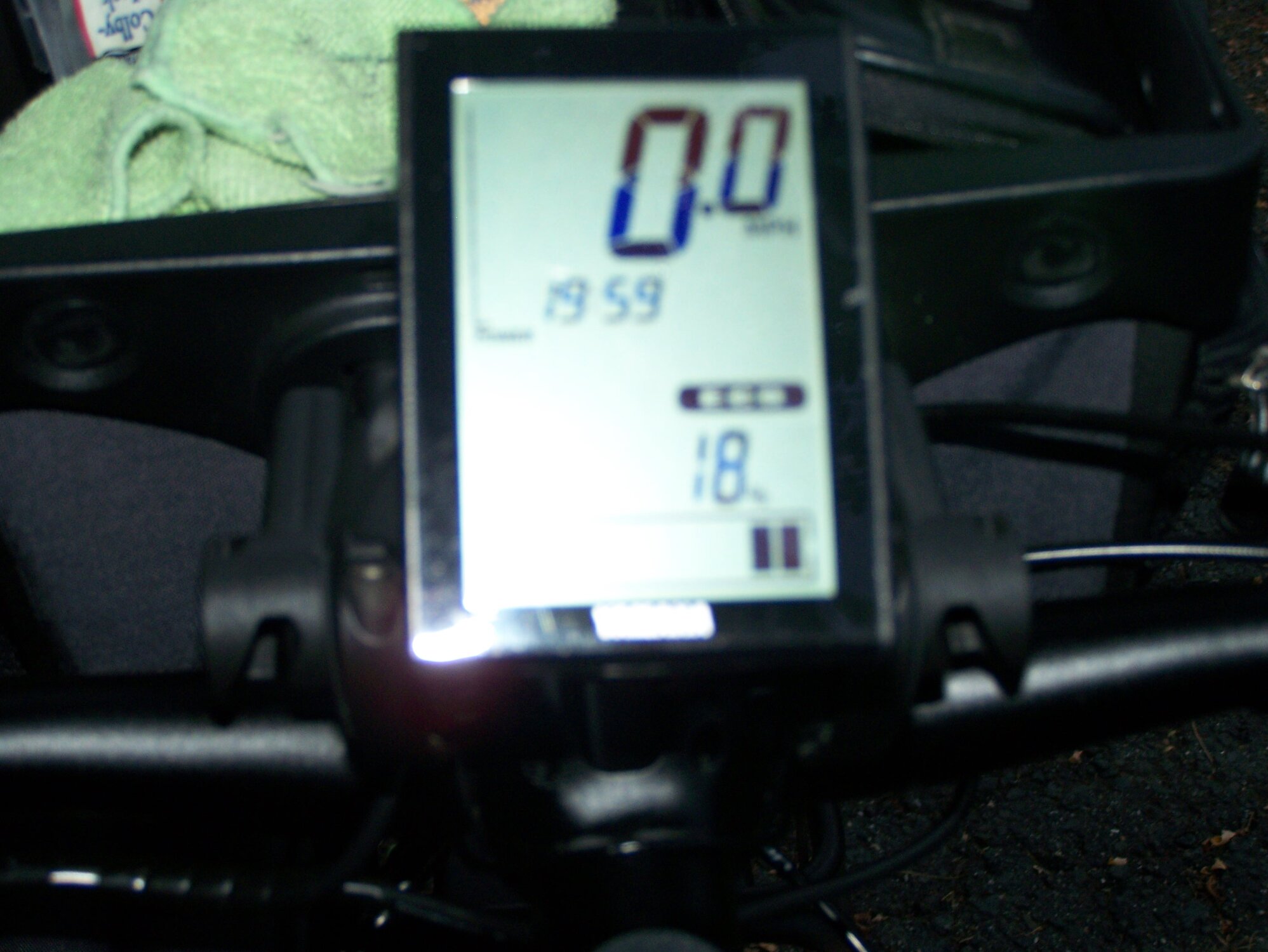

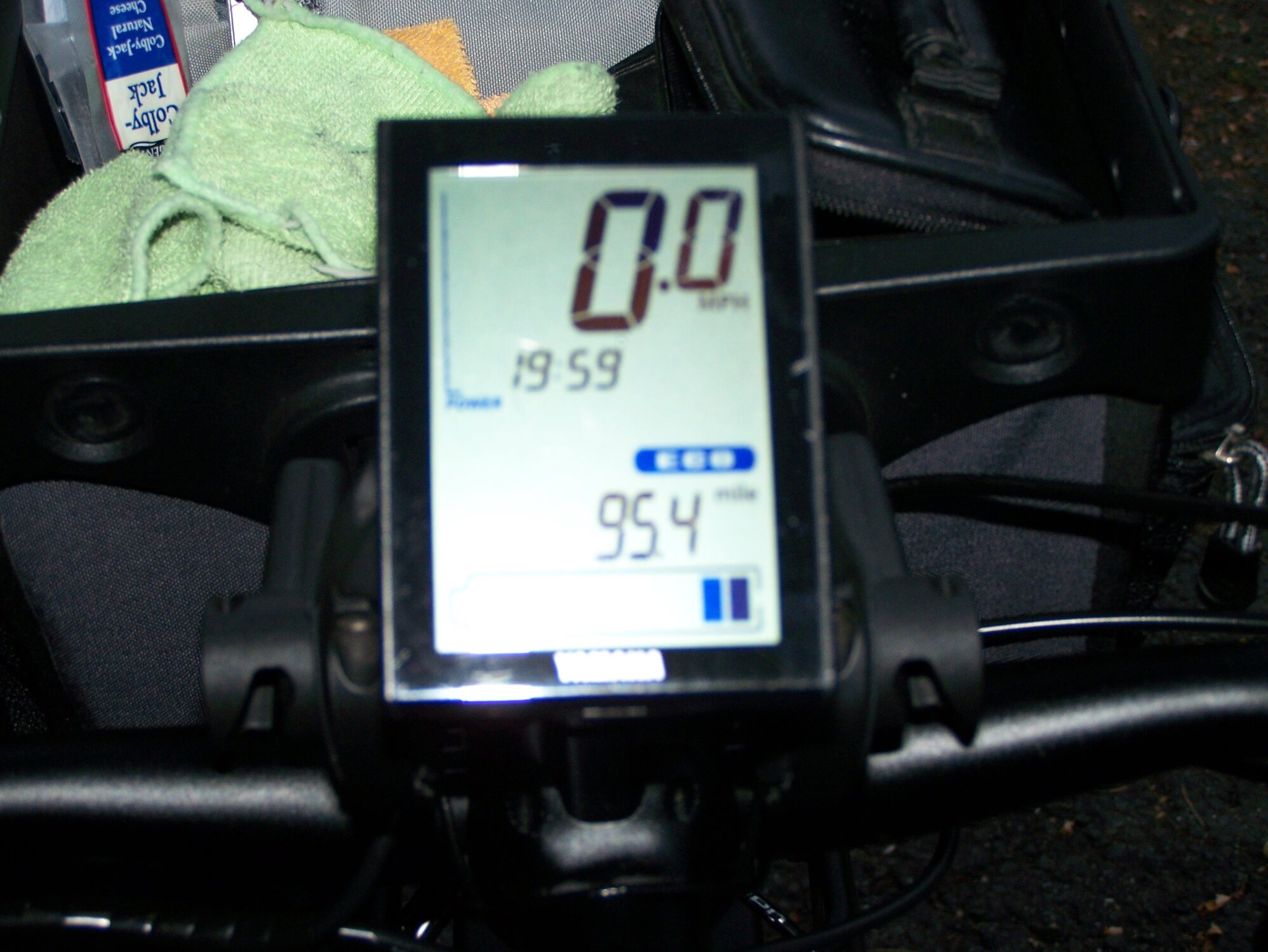

I had to go back in my Time Machine a bit, but in July of 2018, using my original 400wh battery and a combination of power settings (most of the miles done in Eco and Eco+ for maximum mileage), I did a canal towpath ride of 95 miles and had 18% power remaining in the battery. After that run, I learned that for the most fun, carrying multiple spare batteries with me was the ticket to running in High power vs those lower power settings. Here are a few pics of that ride.
You can say I'm partial to Yamaha power....

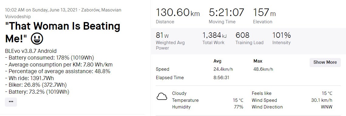

Here are my 80 mi ride data:
Vado 5.0, a spare 604 Wh battery. Flat area, strong headwind for the half of the ride. Quite good average speed. A strong 38-yo female traditional rider was setting the pace...
