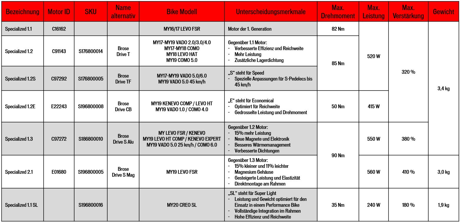

Thank you very much for your thoughts. I’d definitely go with the 3.0 no question about it, except the motors are not the same— it is less powerful:
50 Nm of torque, 420 peak watts, vs. 72 Nm of torque 520 peak watts. I fear I will miss that power on our hills. But maybe that difference is not really noticeable?
That's the difference between the 1.2 and the 1.2E? I haven't been able to find specs like that. All I can find is this:
3.0: MOTOR Specialized 1.2 E, custom Rx Street-tuned motor, 250W nominal
4.0: MOTOR Specialized 1.2, custom Rx Street-tuned motor, 250W nominal
on the 2020 Vado page.

Yes, they certainly do not highlight the reduced power of the motor on their selling page! The motor on the Vado 2020 3.0 goes under the name 1.2E and Brose C. If you Google Brose C, it is easier to find information, and confirm that it is less powerful-- the nominal output is identical, but the peak is reduced. The 2020 Como 3.0 is reviewed on this site, and he goes into some detail on the reduced motor:
"Driving the bike is a Brose C mid-drive, however this one is called the Brose CB with the B designating that is is a specific customized setup just for Specialized. This is a street tuned motor with a nominal rating of 250watts and 50nm of torque."
  • "When comparing the 3.0 to the higher trim levels, you can feel a difference in either the motor or battery as they both get upgrades and you get to enjoy the same frame, so make sure to test ride and find the one that is right for both your needs and budget"
Since he points out that that you can feel the difference, this is where I get concerned that I will regret the reduced output on our impressive hills. But maybe it is not that noticeable?

I've been told that the 1.2E with the 460wh battery has the same range of the 1.2 with the 504wh battery so if not factoring in steep hills, I would also say get the 3.0 with the 1.2E for sure. I say that cause when I bought my 2019 Como 3.0, the only reason I paid the extra $1000 over the 2.0 was for the 28mph. Knowing what I know now, I would have got the 2.0 with the 1.2E, bought the extra 604wh battery with the difference and be planning much longer rides.
Even factoring in steep hills, I think upgrading the cassette to the 10 speed HG500 with that 42 tooth sprocket ($35) and the Deore Shadow Plus derailleur ($65) to match the Vado 4.0 would make the 22Nm torque difference negligible on climbs.
3.0: MOTOR ... , 250W nominal
4.0: MOTOR ... , 250W nominal
Ebiker01 said:
250 watts motor ...Incredibly low end specs
This spec "250W" gives you no information at all!
250W nominal is the legal limit in Europe so (almost) all pedelecs are "250W nominal" and there is none above that.
Peak power is the spec to look for, and peak power is >250W with both of them.
The 1.2E is designed for urban or flat terrain use to give you longer reach so the smaller battery is efficent enough. Power is sufficient for this use too.
If you reduce the max. output of the 1.2 motor by software you'll get the same effect.

Very big help. Thanks! Interesting that the max assistance is 320% for all of them, so I wonder exactly how the Nm plays into the game: that's quite a difference, 50 vs. 85Nm. Is that what is going to be noticeable on big hills? Anyway, thanks for all the input. I am hoping to try a 3.0, and then I will be able to determine how it feels compared to my broken 2.0. If I can't try it out, I'll probably go with the no cost 3.0, and be happy with a new bike.
I am going to surmise here, so don't rely on this without confirmation. Class 3, (28 mph nominal and 26 actual) requires almost twice, 2X, the power as Class 1 (20 nominal and about 19 actual, i.e. excluding human input). Thus the need for the 70% increase in torque for the Class 3's motor vs. the Class 1's.
[edit: corrected for mistake pointed out by uburo in #75 below]
Recall also that EU regulations require EV motors to be limited to 250 watts which, one would think, would lead to manufacturers being reluctant to boast of their "watts". Therefore, torque is used as a substitute? My guess is "yes".
