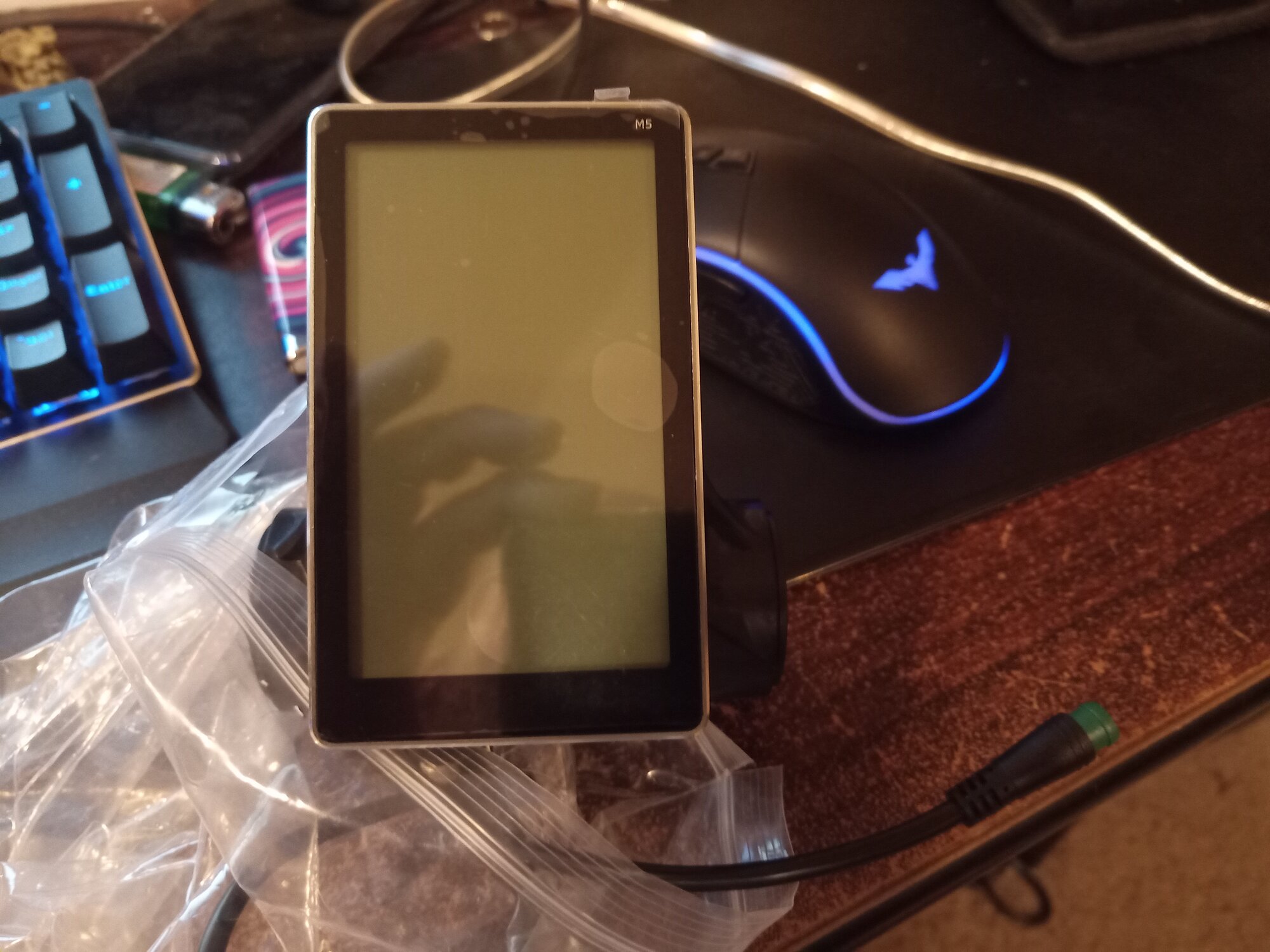

So I purchased a "Nakto" M5 LCD from electriczip, shipping is slow right now though. No idea if this unit will actually have the waterproof connector on it as the bikes they are used for don't appear to have a waterproof harness.... So I bought a cable I can cut open and solder where needed inside the M5, or just rip the old one out. It looks like the Nakto display has a different firmware on it, it has the full range of settings available unlike the Aventon model, unsure what benefit this may bring though. The Nakto model also displays current, but I think the controller would need to support it, and who knows what ours can report!

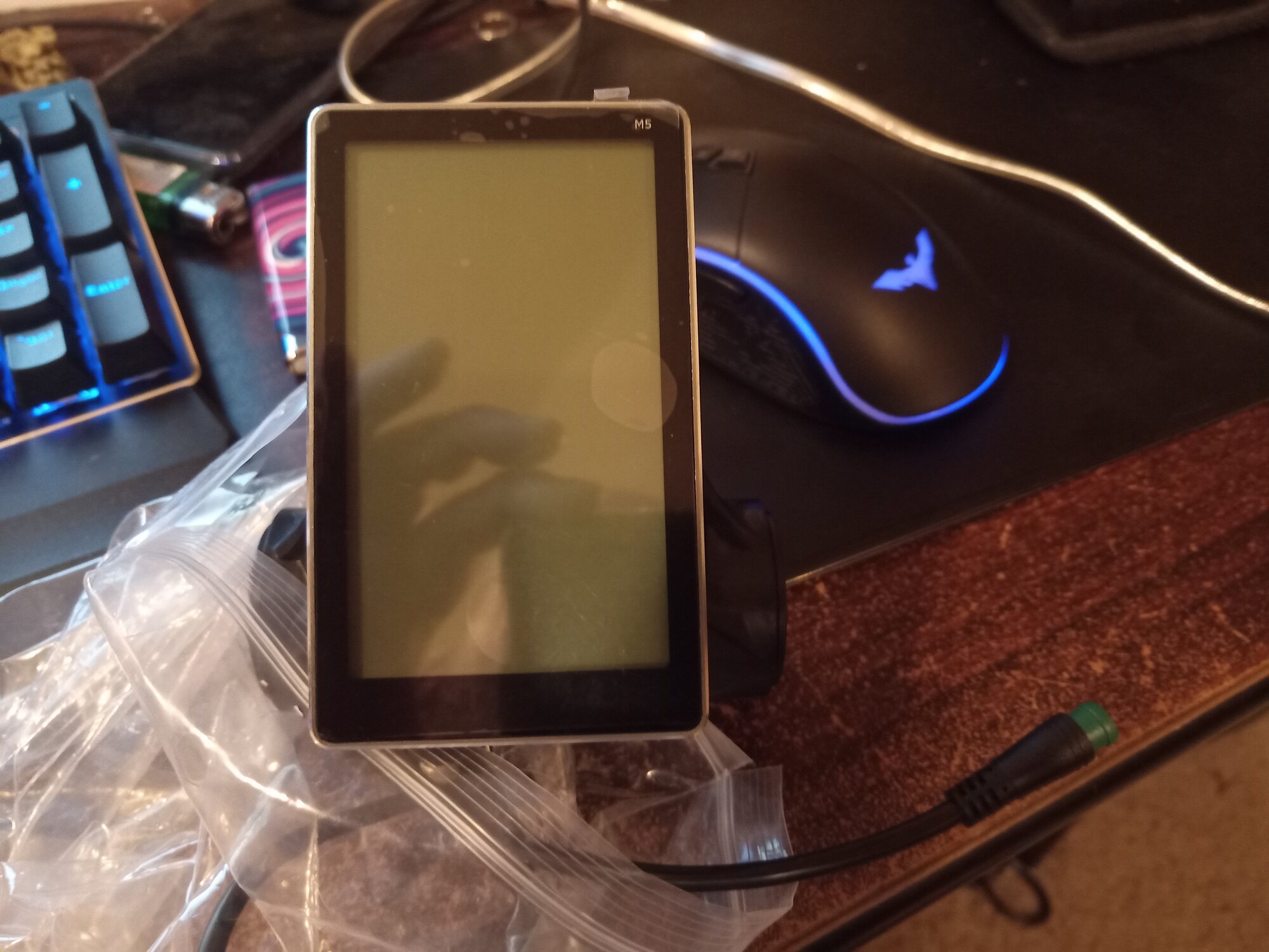

I have found that an off the shelf Nakto M5 display without Aventon firmware works just fine! The display isn't terminated to the Higo/Julet 5 pin male connector, but I can remove the back cover + wires of the old display and solder those onto the new one, or I can splice on the extension cable I bought.
Turns out the controllers used here are using Kingmeter 618U / J-LCD protocol. I verified this by hooking up the new and broken old display to a logic analyzer and found the protocols to match this library https://github.com/MichaelFabry/Ard...uino_Pedelec_Controller/display_kingmeter.cpp
The APT TFT 750C does not work and I do not know what I will do with this. I may try to reverse engineer it, following the 850C board's custom firmware, and add this protocol in. The protocol is simple but reversing the board is not!
