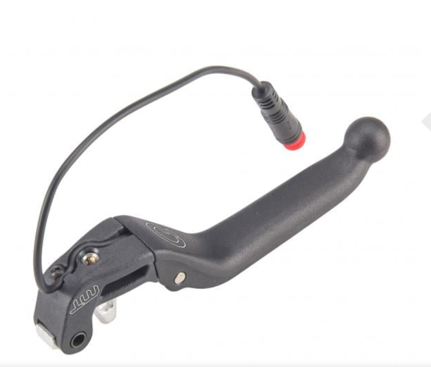

Hello magura ebikers!
I have a question for you : which one of you can tell me what is the intern part of this red connector?
Are there 3 pins?(Link Removed - Attachment No Longer Exists)(Link Removed - Attachment No Longer Exists)
I cannot open your attachment, but I presume you you're talking about the motor cut-off switch's Higo connector, which is 2 pins inside.

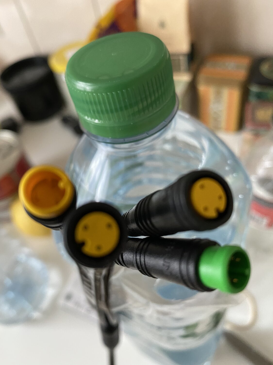

barbe
Yes guitartec, my attachment failed. I try another : magura.PNG
barbe
And is this Higo connector suitable for those of engine bafang BBS01B? It looks like yes, but im not so sure...
Guitartec
Yes guitartec, my attachment failed. I try another :View attachment 58950
Barbe, it's a 3-pin Higo motor cut-off connector. I have a Youtube video (link above) that talks about this in the description.
THE MOTOR CUT-OFF SWITCH (with red Higo male connector)...
The first thing to know is that ebikes often come with either a Normally Open motor cut-off switch OR a Normally Closed motor cut-off switch- it is not standardized, so you'll need to ask the bike or brake manufacturer or physically check it with a multi meter. The switch is built into the brake lever assembly and instantly cuts power to the motor when the brake is applied.
While studying the Magura MT5e brake system on the Magura site to see if it would fit my bike, I kept seeing the words "CLOSER" and "OPENER" along with the acronyms NO and NC in the description and instructions.
"Normally Open (NO)" and "Normally Closed (NC)" are regular electrical industry American terms when talking about different types of electrical switches, however, Closer and Opener are not familiar to me, but I'm no electrical expert.
So... "CLOSER" means that the motor cut-off switch in the brake lever is Normlly Open electrically (NO). "OPENER' means the switch is normally closed electrically (NC). This is not explained very well on their site, but so aren't a lot of things. Maybe it's from when the descriptions on the German Magura site were translated to English. Who knows.
The Juiced Ripcurrent uses a normally open (CLOSER) switch. This was checked using continuity through a multi meter. Plus, it worked perfectly on my RCS. Make sure you get the correct Opener or Closer Magura lever switch for your application. Oh and PS... Magura uses a magnetic reed switch in case you were wondering.
The bike's controller (ECU) determines what connector is used for motor cut-off, not the motor. Maybe you should ask the people you got the bike or the controller from. And you should also ask them if you need a NO or NC brake switch.
barbe
green for display, 2 yellow for brakes and one yellow for throttle. That's my controller outer cables.
For NO and NC, idk.
But I know that the 2 yellow are the ones that can fit magura lever.

barbe
I have this result : if I don't touch the lever, nothing to read on my multimeter. If I touch (push I think) the lever the multimeter shows continuity.
So it's NO ?
