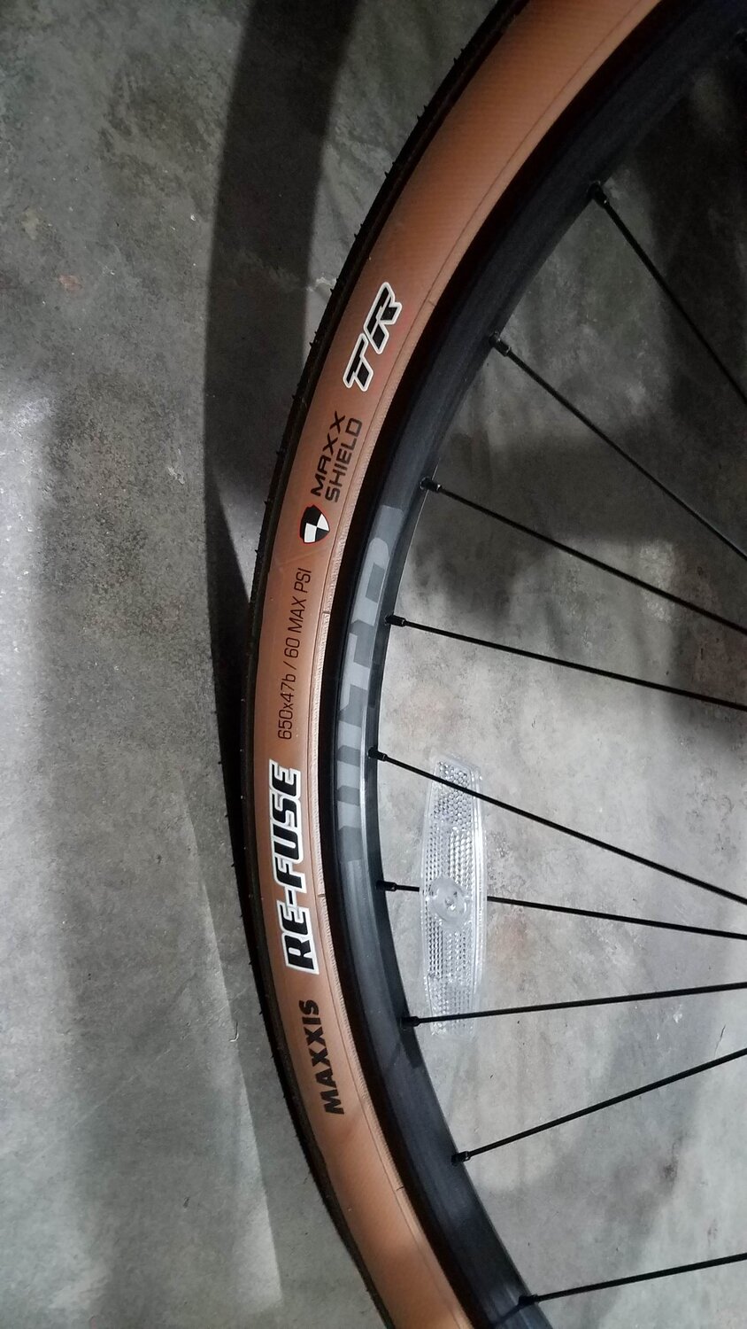

I've only ridden about 550 miles on my Kona Dew-E DL bike. It has Maxxis Re-fuse tires. I already got a flat - of course on the back tire. There was a glass sliver in it. I do a lot of city riding and glass etc. is not always avoidable. I probably only got flats every few years on my Surley with Schwabe Marathons.
So while these tires are listed as flat resistant I'm wondering how often I'll be having flats. Just a fluke or are these tires not that flat resistant. Anyone have these tires on their bike? Your experience?

Your Kona Dew-E has been designed around "gravel cycling" technology. The rims are WTB. The tires are gravel ones. Maxxis is a renowned tire manufacturer, and they advertise the Re-Fuse as puncture resistant. For any reason, Kona puts WTB Horizon Comp Puncture Protect 650bx47 tires on new Dew-E e-bikes now. Gravel tires are supple, lightweight, fast rotating, and with good traction in rough terrain but they are vulnerable to punctures. Honestly, any tire can get a puncture confronted with a glass shard.
Not a chance your rims are tubeless ready? Gravel cyclists often convert to tubeless because small punctures are in many cases blocked by the sealant.
If you wanted to replace your tyres with Marathon Plus: These tyres are not made in 650bx47 (ETRTO: 47-584) size. I might recommend Specialized Pathfinder Pro 650bx47 but these seem to be unavailable either...

Thanks Stefan. Yes, I believe these are tires designed for gravel. And, yes the rims are tubeless ready. I've been reading about tubeless tires but don't think I'm ready to convert. It sounds messy and fiddly to get set up and my thumbs are a bit arthritic. The people I ride with don't use tubeless tires so I wouldn't have that kind of help.
Yes, I recognize that any tire might go flat in the right set of circumstances. I'm not ready to give up on these tires but will collect a list of possible replacements if it turns out to be a recurrence. A flat every 500 miles would be a bummer.
The positives of gravel style tires are also evident in my rides. It is a sporty bike with an older lady riding it. Thanks for sharing your expertise.

Another issue with my Maxxis tires is that they don't do well in mud. I rode through a muddy spot the other day and slid into a wall. No harm to me or the bike but probably not something that would happen on my other bike with better tread. Reading reviews, these tires are rated down for muddy conditions.
So any suggestions on tires for 650 x 47b wheels? My priorities are puncture resistance and stability. Of course I'd love low rolling resistance but recognize there will be tradeoffs.
