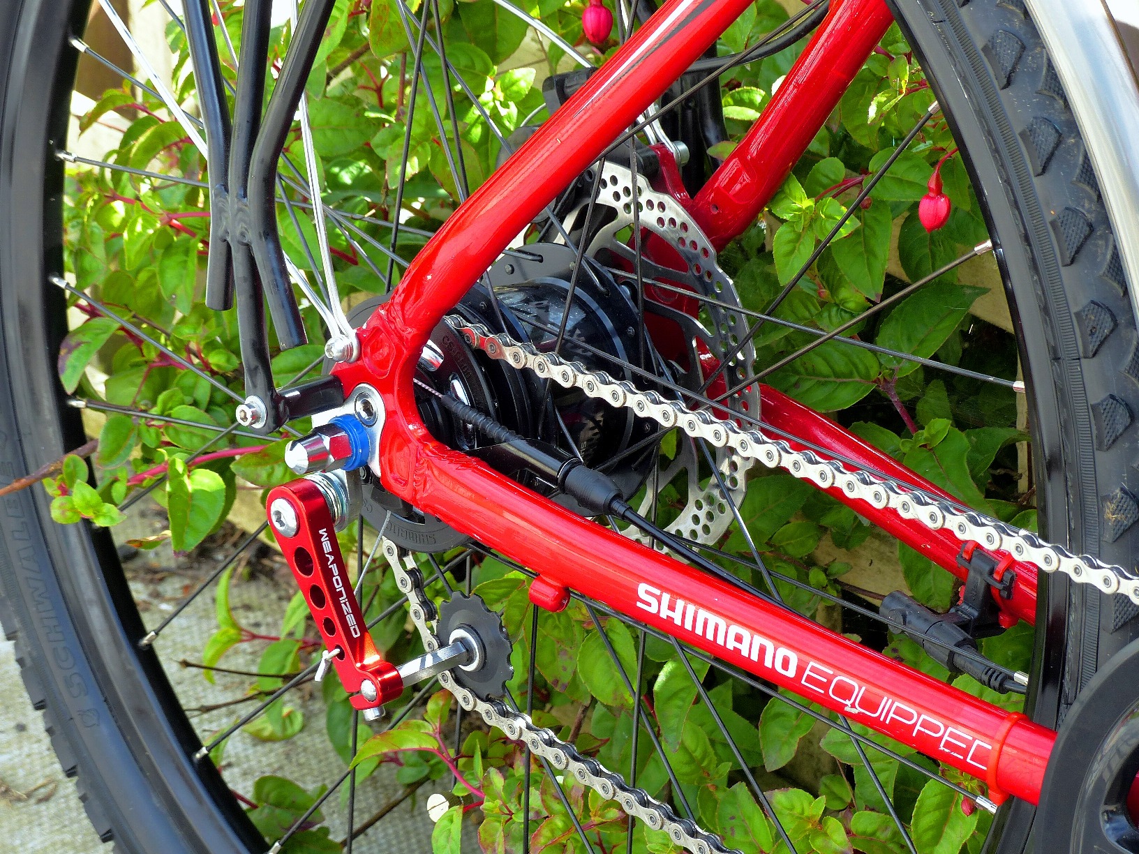

I ended up getting the 8 speed Alfine and now having a wide gear ratio and the ability to shift gears while stopped has completely changed the way I drive my e-bike. I now have now found myself getting a lot better fuel economy and riding around in a lower level of assist.
RoyL
<---Same here, Alfine 8 along with the BBS02 750w.
What cog have you on the Alfine? I`m presently on the 18T, have a 16T to try but not sure if i`ll loose climbing ability with it.
I`m on 26" wheels btw.
Tbh i find i`m changing two gears at a time with this setup, could do with only 4 or 5 i reckon

View attachment 16403 ^
I am running an 18T, sorry. That does look smooth. I will have to put a pic of mine up, now that I have it where I want it to be. And I only change 2 gears at a time when I am in a high level of assist (4 or 5 out of 5). But that could just be my personal riding style.
