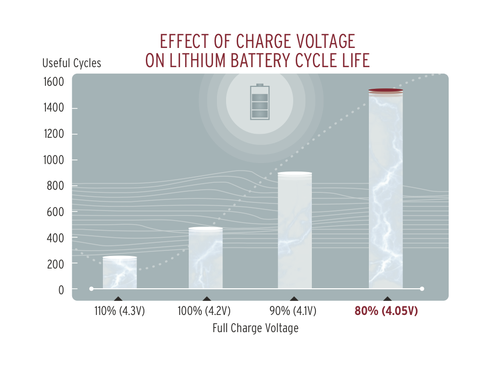

You don't need to do all the calculations... just remember 2 things when charging.
  1. Charge your battery to 80% if you are going riding in the next day or 2.
  2. Charge your battery to 100% if you are going riding the same day.
It's really simple to maximize the lifespan and effective range of your battery. ;)
