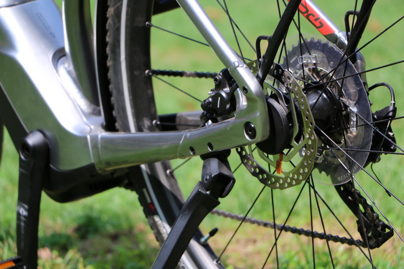

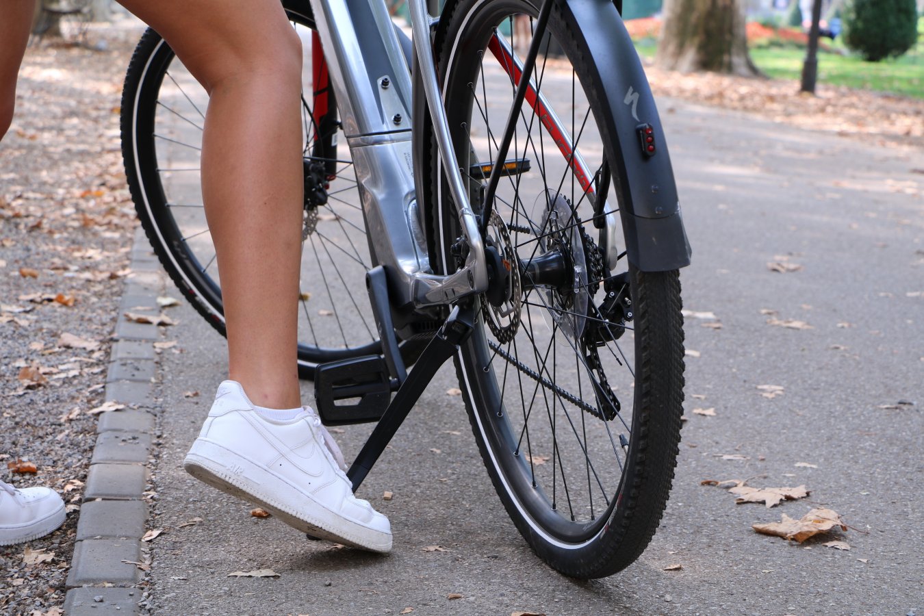

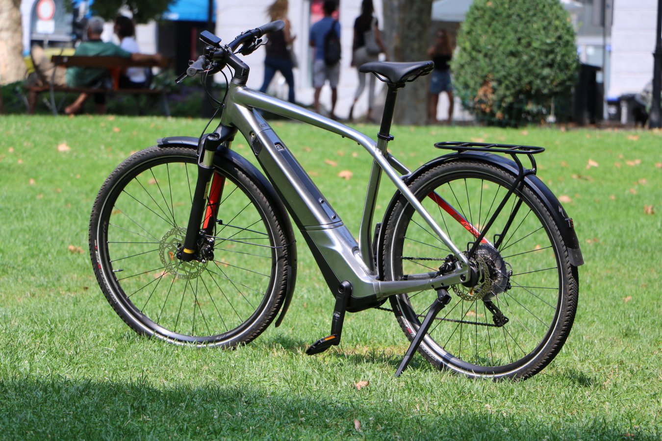

I was just searching online how to connect my Vado 4.0 to Mission Control (and subsequently to BLevo) for demonstration purposes of PLANET3 and found this thread. Lots of useful info and it seems TCD-W is the way to go for me, too!
However, during reading of the thread I see some users (@PaD , @coffeemaker) were asking about a possible speed limit solution for the Vado & Como and I just wanted to say that I might have something you guys could be interested in. More information is available at https://planet3.bike/ but since reading this forum for a bit, I see that speed and distance display might be playing a very important role for you guys and I wanted to clearly state that due to the way PLANET3 is designed to function - it will always display 3x lower speed and thus 3x lower mileage/distance than what is "real". To some, this might be a deal breaker, but for me personally, the 15.5 mph/25 km/h speed limit was a much bigger dealbreaker on an otherwise super bike. Also, for people who think a gear ratio of ~3 in the planetary gearset is too much (speed limit goes up by gear ratio factor), and they'd like their bike to count a bit more miles and show a bit more speed, the device is designed to operate with two planets also. This means the gear ratio is halved and is at ~1.5 which also means the speed limit is 25 * 1,561 = 39 km/h. However, I regularly run into this speed limit so I use mine with a single planet as it was intended and never worry about the speed limit since it's only "theoretical" at 78-87 km/h depending on the PLANET3 model.
The solution to this and why I wanted to connect the bike to the phone is in the BLevo app which I use on my 2019 Turbo Levo. Paolo, the developer of this app, implemented a feature called the "speed multiplier" which helps incorporate the mechanical de-restriction gear set to show the real speed and mileage even when using the rear wheel speed sensor for these readouts. You just enter the multiplier and voila. BLevo is also super-useful regarding setting the assistance modes of the bike as it can do so in 1% increments and many other things Mission Control can only dream of. If you haven't checked it out, please do a Google search for BLevo and switch over - I've completely stopped using Mission Control since finding BLevo.
If you've got any questions - don't hesitate to ask publicly here, via PM or via info[at]planet3.bike.
P.S. The PLANET3 is not compatible with Center Lock hubs by Shimano which come (depending on the region) on just two of the Como models. If you've got a 6-bolt Specialized hub featured on all other models, we've got you covered!
Some pics of the Vado equipped with a PLANET3 for your visual pleasure.. :p

The two-planet device is going to be a little extra (10 EUR) since you're getting a few more items: second planet with a magnet but also two more outer "positioning" magnets which are used to check if you correctly installed the planets in a 180° phase or if they moved/jumped slightly during the closing of the ring gear. I'd invite you to watch the YT Decoy installation instructions video here which shows the procedure I'm talking about.
The YT Decoy has to be delivered with two planets since the Shimano STEPS system has a limitation that I've had to get around by using a lower gear ratio (you can check the other videos on the YouTube channel for more detailed info and demonstration). However, every Specialized bike works flawlessly with a single planet version of the PLANET3. Yes, I'm aware that the speed limit is increased to 60 mph for Canada and US markets this way - but then again, this is of no consequence. It just means you'll never be able to hit the speed limit. If the bike had any problems at lower speeds, such as cutouts in power, too low of a cadence or speed for the sensor to even measure anything - I'd also be selling the two-planet version for the Specialized. But there are none of these problems and it just works perfectly. You become the speed limit. Your gear ratios (chainring sizes) and leg power are what determines how fast you're going to ride. Complicating things by having the default version be with two-planets just means there's more things to wear, wear rate increases two fold (even though this isn't really a consideration as the wear seems to stop after the initial few hundred km) and there's more chance to improperly assemble something. Basically, why would you want to have a "lower" speed limit? Even with a ratio of 1.5 you'd almost never hit it, but EU customers would hit it even during normal city riding (as I would've today in the demonstration video I recorded). I've had people ask me this same question multiple times now and even after I explain to them that PLANET3 does not give you an extra 5 kW at the rear wheel and that the speed limit becomes purely theoretical - they say back to me "But I just don't want to go that fast..." - without realizing that no one is forcing them to go any faster than they feel comfortable with. You just use a lower mode of assistance or stop pedaling or use the brakes. :)
So, to conclude my very long-winded explanation.. if you'd like 2 planets, it's going to cost extra because there's extra stuff. But your conclusion should be that there's no point in doing that and that you should just enjoy the one-planet version since multiplying something by 1.5 or by 3 comes down to the same amount of math.
Here's a little demonstration video I recorded yesterday on the 2018 Turbo Vado 3.0.
What I failed to mention is that the calculated range is going to continue to work, you just need to reset your distance counter after the PLANET3 is installed because the new distances are going to be 3x less and so will the range - but it's going to be proportional. If you've done 20 km of riding (meaning you've done 62 km of actual distance) and the range calculator says you can go another 7 km, it just means you can go another 22 km. Everything gets multiplied by the gear ratio of the device (3,12 or 3,35).
