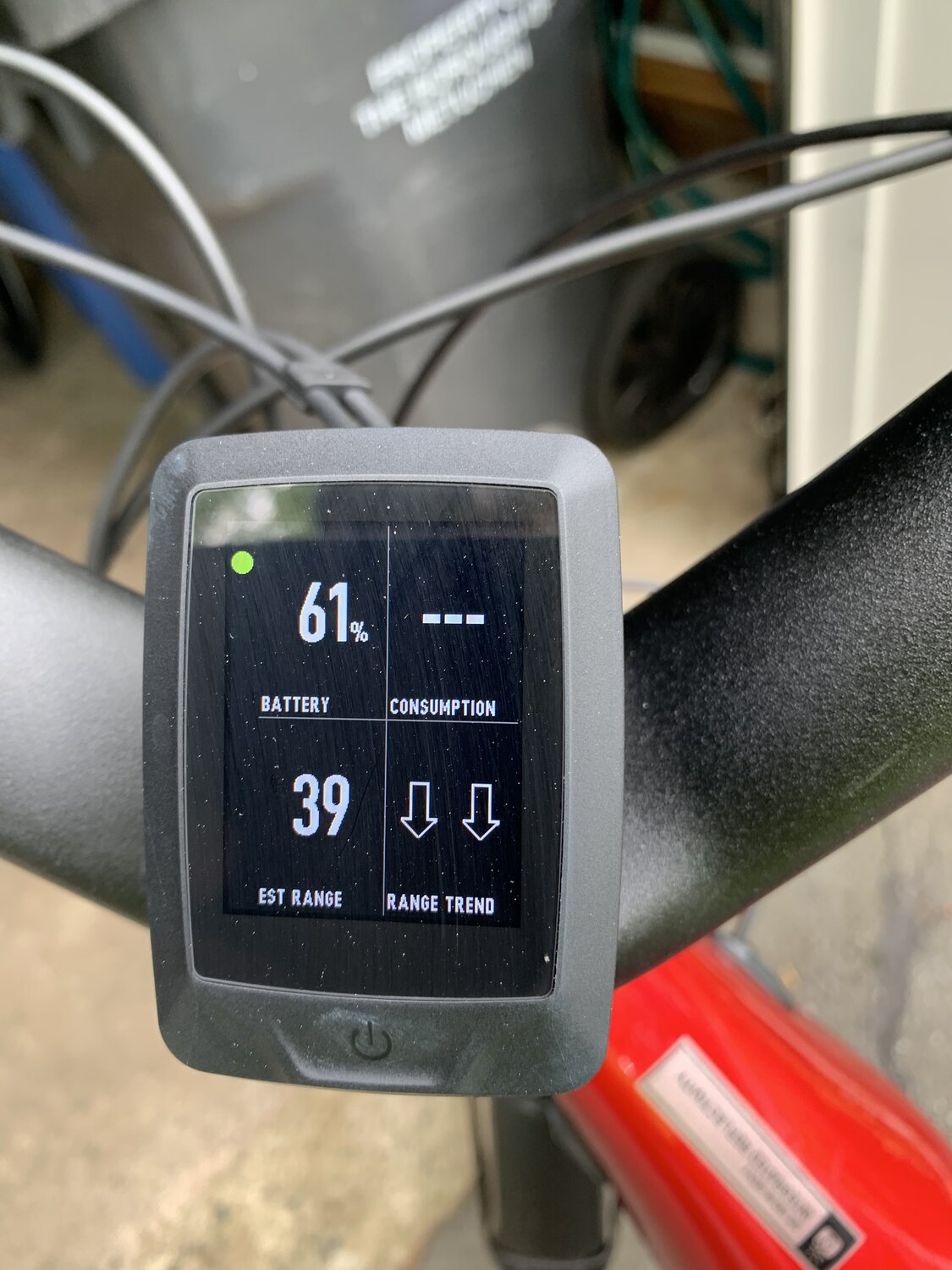

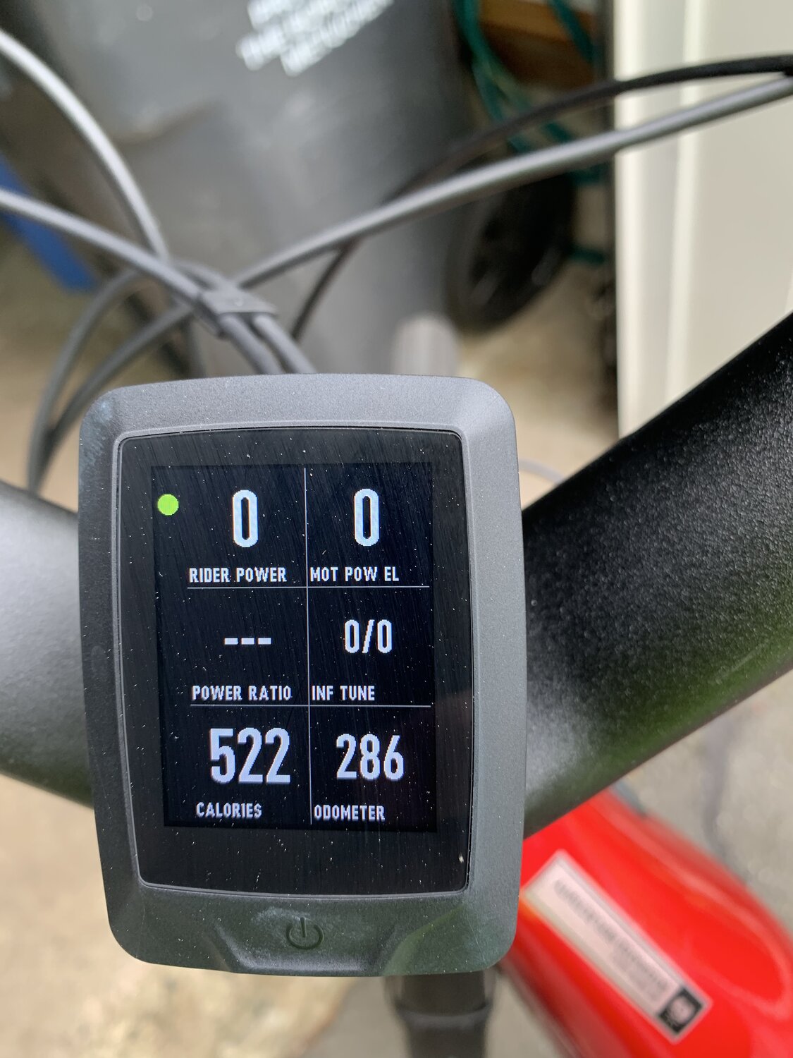

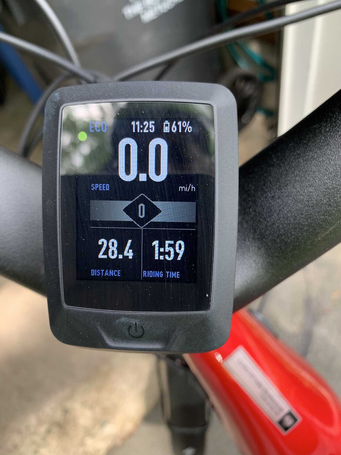

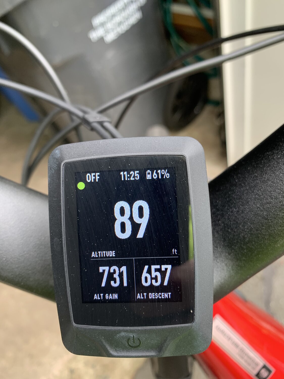

Upon starting out yesterday and turning on mission control on my iPhone, my day began as a normal ride.
However, upon returning almost 2 hours later I took my phone out of the trunk bag and it was in a state of “resume” (meaning press the resume to continue the recording of the ride, as it was paused, somehow, someway)…now whether the software auto-stops/resumes when I pause my ride (physically) for a minute or 2, such as at a red light or to chat with someone, regardless, I’ve not had the issue of the mission control stopping and not resuming.
You might want to say it’s an ant or Bluetooth or an apple issue, but nonetheless (it is not, as this type of issue has been non-existent), I took screenshots of the display unit on the handlebars to validate my claim/problem.
How do I get the stats that were on the display (at the end of the ride) to be equal to the incorrect mission control stats that were not complete at the end of the ride?
As the display shows, the ride was 1 hour and 59 minutes, the distance was 28.4 miles
The mission control app only shows 6 minutes, 1.3 miles.
How do I get the data to sync so I can keep my Strava data current?

ah, i see. i don’t believe there is any way to get the ride data from the TCD to strava other than also having logged the ride with mission control or another bike computer / cycling app.
mission control has an auto pause and auto resume feature. personally i prefer to start and stop manually. i also have my phone on the bars in lieu of a bike computer or TCD, so i would see right away if it disconnected. with your bike’s display, that would be pretty redundant unfortunately.
