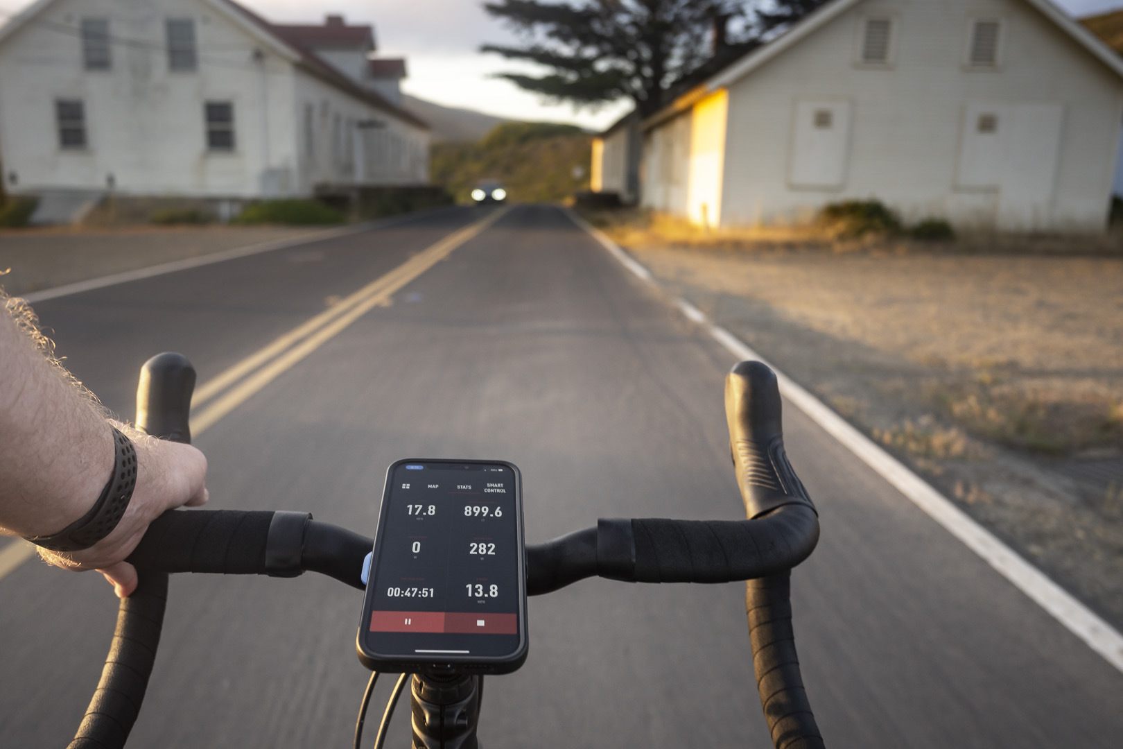

perfectly happy here with my iphone on a quad lock, no power bank, no blevo, no garmin, using mission control and one of any/many apps for mapping if the route isn't well known. no battery issues up to 6 or 7 hours of riding, at which point my internal biological battery is toast.
export to strava automatically on ride completion (don't use strava on the phone at all) and all the collected data, except motor power, but the stats reflect the accurate rider contribution.
