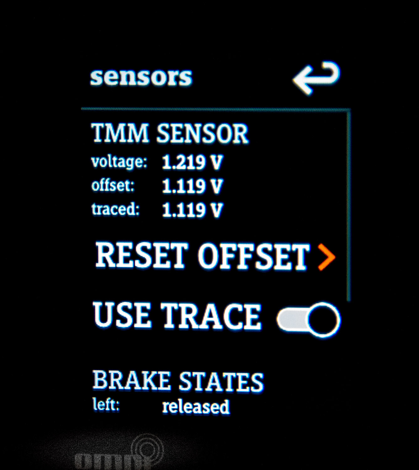

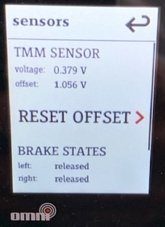

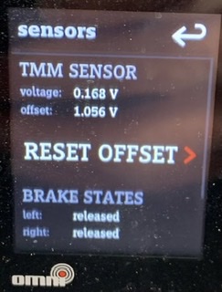

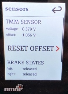

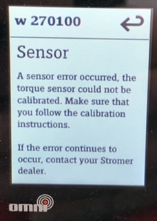

Yesterday, I encountered a similar, but different, issue. After the March issue, I have made a practice of calibrating the torque sensor before almost every ride. Here is what I saw when I did that before riding home from work last night:
I power cycled the Omni computer - no luck. I also found that I had no assist. I quickly pulled up EBR and found out how to get into the service menu and found this:
The first photo is with no load on the pedals while the second is with some weight. Clearly the sensor was changing based on torque, but the offset looked way off to me. And oddly enough, the “RESET OFFSET” menu item that you see wasn’t doing anything.
@Ravi Kempaiah suggested that I remove the rear axle and re-torque, but that didn’t solve the problem, either.
Out of options, I started to ride home. What a reminder not to gain 50 lbs!!
Before heading home, I emailed Stromer USA with the photos above (my bike shop mechanic had already left for the day).
About 13 miles later, the bike suddenly came alive - in other words, it “fixed itself”. The remaining 8 miles of ride were just like usual with full assist.

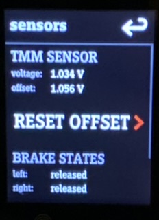

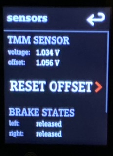

When I got home, I went into the service menu again and found this:
(Unloaded) Not only had the sensor output voltage increased by ~900mV, but now the RESET OFFSET button would clearly do something. I could tell that the offset would change to precisely match the sensor voltage when pressed - at least for a few hundreds of milliseconds before the voltage drifted 10 or 20 mV away (as can be seen in the photo).

I posted about a torque sensor issue I had back in early March here: https://electricbikereview.com/forums/threads/torque-sensor-question.41234/
View attachment 85402View attachment 85403

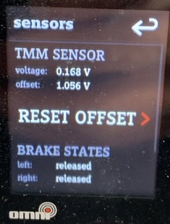

Hi ryeo - interesting. I rode my Stromer a few weeks ago and had issues with the torque sensor. These days, I know enough to go into the right secret menu to reset its zero voltage, but this is more than just a shifting output from a sensor. When working, the sensor output is around 1V unloaded. When not working, it drops to around 0.2V (with several tens of millivolts of variability) - as you can see in my early photos of this thread.

While this may be true - when the sensor output randomly jumps from around 1V no load to around 0.2V no load, that’s not sensitivity. That’s an issue.
One that neither I nor the Stromer tech support folks have been able to resolve.
My suspicion is bad sensor but given the way they are wired it isn’t (yet) worth the effort to swap it out.

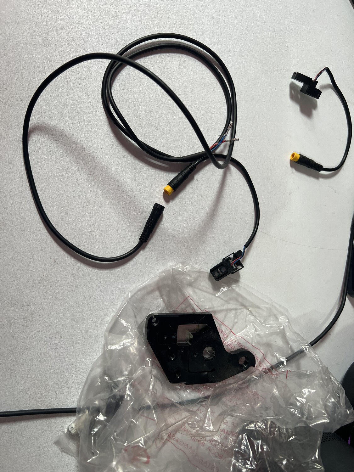

should be exactly like in the pic, and the end part( prob. inside the right chain stay like on my Bh, i'm not very familiar with the insides of Stromer ebikes) you could swap it from a new one ! I Did just that a few years back and issues was solved.
Could also change the whole TMM sensor plate and the end cable.
