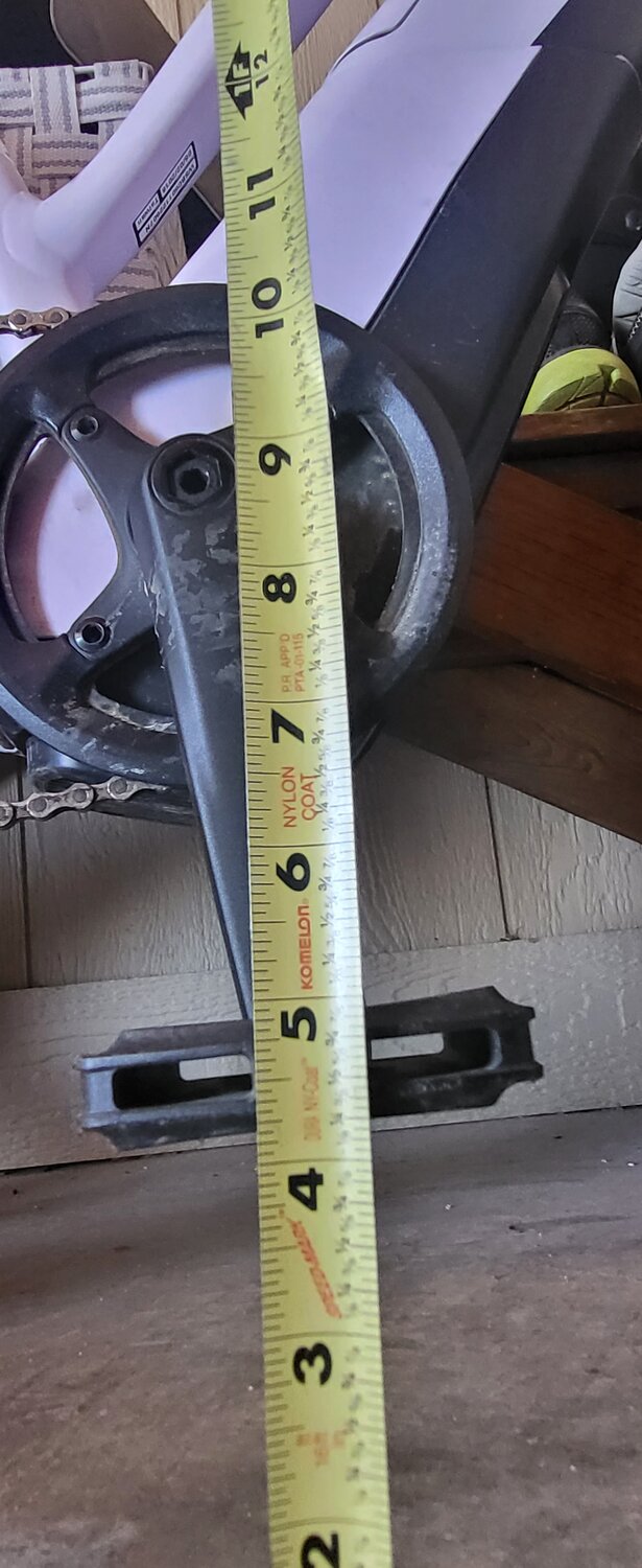

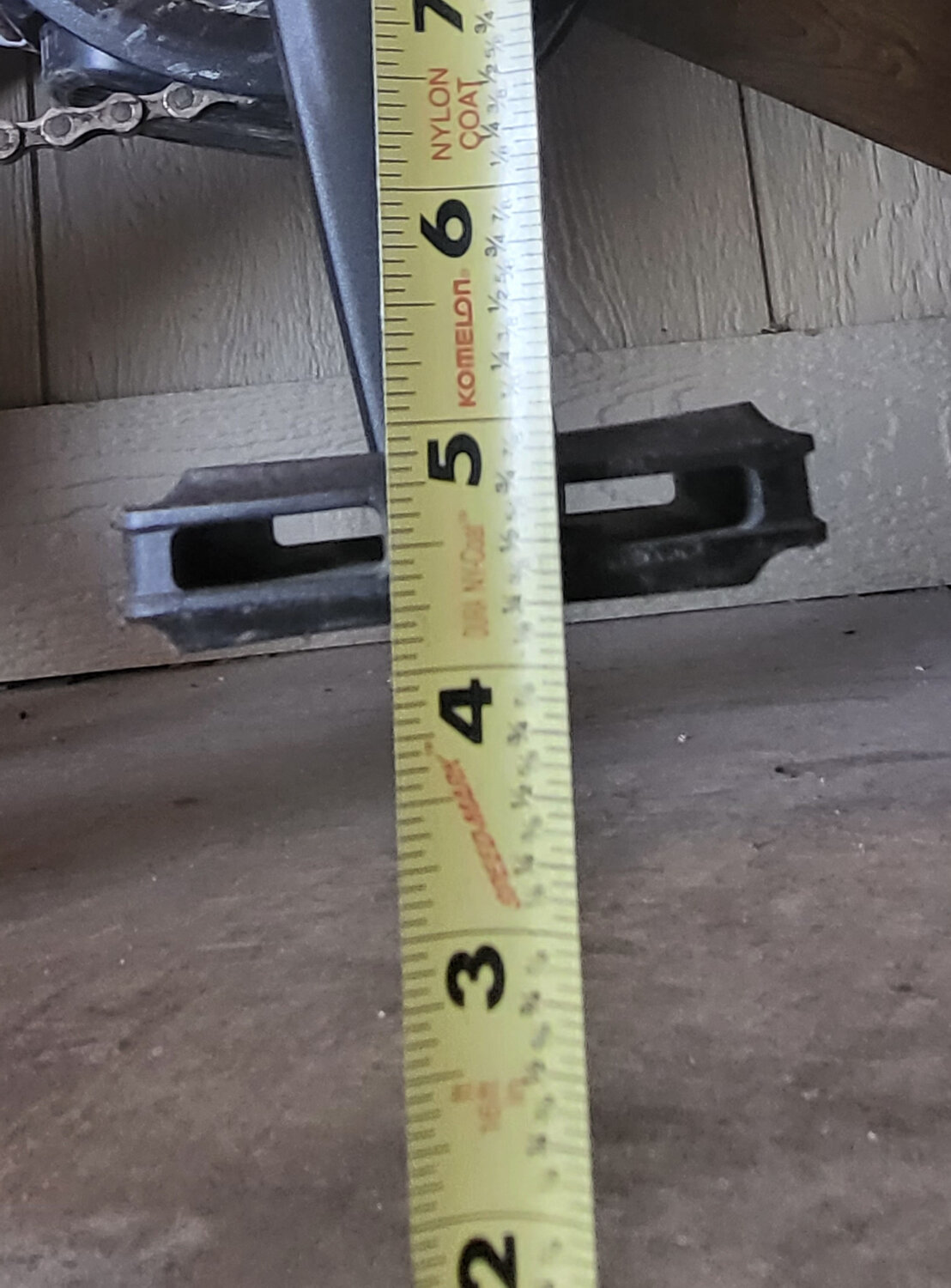

This is the pedal strike clearance on my wife's Como 3.0 Low Entry, Quite a difference.
