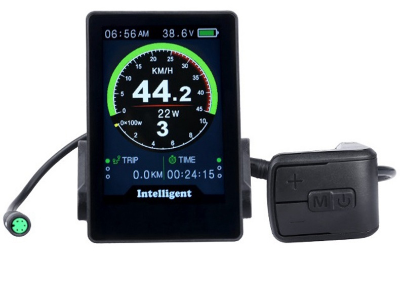

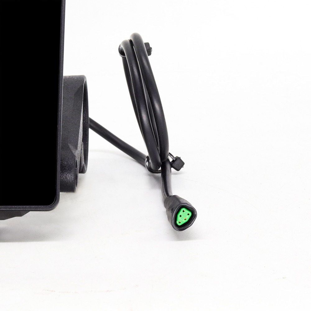

Gionnirocket
Y. O.
Unplug your display and check the display connection. It's either...
UART- ROUND in shape
CANBUS - PENTAGON in shape
If it's round (UART) you can change the PAS settings.
For example my PAS 1 cuts out at around 6mph in 1st gear and I have it set up that I input (exercise) pedaling in all PAS 1 thru 8.
I use 9 at 100% for the throttle.
