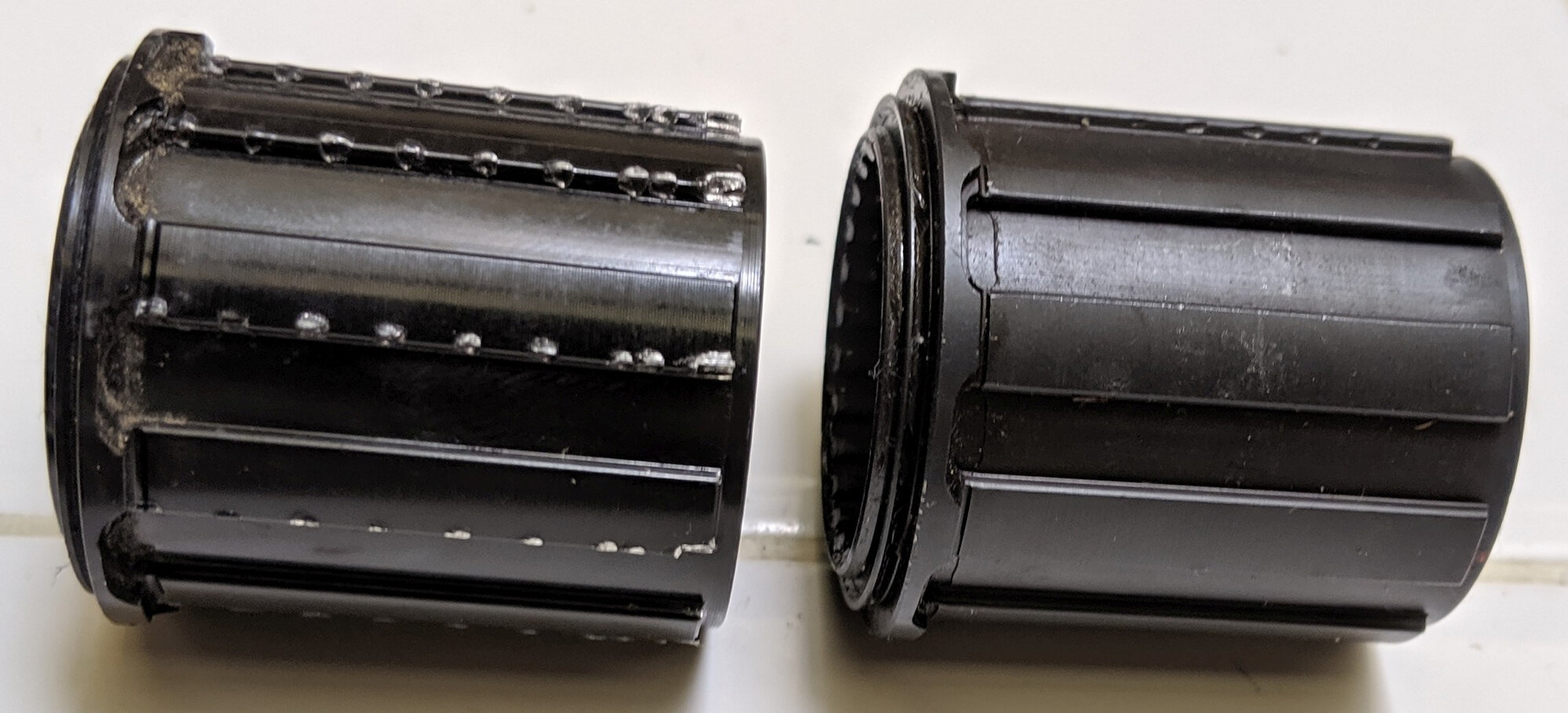

@linklemming I don't know how much you've worked with BBSHD drivetrains, but I don't see you talking about beefing it up. I typically build wheels with a mid-drive build and the back needs special attention thanks to the torque going thru the thing. The BC has 141mm rear spacing, which means Boost QR. My Envoy has that spacing - (the only reason I know what that weird size means). For that bike I used the DT 350 Hybrid hub, which is the only hub I know that is indestructible behind the BBSHD (Pushkar has noted the SunRingle hubs he uses on WW bikes are rated for more torque).
The issue is simple: 160 Nm. The solution is multi-layered. First, the rear cluster's individual cogs dig into the cassette body. Solve that with a 9 speed Shimano HG200 or HG400 as they are welded together steel, which distributes the delivered force across the entire cassette body. But the BC is 11 spd. My Surly BFD came already equipped with the best 11s option I could find: A Sunrace CSMS7 11-40T which is steel and 1-pc-ish thanks to it being bolted together. Also available in an 11-42T. Both are unicorns on the open market right now but keep an eye on ebay.
Underneath the cogs is the cassette body. As usual with a mid steel is real. Alloy cassette bodies are dug into as it is but with 1kw+ its really bad. A steel body under a 1-pc cluster solves this. the Salsa hubs my BFD's wheels came with are steel. Your BC's Novatecs... probably are steel. But underneath the steel body is the last weak spot: pawls. For obvious reasons a 3-pawl body is getting brutal treatment. Thats a common failure point on HD'd emtb hubs that see a lot of singletrack.
The best overall hub solution I have found - it ain't cheap - is the DT 350 Hybrid, which is meant for ebikes and tandems. Its beefier in every way on general principles, and uses a 24T ratchet engagement mech instead of pawls. The 18T on the standard 350's is indestructible as it is. The 24T ratchets on the Hybrids are also solid. Also the steel cassette body you ordinarily have to buy separately for a plain 350 is included with the hub from the factory.
I use a 350 Hybrid (Boost size with QR endcaps swapped in makes it a 141mm) on my Envoy's wheel build. I did not realize it came in a 36H version or I would have used that along with a 36H MTX39 rim. Instead mine uses 32H. IIRC I used DT 2.34 Champ spokes with brass nipples. that combo will take anything you throw at it with a BBSHD even if you just go standard 350 (my only choice, with a steel upgrade, on my fat bikes).
But an alloy cassette body will die for sure. Here's one of mine from a different bike after 1000 miles. Its a 2wd street bike so I was going easy on it, big time. A trail bike with just an HD would be more than double this amount of wear. Left is a DT ratchet alloy. On the right is steel, before it was installed. Several hundred miles later no difference in its look.
Good luck on your project!

No worries at all. Glad to help if I can. On the DIY groups you see soooo many disasters that could have been avoided by thoughtful builds, but instead the equipment gets the blame and mid drives have a rep for unreliability or shockingly fast drivetrain wear.
I literally just took this picture. This is from my 2wd Bullitt so the front motor is still giving the drivetrain an easier time than it would normally have. Its an 11spd CSMS7 cluster where I am mostly running on my smallest three cogs, the last two of which are slip-on and not a part of the bolted together remainder. This afternoon's chore was to replace the stock 18T ratchet with a 36T (I have a 24 Hybrid but I think this street bike can handle 36T, which is great for fast engagement) and to swap in the steel cassette body I was too forgetful to be bothered with when I built the bike.
After 496 total, relatively moderate street miles, you can see why I say stick to steel. And not only is this motor on easy street thanks to the helper motor up front, it also has had its settings toned down with my pedelec recipe.
There's no reason to be a'feared of mid drive wear. You just have to use your brain which I didn't, and as a designated cheerleader for right tools/right job... I totally knew better. So this puppy is going into a box and not on Ebay.
Also the last ingredient to the mid drive drivetrain puzzle is a KMC e11 chain. Stressed for mid drives. Buy two because you have to have one as a spare in your tool bag along with chain pliers and a couple of master links. Just as important as a pump and patch kit if you have a hi-po mid kit on the bike. You want the kind with the solid side plates, not the lightened one. The price will make you queasy but this is what you pay to be one of the cool kids with an 11-speed. :D
