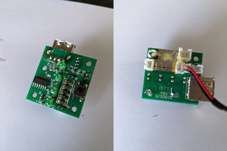

I have owned my NCM Moscow Plus for over 3 years and have put about 1800 miles on it. It is a great bike for the price.
Recently I got caught in a big rain storm and the water damaged the top board on the battery. The battery itself is fine and still produces 53 volts. The top board has the momentary power button and USB.
I have contacted just about everyone on Earth trying to get a new board but no luck. Jenny from Aijiu was helpful but will only send me a replacement board if I buy a battery from her. I understand the business part of that transaction but the battery I have is fully functional and this can't be more than a $10 part. Leon Cycles only deals with complete batteries (of which they cannot get any of right now). I have attached photo of the part. It's difficult to see in the pics but the FETs are burned up.

I have busted out the multimeter and I am trying to determine the function of the board. I think it only acts as button for a relay on the BMS and also has the USB and power level indicator lights on it which are tied to the MOSFETs that burned out. If all this is the case, I can bypass with a good momentary switch. We will see and I will keep ya'll posted.

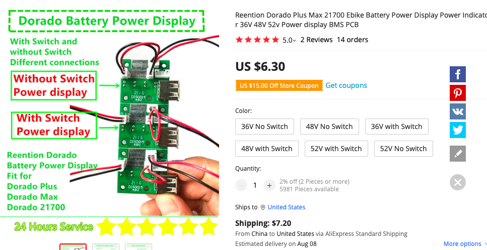

You should be able to find them on Aliexpress.
Cliff Cq
Wow, I feel like an idiot.. haha! I've been looking everywhere for that. For some reason I didn't see that link. Thank you!!!

I had the exact problem drove in rain. Last year the 4 battery charge indicator lights went out. Then yesterday it rained and battery wouldn't turn on. Took it apart and had the same burning issue on top board. Is that also the BMS board or is the BMS board the bigger board that is lower? Anyway it's a poor design to let water through like that

Hi Guys, I actually had the same problem and ordered the part from those guys in China on Aliexpress. It was a pain creating an account with Aliexpress but I finally did. The merchant in China was very helpful. A little awkward translation due to google translate. But we got to communicate ok. I received the part in less than two weeks for about U$14 to NYC. Installed it and fixed my battery. It’s a shame no one in the US is selling this part.
