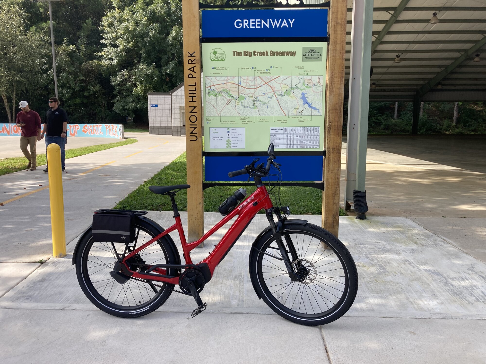

Picked the bike up yesterday, I did a 21 mile round trip,beautiful day here in NE Georgia for a ride,80 degrees, rode in eco 10/35, had to use sport a couple times. The shifting seems to be ok, will take some time to get used to ( I’m going to give it more than one ride). I briefly went on the road to test the speed, I hit 28.2 easily, I’m not normally watching cadence this is the first bike with that feature, but the cadence was comfortable, maybe high 80’s or low 90’s. I changed the crank arms to 160mm…. Loving this bike

Congratulations on the new whip! I've got ~120 miles on my now, and loving every minute. The auto transmission is a dream for commuting. Be sure to adjust your desired cadence as you see fit. I change mine depending on how I am feeling. If I'm just cruising the neighborhood and/or warming up the leg, I am most comfortable in "slow". If I've got somewhere to be "Standard" or "fast" seem to keep the cadence up and the motor most happy. Enjoy the ride!

Try taking your next ride in Micro Tune. IMO, it is so much better and tuneable to th amount of pedal assist that you need. I also use half as much battery now than I did using Eco-Sport-Turbo

Yes, I did use micro tune, a great feature. I rode most of the trail In eco 10/35, on my priority current I use 0 assist for most of this trail with a occasional 1, I figure the Vado is about 4 lbs heavier than the current,which is great considering the upgrades, maybe the wider tires?
