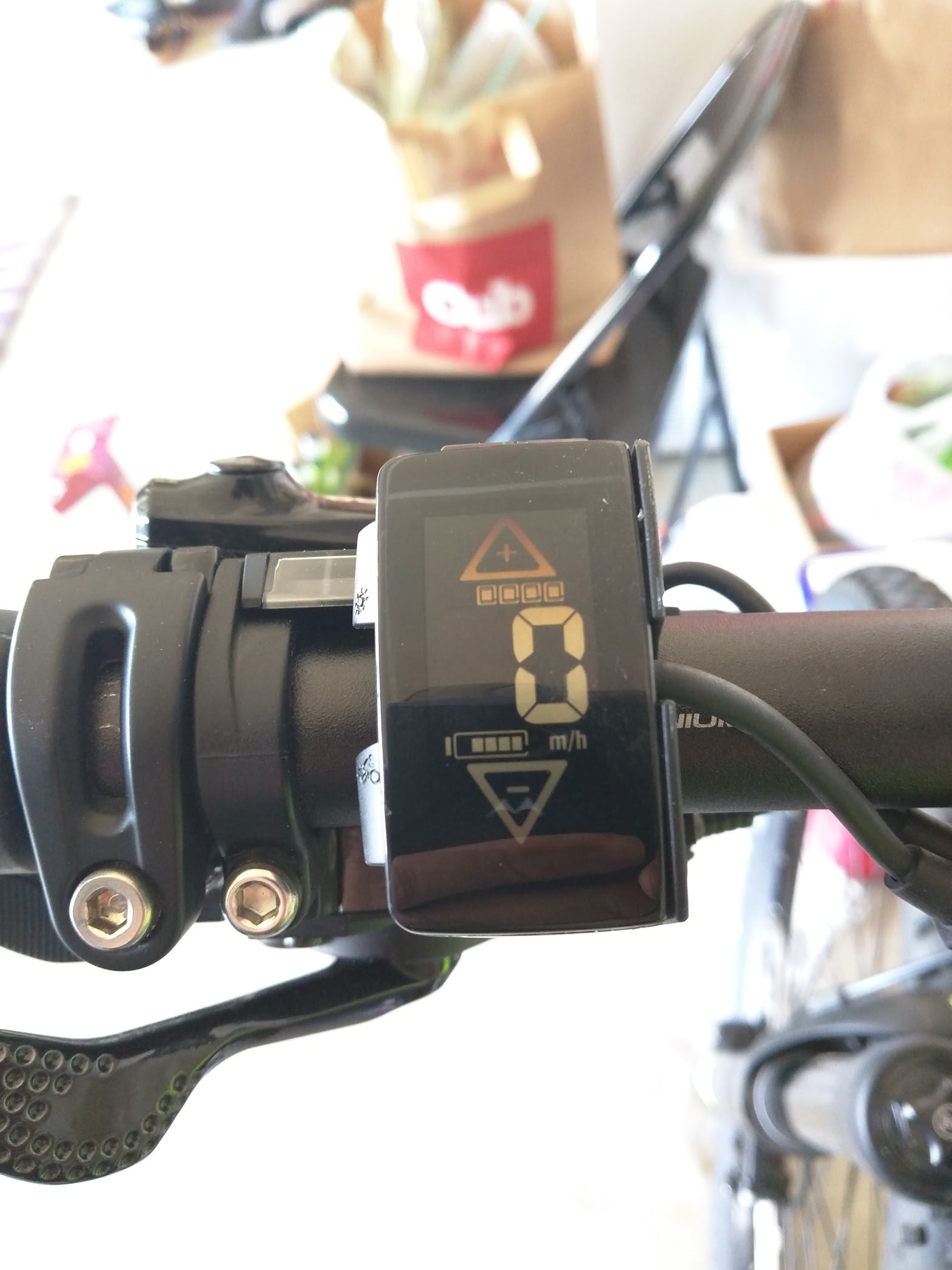

Went out for a ride today with a friend - I loaned him my Bulls FS3 27.5 while I rode my new easy motion 27.5 plus pro. Being the owner of the bike, and having read the manual like a good owner, I know there are 3 levels of assist. I'd never click up again if I knew I were in level 3! Here it is in black and white:
Well, my friend clicked up by mistake. I'll have to buy him a beer:
Yes, that there is a 100% verified 4th bar level, complete with the corresponding power increase!
Has anyone else made this discovery? @Ravi Kempaiah did you know about this one yet?
It is definitely more powerful, as noticeable as going from level 2 to 3, I'd say probably 30-40% increase over the previous max level 3 or 20-30% more than the current level 3 which I felt was improved with the firmware already.

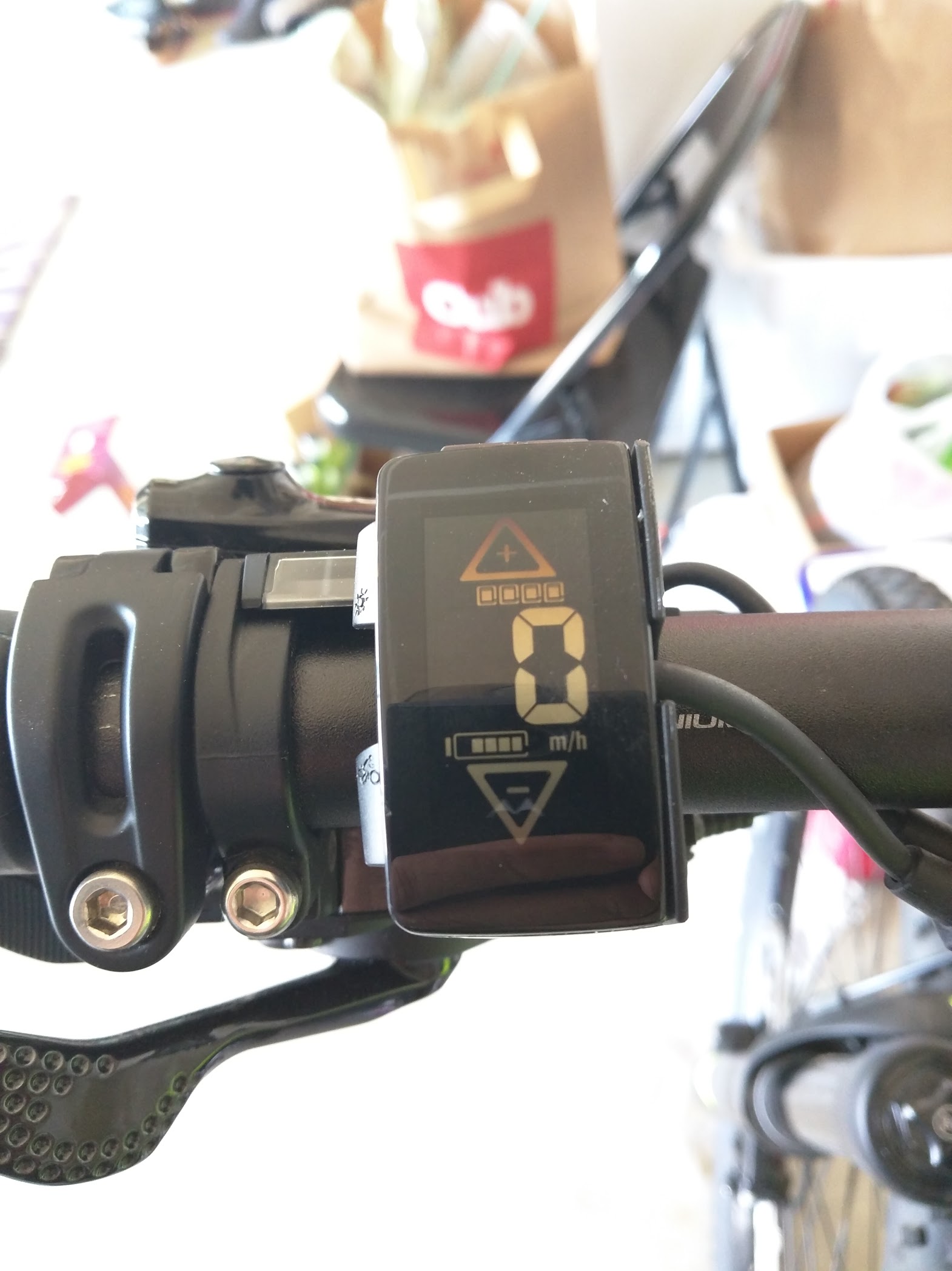

Yes, a firmware update for Bulls Brose eBikes came out a few weeks ago and has made a huge difference. Dealers can now control the amount of assistance at each level, which is great if you aren't happy with the default levels. There were a few other updates as well, but adding the 4th level was the biggest and makes a big difference. Bulls probably hasn't had a chance to update their website or documentation yet (and I better check to see if we have!)

Yes. It's very nifty addition to the system. Having more gradation in the assist levels make it easier to pick the right amount of assist.
As Kelly mentioned, if you want more torque off the line, that can also be set via the Diagnostic portal. You can play with the setting and really dial it for your purpose (commute Vs MTB'ing).
I don't have much saddle time on the Brose system with updated software but I do notice it's positive addition for sure :)

Ravi - To the best of your knowledge does this update actually increase the available power or just redistributes the power among the four levels of assist? Just curious if the fourth level is an actual boost compared to previous performance, that is it doesn't incrementally cut back on power delivery of the lower levels.

Unless the motor armature is changed, it's not possible to boost the power output of a motor for a set voltage. There are some tricks though.
What this update does is, up the operating efficiency of the Brose motor by roughly 3-4%. Also, the way motor responds has been changed via the firmware and as a result, it feels a tad zippy. It's minor though.
So, in short, the maximum power output remains constant but the 4th level does unlock some reserved power from the system.
