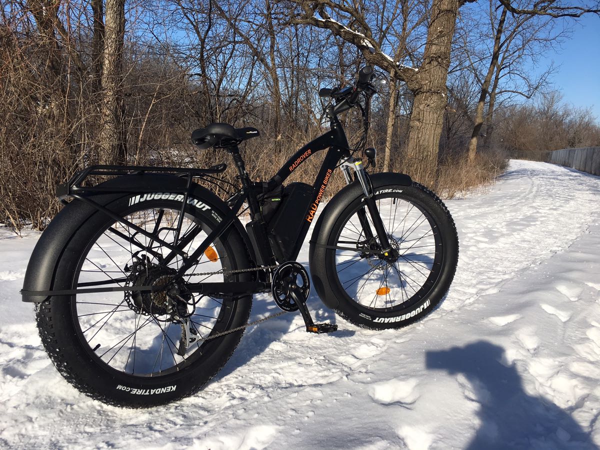

Are those the Radrover fenders? I have the other plastic fenders offered by RR and really didn't like them. I'm assuming the fenders would still fit if you have a rear rack?

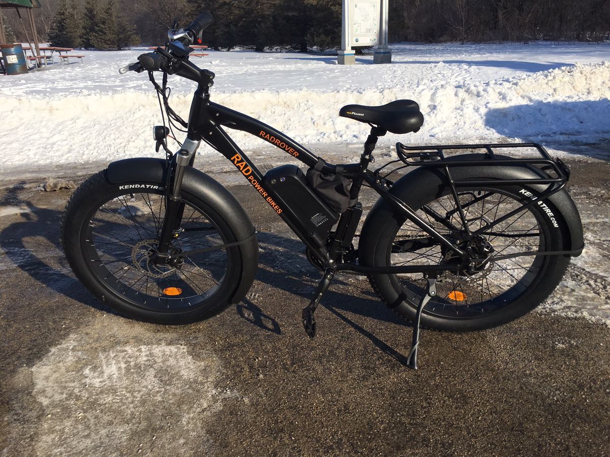

Did you have issues with how the rear fender was positioned? my fender was slightly skewed to the left I looked at from the rear - I had to move the right arm up from the bottom bash guard screw to the top one to balance it
No...It came out straight.guess I got lucky

I installed mine yesterday. They fit fine under the RadRover rack. Haven't tried them yet in the snow, but planning to this weekend. the front fender comes down pretty low, obnly about 5 inches or so from the ground. I might have to trim it shorter for trail riding.
joyride
My rear fender was skewed to the right, but then I realized I forgot to add the silver spacer on the left side. I added that and it ended up positioning the fender perfectly.

I was able to test mine out earlier this week in a few inches of slush and snow, and they work ridiculously well. Normally the underside of the bottom bracket and derailleur would be caked in snow, but the whole bike was pretty much spotless by the time I got home.
