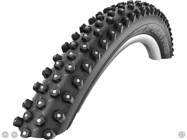

However, offshore at Chain Reaction Cycles who I think are one of the larger on line retailers, they did have some that should work (but still MTB).
Link to suitable tires They are Schwalbe Ice Spiker Pro Evolution - which are very similar to what I bought and only slightly different to the ones at BikeBros.
I've purchased from them before and their pricing is rather good - even with shipping and handling.
If you're capable of doing the tire changes yourself, it's an option. I would recommend using their premium delivery option that covers all duties etc... that's IF you decide to try them out.

Well that was a deep dive! You guys really know your stuff! I had a stroke of luck while consulting and trying to get very intricate with fitting. Pure Cycle just got a tire order today and my bike is currently at the shop getting the Schwalbe Ice Spiker Pro's put on. When it came down to it, superior traction was by far the most important to me. They have this splashboard fender https://www.blackburndesign.com/p/splashboard-fender-combo/ that I will put on for winter, and if I want full fenders for the summer tires I can put them on then. I'll try it, I'll learn, hopefully it works great, and if not it wasn't a big investment. Best part is, I can now safely get out using my new bike...

Pure Cycle is one that I am not familiar with. Regardless, those tires are amazing for traction. I was up on Nose Hill again today, and was firmly attached to the surface!

Nice to know that you were able to find a local source for the Ice Spikers. I made a one-time-only bike purchase at the Bow Trail location (Calgary Cycle Pure?) and found the staff there to be quite helpful and friendly. Congrats on taking early delivery of your Norco and enjoy those new tires.

If this is your first time riding in winter conditions I would definitely recommend a slow and cautious approach which, in all likelyhood, seems to be your plan. One also needs to be mindful of not changing directions too suddenly and to expect longer braking distances. I don’t ride an e-bike during the wintry season so others such as @RandallS and @Stefan Mikes might also be able to provide you with valuable input on issues such as prolonging battery life and riding an e-bike in colder conditions. You should also be prepared to bed the studs which means riding pavement on your first outing for 10-20k to ensure that the studs are properly seated.
There are studded tires that have deeper lugs than others which help to channel snow out from the tread but like everything else they have their limitations. I tend to stay away from the deep stuff myself simply because my narrower tires would get bogged down easily and since I’m self powered I wouldn’t have sufficient torque to extricate my standard bike. An e-bike with wider studded tires along with that additional boost in power could give you an upper hand depending on the snow depth. If there is something for the studs to grip onto beneath the snow then you would be fine. If not, then you might just end up spinning your wheels and sinking. A fat tire bike would typically be better off in these type of conditions as the tires are wide enough to float on top of the snow.
In a perfect world you would want to be riding your narrower studded tires on hardpack/icier trails where the snow has been compacted over time by foot traffic or other cyclists and where the studs would have plenty of bite. Red Deer is almost always a few degrees colder so we rarely see our paths/trails turn to dry pavement which creates less wear and loss of studs. You also stand a better chance to lose studs on rocky trails. Studded tires also tend to be less efficient because they create more rolling resistance since they are heavier and run at lower tire pressures which ultimately means greater contact with the ground which slows you down. It's a bit of a compromise and might require some testing of your own tires at various pressures to see what works best for your needs.
With that said, running studded tires at lower pressures offers the advantage of better and more surface to stud contact and increased traction. Just be sure to check your tire pressure regularly.
