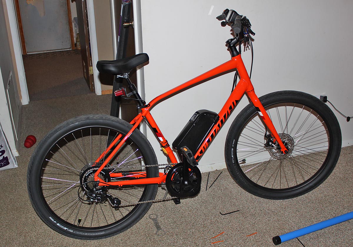

The battery is a 48 volt 11.2 ah that ships with a Rad Power Rover. I bought a new mounting rack that matches the battery. It gives me a 40 mile range. I used a 750 display, the controller is integral to the bbs02. I went with the lever type throttle so I did not have to change grips. I hardly use it. Its downfall is bumping it unintentionally when not moving.

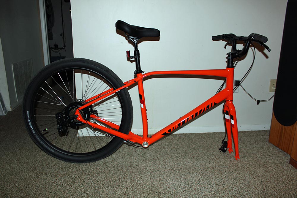

You will be removing the front derailleur and the shifter. If you want electric cutouts, the kit comes with new brake levers that have the switches built in, making the Roll with mechanical disc brakes a better choice. You will only be using the left/front brake for a cutout however, the right brake has the shifter built into it. I swapped out the front mechanical for a hydraulic unit, and added my own cutout switch. For the rear, I used a Spyke caliper, and it is at least as good as the hydraulic unit, HIGHLY recommended.
Anyway, removing the front derailleur and associated shifter is fairly trivial, so buy the one that fits your option list and price point.

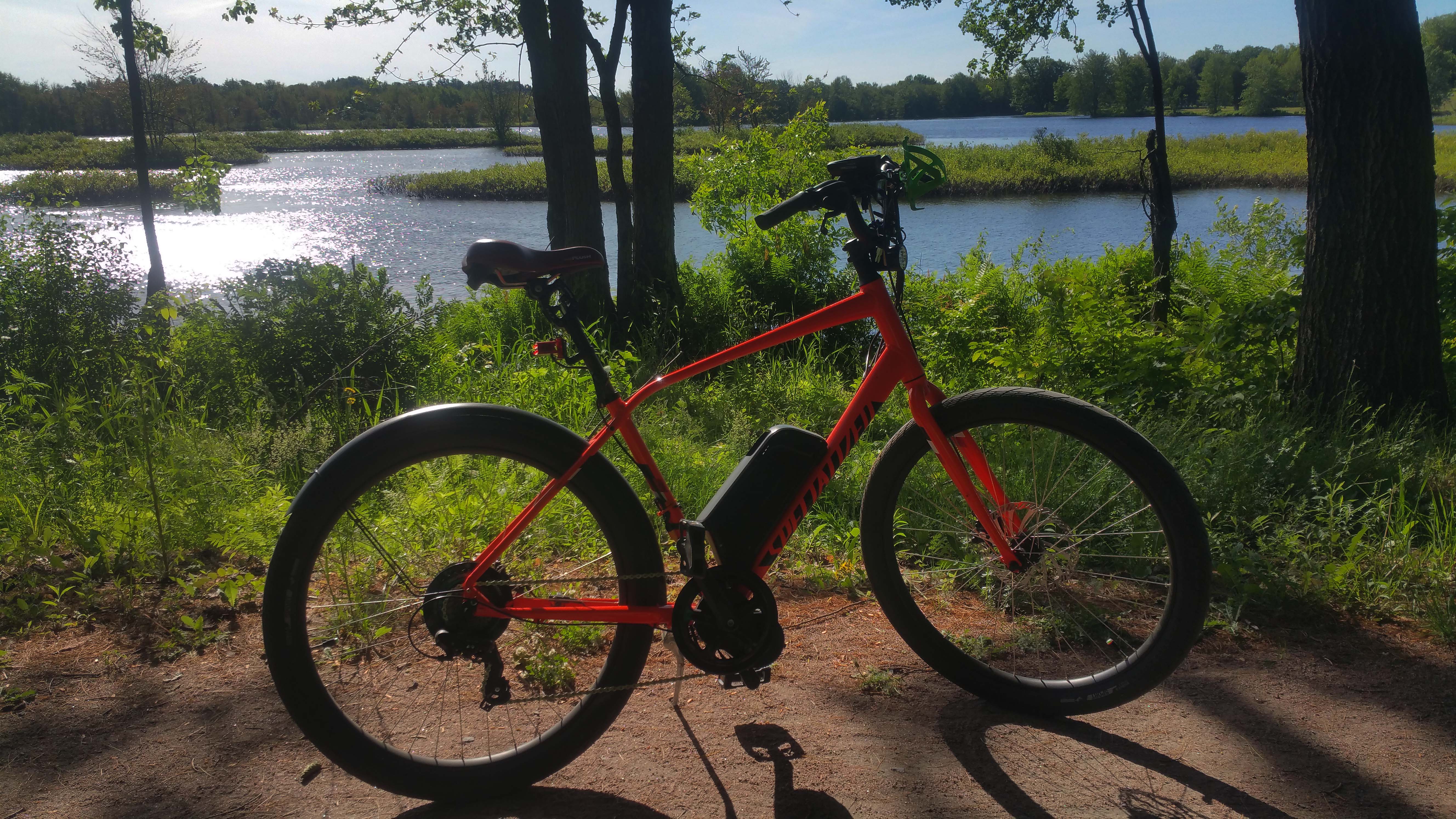

Pretty dang happy with the final product!
All in for about $1500 if I had to buy everything again. 48 volt dolphin pack, and the new full color display/ BBSO2 from Luna.
View attachment 16808 View attachment 16809

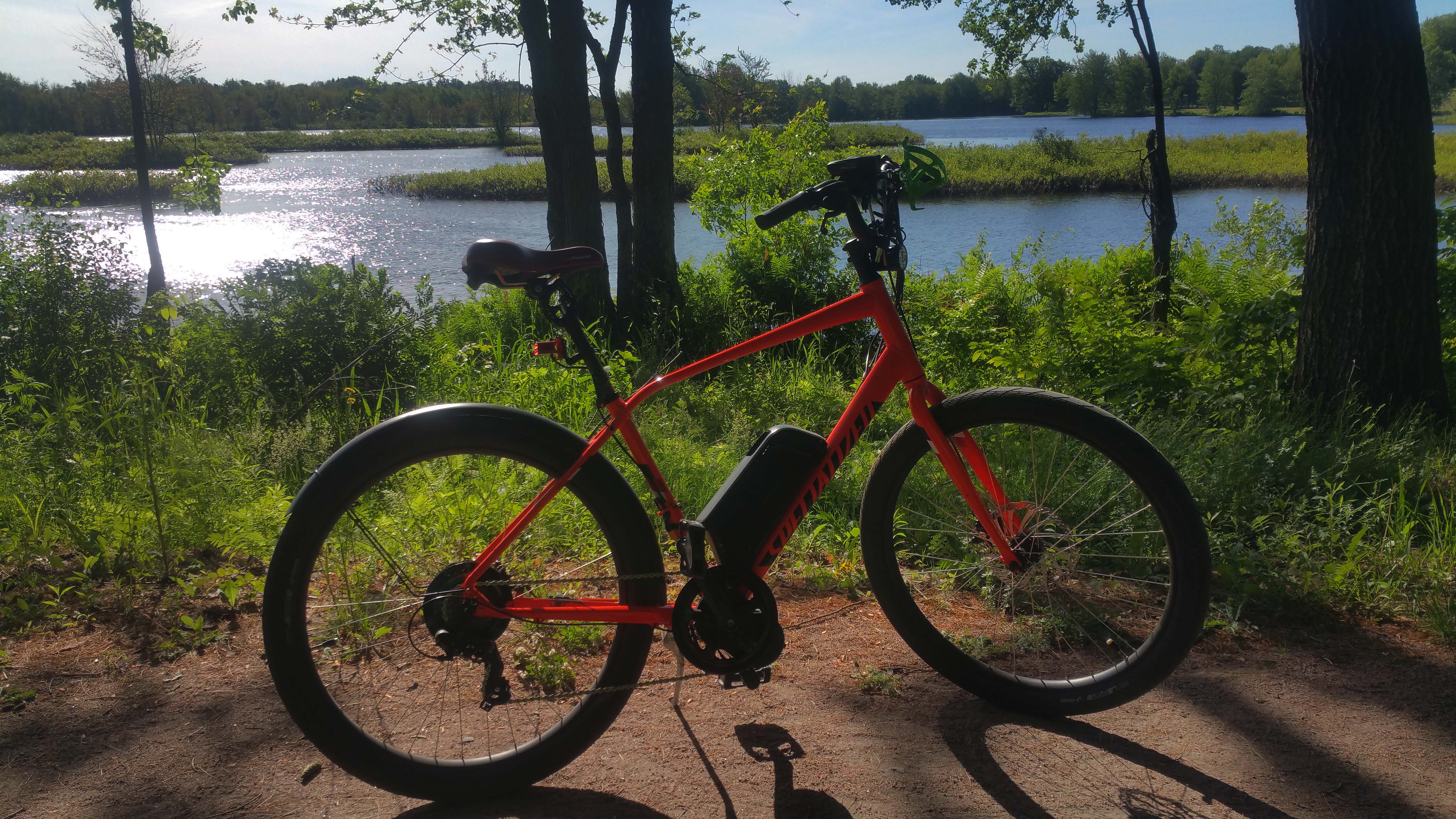

View attachment 17083 Added fenders, and a stem extender to raise the handlebars, and an axiom rack since this picture. Now have over 300 miles on it, and am totally loving this thing. Perfect ebike for me so far. So far about 15 to 20% more efficient than the Rover, which I hope to sell now.
